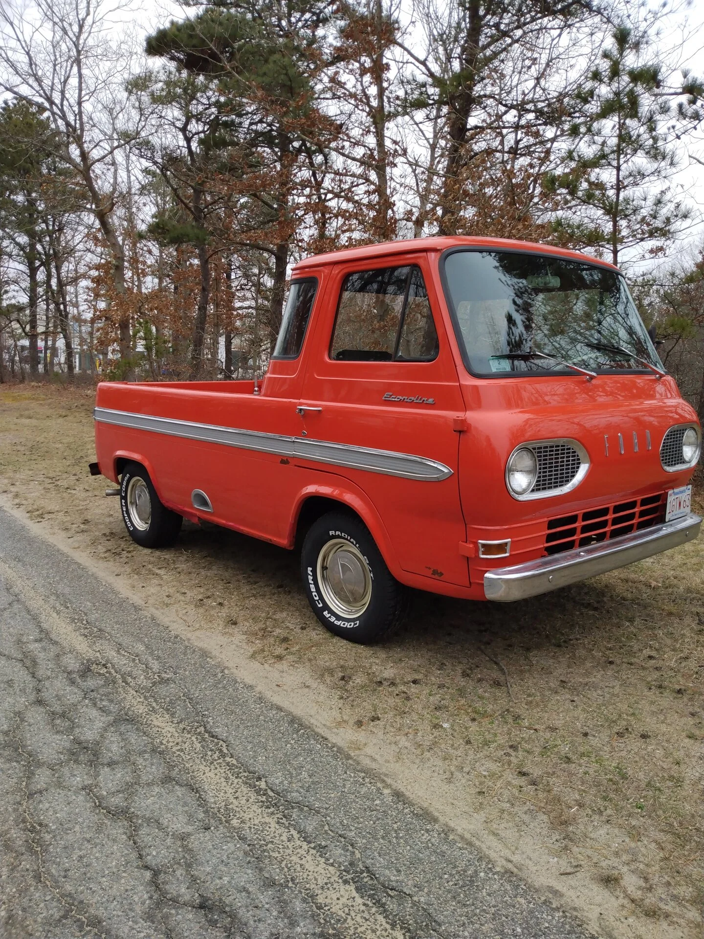

Gentlemen, I'm old but not senile yet, I bought a new toy that has little to no support on the internet, and since it's almost a Mustang I thought I'd come here for help. I bought a '65 E100 with a 170 and a 3 on the tree. I'm not used to having no power, and my normal solution is generally throw a big block at it, however I thought I'd play with this one a bit. I happen to have a rebuilt 200 that I was going to drop in it with a few minor mods, and I was looking for a better transmission than the 3 speed and came up with the RUD. It has a lower first gear than the 3 speed as well as a much needed OD for this poor little 6. Does anyone happen to have a RUD they are not using that I might purchase preferably in New England?? Doesn't it kinda look like a Stang??

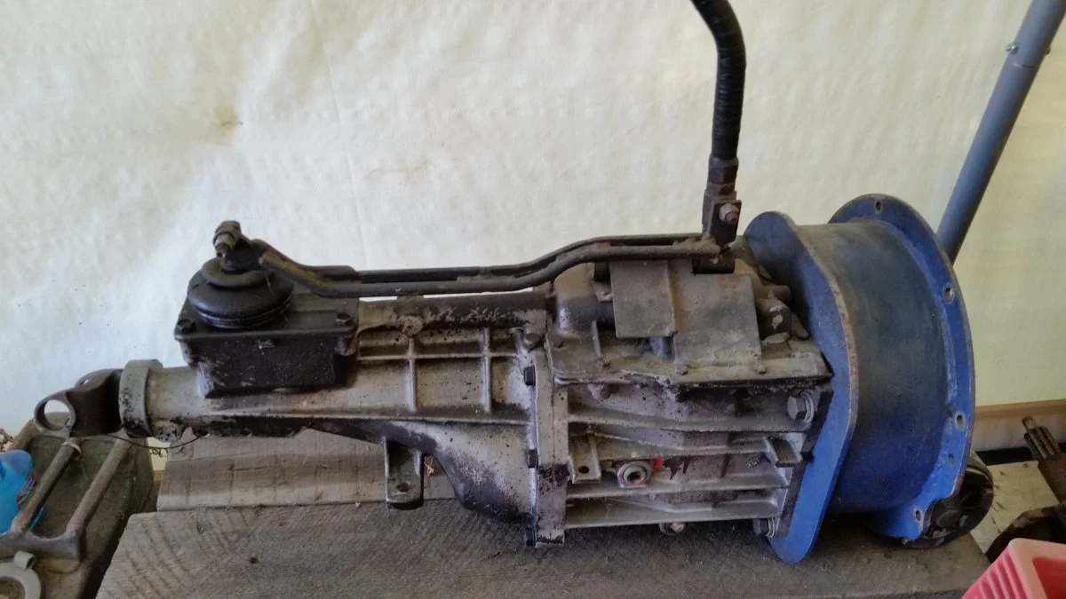

I am not familiar with the RUD....but if its like the SMOD and SROD(3 speed + overdrive) they aren't any stronger than the 3 speed. You would be better served running the T5...you can get them cheaply from later Mustang v6s...just be aware the input shaft is about 3/4" longer for the v6 version if I remember correctly(might be 5/8") which means you need to add a spacer place between the bellhousing and the trans to make up for the extra length(T5s are easy to make a spacer plate for as long as you have a set of transfer punches and the correct size hole saw and some aluminum plate to work with). Your biggest hurdle would be the shifter setup, you would need to do something like this:

That shifter is not an option, the engine is behind the seat, I need to go with a remote shifter and I wanted to keep the column shifter anyway.

Have you figured out how to put 5 on the tree for a T-5? :D I agree the extra gear from even an SROD would help modernize an Econoline. But with the engine on the middle, front seat location, a modern trans’ shifter is going to be awkward at the best.
Is the RUD compatible with a column shifter?
