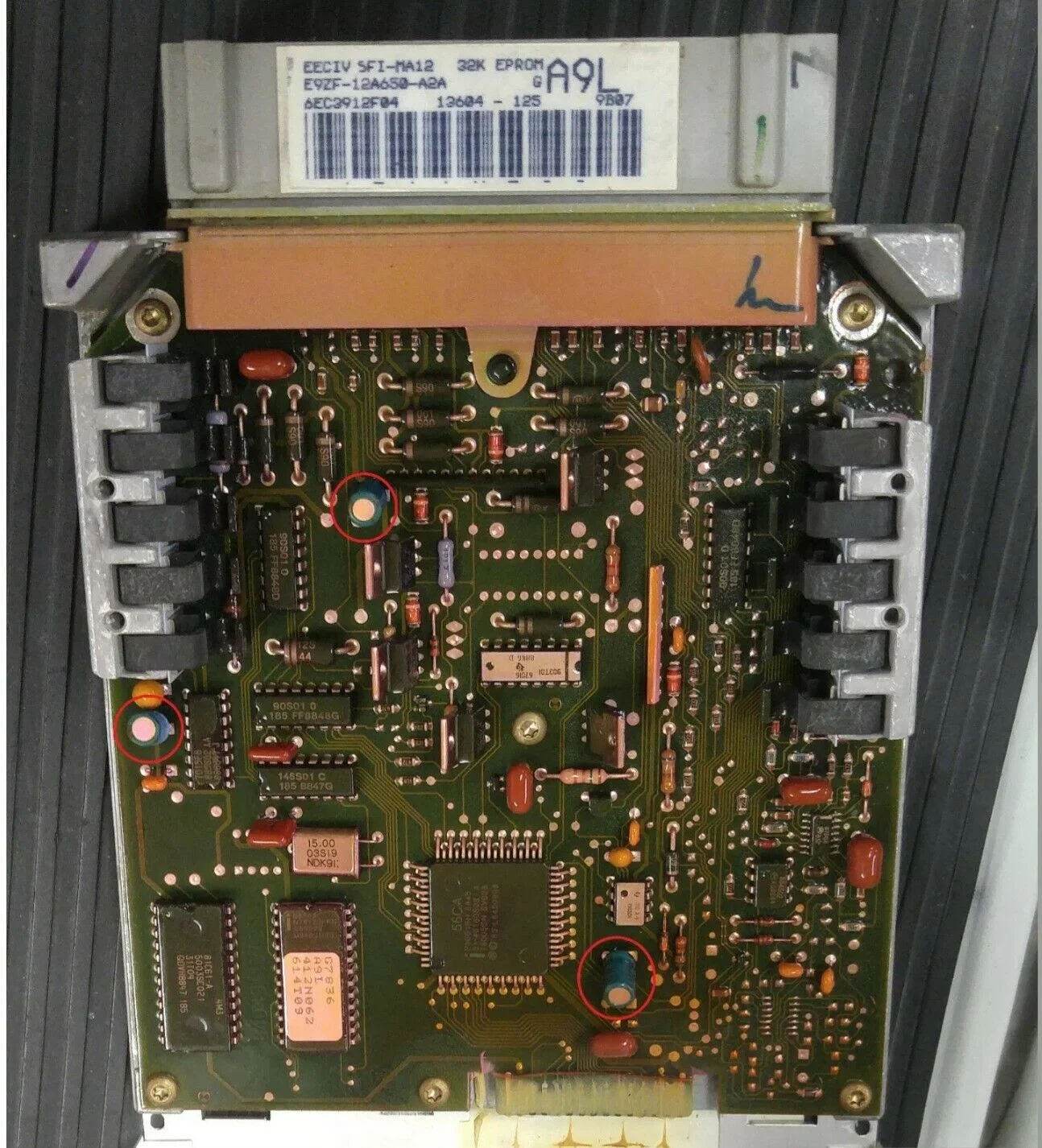

Can you be more specific? A9L?
The part numbers on the ECU would reference an '89 engineering number. But that ECU was used 89-92.
I'm not sure how they can tell it's an '89 ECU? The '89 wiring harness is a PITA to mate to a 91 body harness so I'm really scratching my head at your exact issue.
Post the part decal of your '89 ECU and '91 ECU?

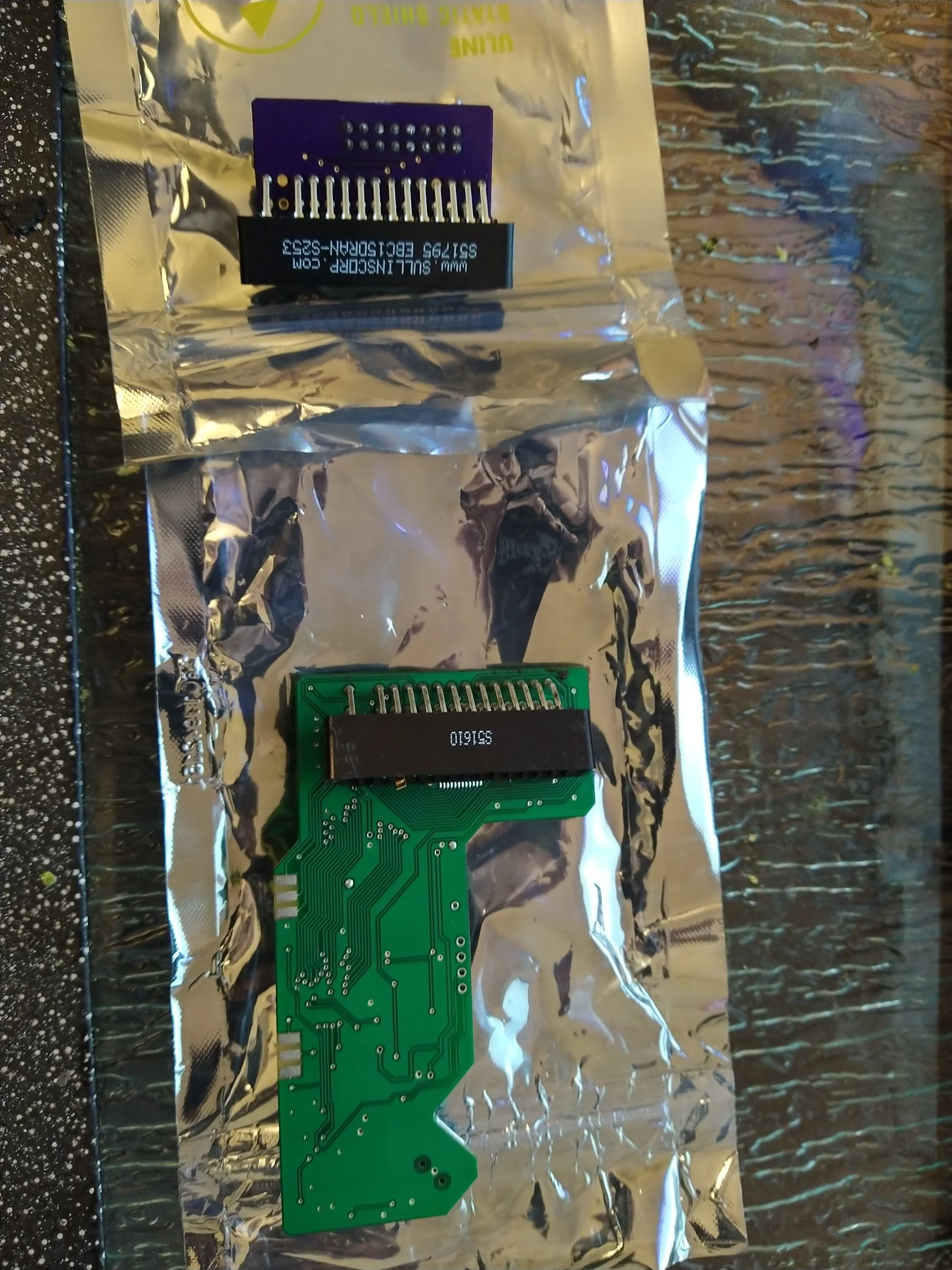

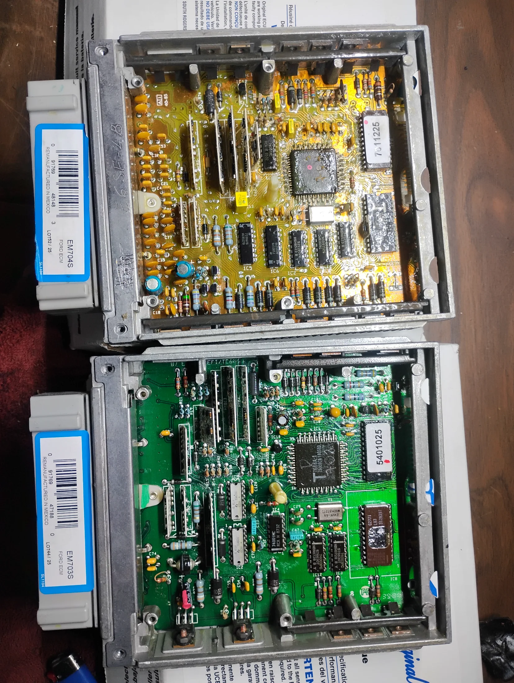

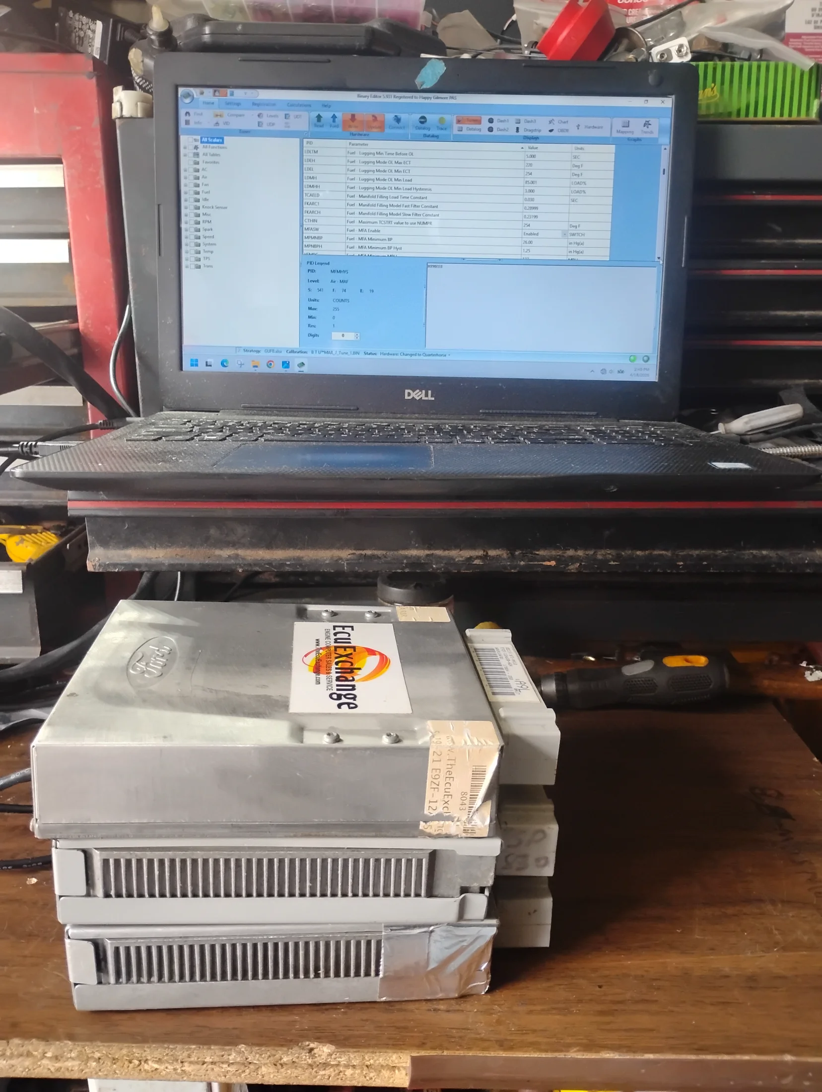

Scammers in Ca are using "NON-CALIFORNIA EMISSIONS ECU's" in cars with California emissions.
The reason why is that even with a quarterhorse the ECU's are much harder to decipher and tune than a A9L/S0Z or even a Z3M due to their internal buffer limitations..

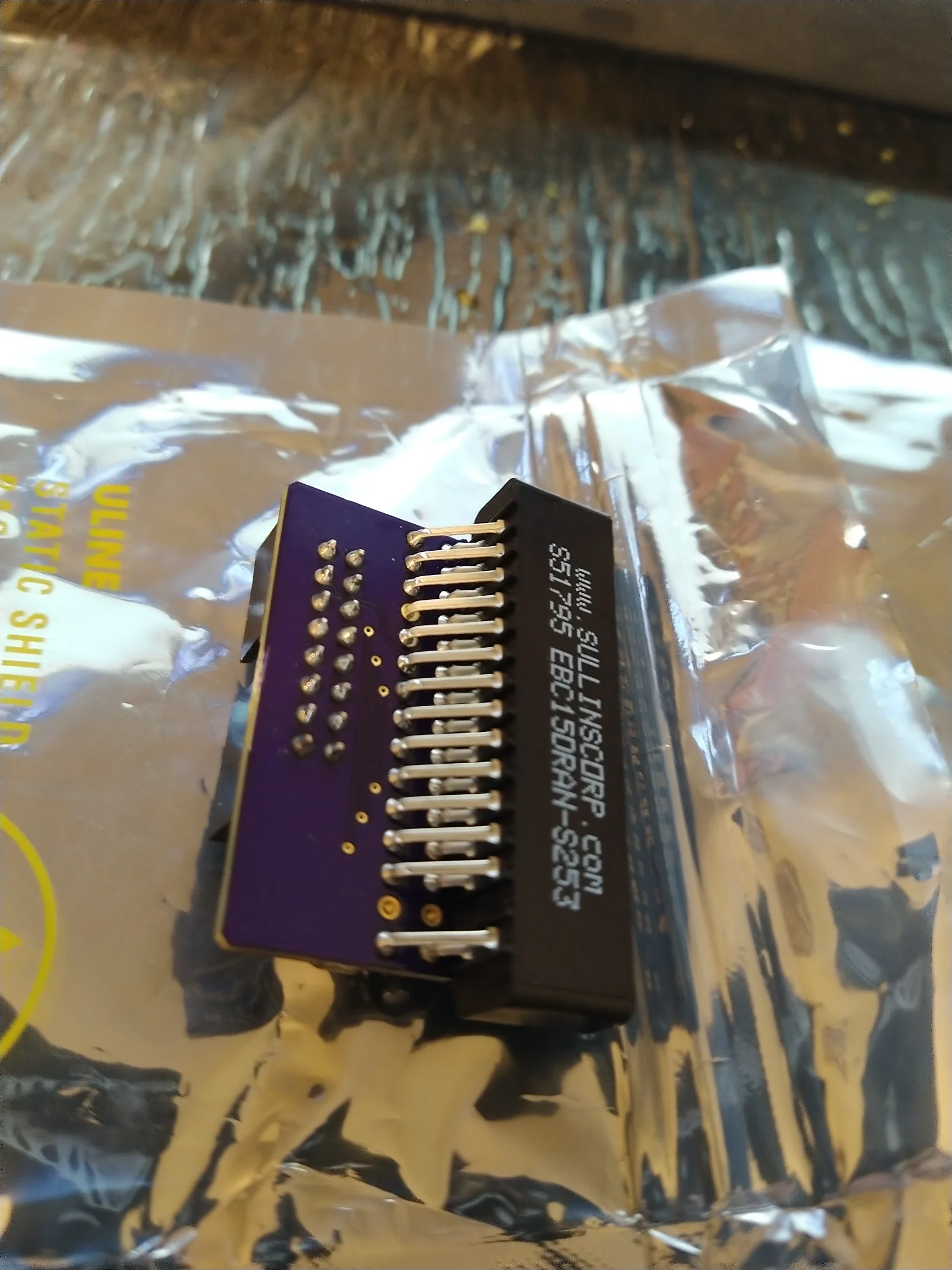

The A9L has a 56k memory chip and to be able to use an emissions ecu like an A9L you must get a memory buffer chip thats a plug in from moates......
For a 1988/89 Mustang GT w/Cali emissions and MAF the ECU is an 8LD.For 90-93 the ECU is an A9M
I ran into this issue when my A9L took a dump and I didnt want to pay $500.00 for one that may not work so I opted to buy the cheapest and only ECU's available through BlueStreak and none worked with the quarterhorse chip until I bought the memory expander and a 56k e-prom chip and now my California Emissions ECU's work exactly like A9L's....
