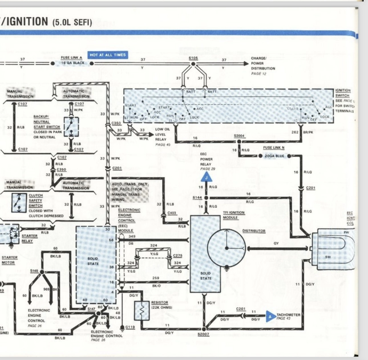

hello,
im new here but really need some help.
i just put a new tremic trans in my 89 lx coupe. only ran it 2 times and then just died. no spark seems to be the problem. I have replaced the coil, tfi and bought a new mega squirt computer. (kind of an excuse because i always wanted one.) still no spark. just replaced my msd distributor. still nothing. the ignition module is only 2 years old. im running out of ideas except a whole new wiring harness. i did notice today after installing the new distributor that when putting a test light on the coil when cranking the test light shuts off. this is like my 4th child and i am pulling what ever hair i have left out. please help with any ideas! and not the normal checklist that is always posted. went through all of those.

THe tfi module is brand new. Its acually my 3rd one. I ordered one from LMR. Then got one from napa in case they sent me a dead one. Now this is a brand new distributor that came with one. And i read my post from yssterday. I meant to say test light on the coil goes out when cranking. Its supposed to pulse not go out.
Little update. But maybe a start? I unplugged the computer (which is the stock one right now.not the mega squirt, which none them worked and did the same thing.) Tried to fire it up and see if i had spark. It almost started on the left over primed fuel. I believe that both computers are good. I suck at wiring! What does that mean?
