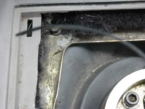

You don't need to take it off, just cut it out. The shift boot besel will hide it. Just cut a little 1/2" by 1/2" section out of the console over the top two screws so you can get a little socket on them, and make sure you don't cut to far or you'll see it. Makes getting it all back together a snap too.

True, you don't need to, but I garantee you that none of your non-cut methods are as easy as this:
