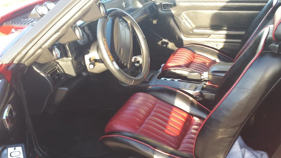

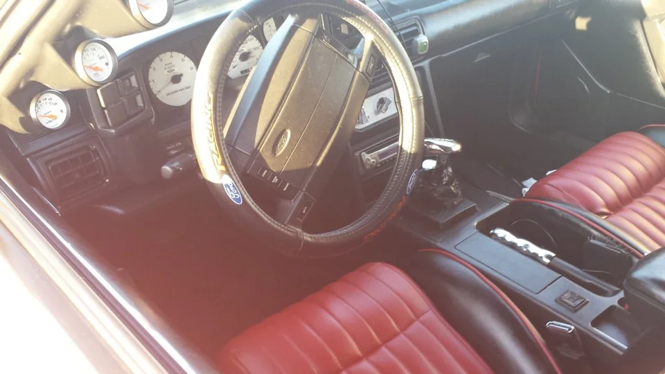

I use the autometer dash vent pod with openings at the ends where maintain some heat and AC.
I like to monitor oil and water.
Almost identical to this, other than I have phantom gauges.
https://replayman.wordpress.com/2009/12/27/proper-mustang-vent-pod/
