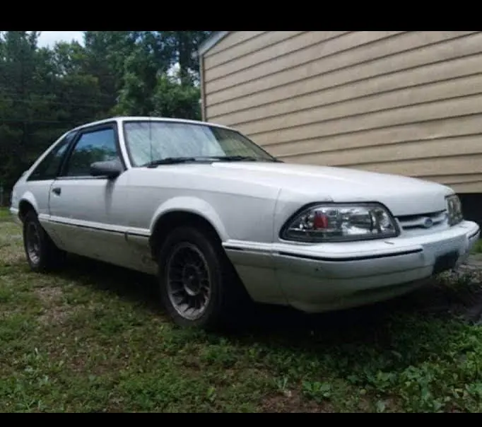

I have a 1993 mustang lx 2.3- I have not found any type of information on where to find the nutritious 5.0 or better yet what kind of car or truck it can be pulled from. I also would like to know what axle i need also the drive shaft and transmission. I would love to get a donor car but i cannot find one here in Va if some one has done this before i would love to here about it and what kind of issues i might run into or is it better to just leave the 2.3 in the car
