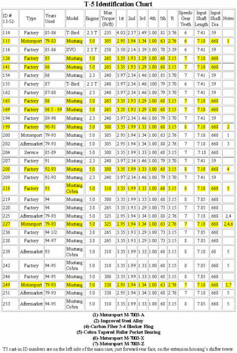

I am considering buying a "V8" T-5 tranny that a supposedly only needs syncro's replaced....The bad thing is he says that the tag is gone from the tranny. So I cant look up the # to see what it is. I'm meeting him Thursday afternoon to look at it and buy it if I get some useable info here before I go.
My car currently has a 4 cyl tranny and the tall 1st gear and 5th gear is really starting to bug me.
I know that the input shaft diameter is smaller on the 4 cyl and I can measure that to verify its a .668? But what other things should I look for to identify it as a WC V8 tranny and that all the gears inside are worthwhile and in good shape?

Check the number of turns of the input shaft for each gear to turn the output shaft one turn. That will help narrow down the possible range of T5 transmissions.
