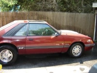

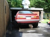

Here are some pics....click them

BTW: I used taller springs in the back to clear the tires...I would like to mini tub if i can get it running right!!!
