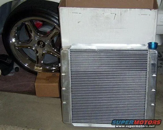

Does anyone have a how to on polishing aluminum? I just picked up an aluminum crossflow radiator and was thinking it would look pretty cool with the tanks polished.
