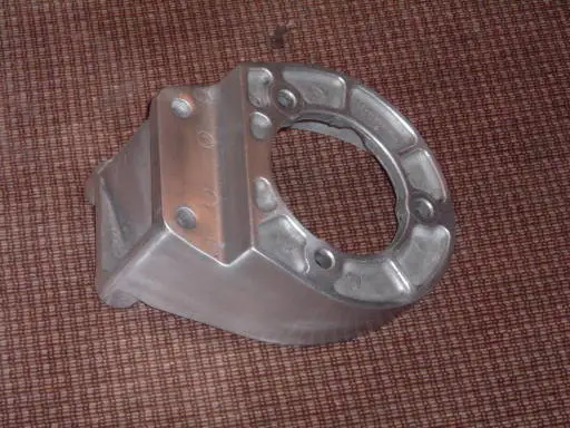

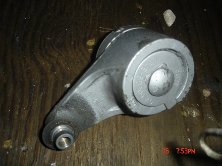

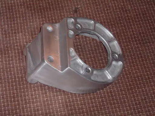

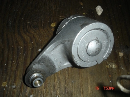

Before. Notice where someone took a grinder around the blow off valve :bang: .
Another before shot.

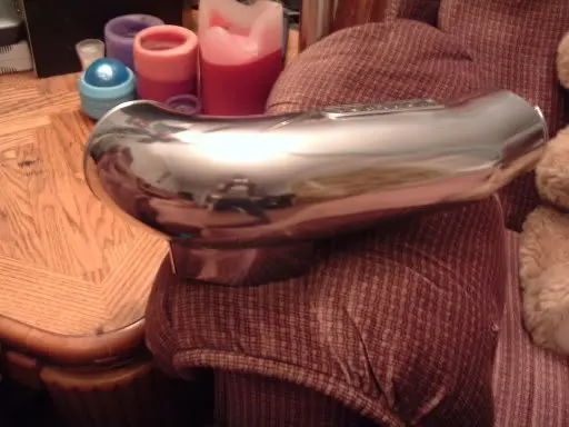

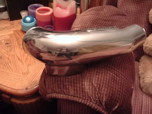

Here's a good tip. I like to use the sponge back sand paper by 3M. It comes in a variety of grits. I cut it in quarters and goto work. I like it because it saves your finger tips and resits rolling over on itself when your really pushing down.
Here it is after HOURS of sanding. This is after 320 grit and I'm ready to do some buffing :nice: .
I sat down and polished till it was done!
Check out these glamor shots :D .

89white50 said:
that looks amazing pb_paulie_B, definitely worth the time and effort you put in. sets ur car apart from the rest for sure.
*oh and i forgot to laugh my ass off cuz of daggar once again. so here it goes...:rlaugh: :lol: :lol: ahhhh thanks :D
Thankx for the compliment :nice: . Anybody can have a stroked 351. Anybody can have one blown, but not a polished stroked and blown 351 :D

Back to the grind. Now that the discharge tube is done I'm working on the power steering pump bracket. I have heard from several people in the know that it's one of the hardest items to get a good shine from... No promises but I'm gonna give it my best.
Man the casting sucks. It looks like mine wasn't even aligned right when it was poured :rolleyes: . It's going to take some time just to get the crude off.

The haze is SO frustrating with this pc..I have managed to get quite a nice appearing finish, only to have it haze up on it's own (though still quite nice) . Even the best available products and softest cloths seem to leave fine scratches and mild haze on the pc. The parts look GREAT...nice job removing the seam and really a nice finish surface...just don't get overy frustrated, it's just not a great casting. This is the only pc I have dealt with that seems to have a desire to be difficult...I just think of it as a typical ford part...:)
