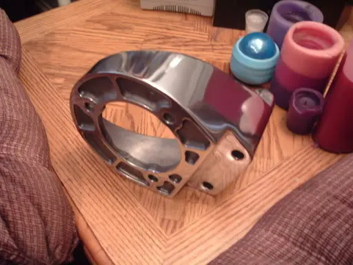

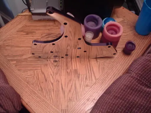

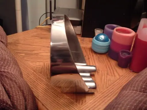

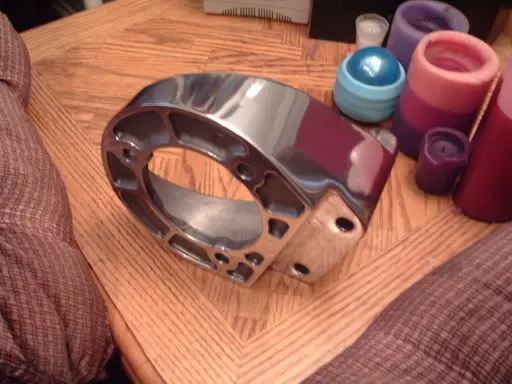

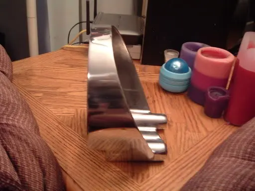

I'm finished that pita bracket. There is still a very slight haze but overall I'm very happy with how it turned out.
Now the pic whoring!
This one shows it in the light, the least flattering shot...

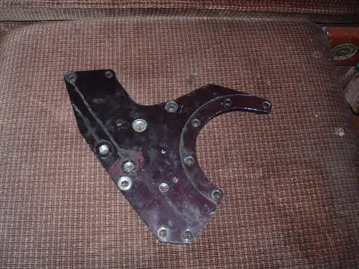

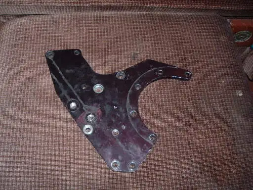

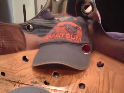

OK peeps jes thought I'd add my YS bracket to my polished collection. Correct me if I'm wrong but I think it's steel.
before,
After !

Holy cow, you made a mess!
That YS bracket looks great, especially for what does look like steel. Hope it stays that way!

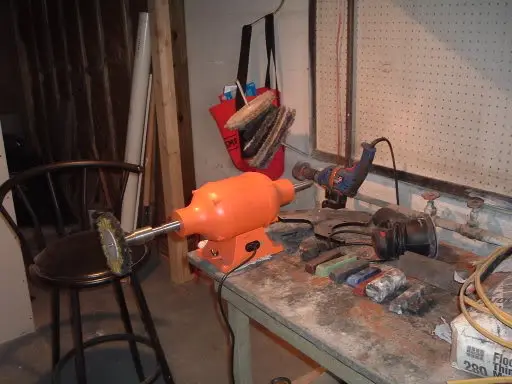

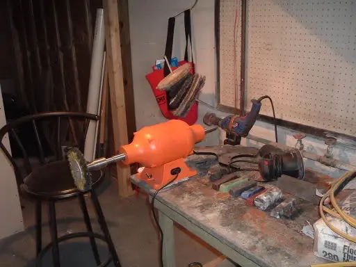

I broke down and bought a 3/4 hp buffing motor from harbor freight for like 80 bucks and picked up a quick change system too because as you know every metal is different and it makes finding the right buff/compound combination alot easier. I was using a drill but I found it alot harder to keep my pieces in place while I work.
this is my new set-up
The bar stool really is a requirement for hours on end of polishing. The table came with the house which was built in the early 1900's and looks pretty old but serves it's purpose :nice: .

No ide a- put a magnet on it. If it sticks, it's steel. It really looks like it but I don't know if that's some kind of coating that was put on it so it wouldn't be left raw.
