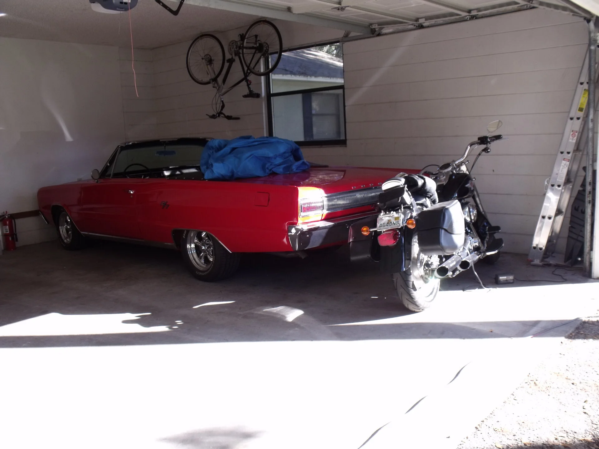

During my resto I installed new stock motor mounts on my 67 Dodge... Was doing something to it with the hood up and slightly power braked the car in reverse while watching the motor move upwards about 5-6 inches....
Replaced the motor mounts with " Schumacher" poly mounts ( I think) and the amount of vibration increase was quite noticeable.... The 040 bored 440 in the car had been balanced too..... Must of become the norm as it was not noticeable to me later on.....
The " made in India" NAPA motor mounts were not broken... Great rubber bands must come from that country.....
