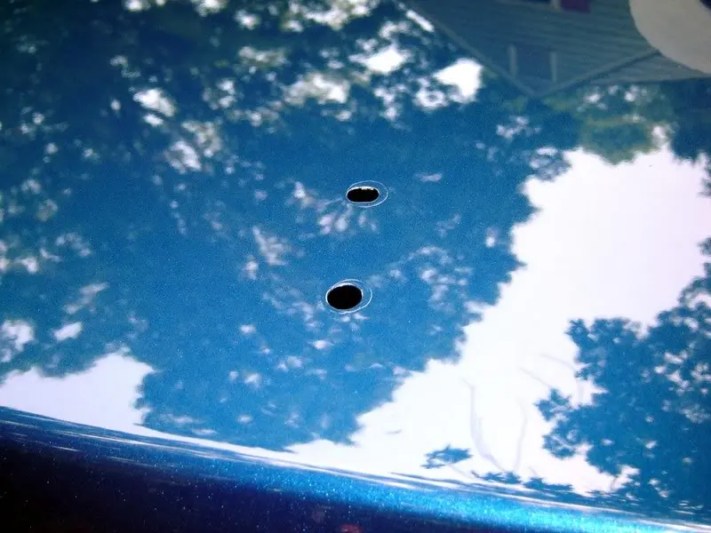

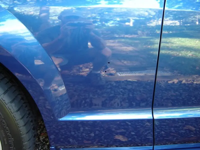

KD, thanks for the tip. What about the GT emblems on the side, doubletape too or something else? Is fishing line the best way to remove the rear one?

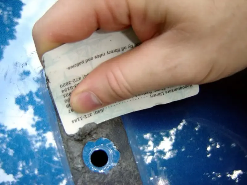

The GT emblems are in fact double sided tape with two alignment pins. You need to be careful though as they are thin and can crack/break easily! I used my library card to get under the emblems as it's not as flimsy as fishing line, but also not as bulky as a regular credit card. Just work at them slowly and you should be fine.

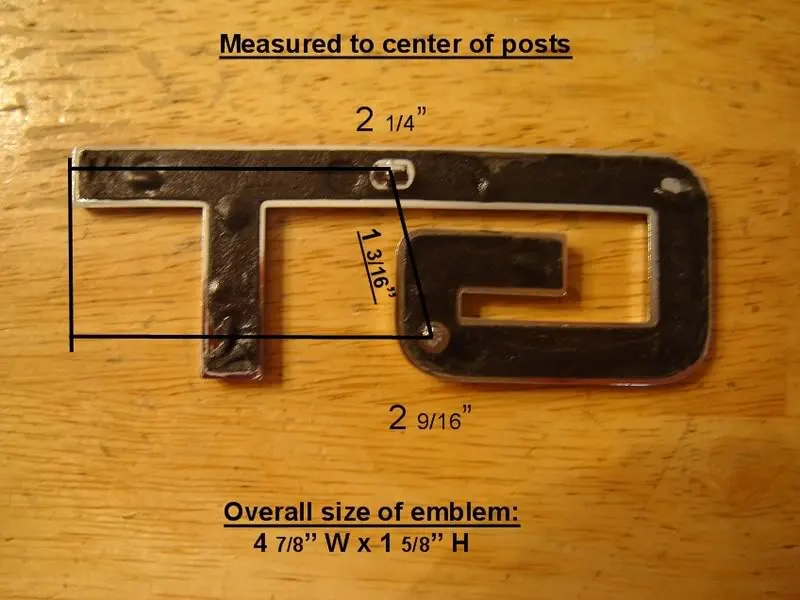

Here is the emblem info.

The library card method.......KD you rule!!!! Thank God for the internet. I would never have thought of that.

Here is a pic of me doing the rear spoiler removal with said library card! Actually this was after I removed the spoiler, but still getting all the adhesive off.
Look...no scratches
