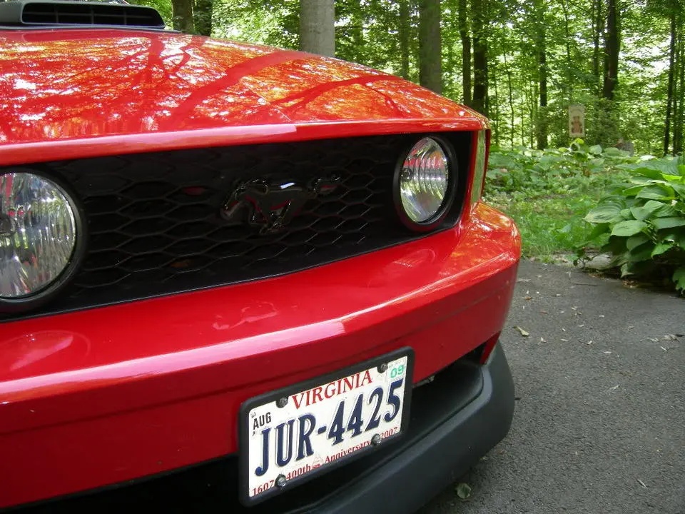

I have been on a crusade to eliminate the chrome from the outside of my car and replace with black stuff where I can.
I decided to replace the last piece, the Grill Pony, with a new 2010 black chrome grill Pony. It wasn't an exact fit but with a little help from the Dremel tool it looks pretty good to me.
Watcha think?

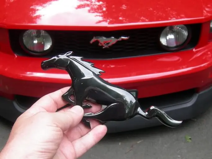

I paid $37.00 on eBay for the new pony, the list is over $40, but now I have the Ford part number which is AR3Z8A224BA, and if you go to this link,
https://www.trademotion.com/partlocator/index.cfm?siteid=214290&gclid=COeA6t7Jp44CFSgQFQod1EPtZQ
it only cost $28.76 and some 3M trim tape.
Time to install???
It didn't take a lot of time, a couple of hours all together I guess. Getting the old Pony off is a pain in the butt. It was just too much trouble to get the little locking nuts off of the pins on the old pony, so I just used a flat blade screw driver against the point where the pins come thrugh on the inside and broke the pins off and the pony just fell off.
The profile of the two ponys is different, so the back plate on the grille will not allow the pony fit. I had to use a dremel to trim away quite a bit of the recessed edge of that plate and attached with the 3M trim tape. If you look close it will look almost like the Pony has a shadow. NONE of the new pony's pins will fit the old backing plate on the grille.

It was not what I would call very difficult, but it takes a steady hand on the Dremel I suppose.

You could probably drill the individual holes the 2010 uses, couldn't you???
And you had to dremel "the area around the stock pony"??? Is the 2010 pony "longer", "wider", or "thicker"??? :shrug:

The Pony is just in a slightly different "stance". it's nose is a bit higher, the tail is shaped slightly different and a couple of other little places are slightly different. When you look at the two Pony's side by side it's hard to even see the difference, I was surprised that they were different.
I just found it a lot easier to simply trim the pins off, and use the 3M trim tape.
