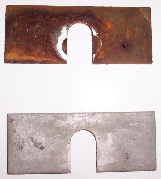

Ecthing your metal work with Muriatic Acid (Hydrochloric acid) will definately promote corrosion. The salt left behind from eating the rust off (ferric chloride) is very corrosive. It is unlikely that you can removed all of it by rinsing. Phosphorric Acid, on the otherhand, leaves a residue (ferrous phosphate) that protects the metal from corrosion. Phosphoric acid metal prep is cheap and can be bought at Home Depot or Lowes in the paint departments.
Good Info. - Thanks. I read about the use of both of these in my welding book, but it didn't offer the info. you posted.
I did a test with muriatc acid some time ago and it did an excellent job of rust removal. rustyspacer2.jpg I haven't used any on the cars yet, and now won't.
