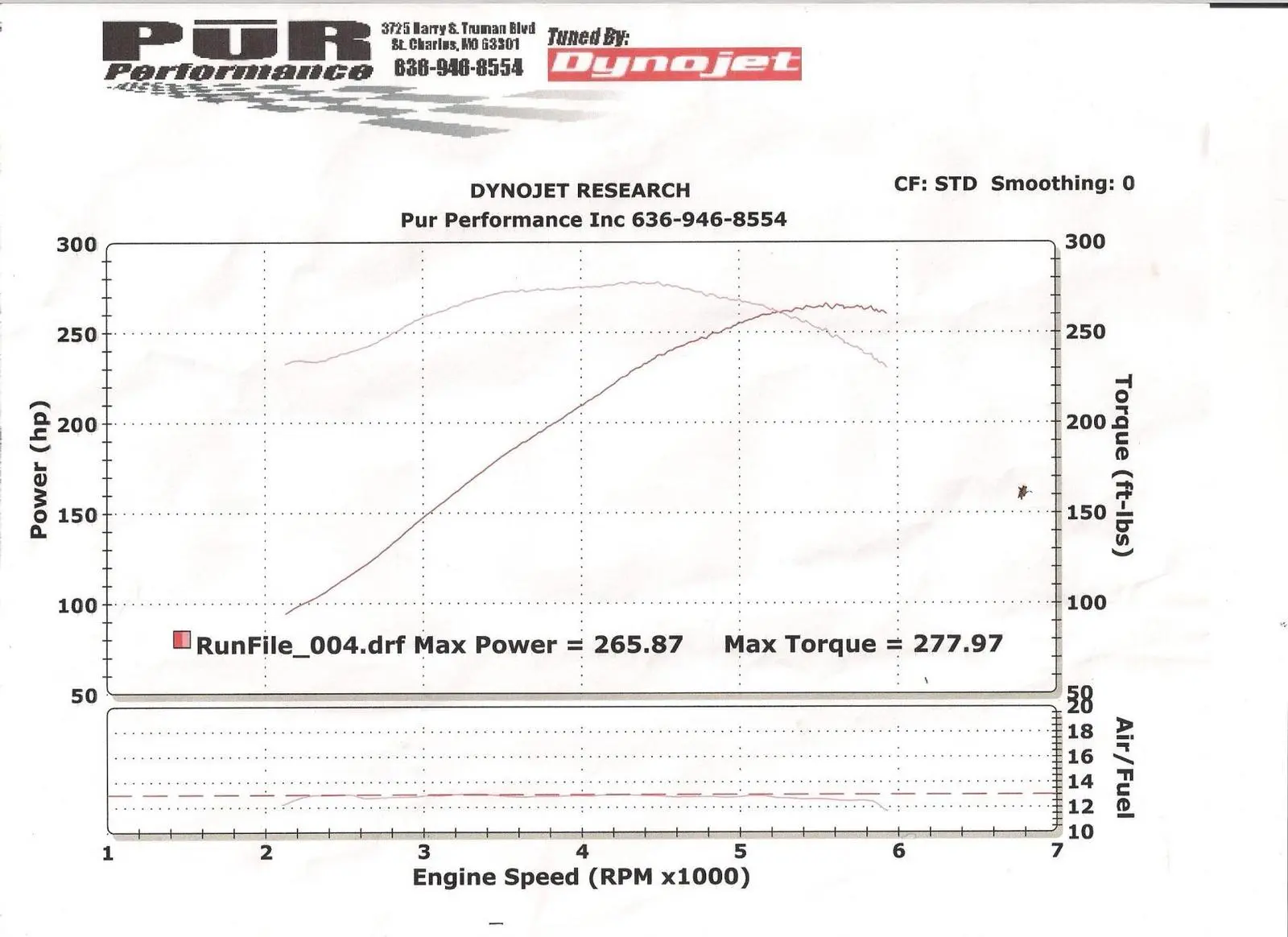

Well I had my cousin (who's going to school for maching) p&p a set of pi heads I had, bought Hitechs stage II's and put on my 97 for pi swap. Last Friday I took to get tuned and only made 266hp and 278ftlb. I know the heads are not prefect but Hitech's website says stage II cams make 300rwhp on stock long block, so i called them up and asked some questions and he said you'll lose 40hp and 30ftlb with p&p heads. Here is the link to there dyno gragh...

Do you have a plot of the 266rwHP dyno pull you can post?
What was the AFR was during the pull?
What was the timing?
Who did the tune? How much did the car start with? Is 266 the best the tuner could obtain?
What other mods does the car have, specifically intake and exhaust? Was it a Mustang Dyno, Dynojet or ____ ??
As well, take whatever any vendor says with a grain of salt, especially rear wheel horsepower numbers. 266rwHP is ~306 at the crankshaft which is a pretty respectable number for a normally aspirated 2V.
