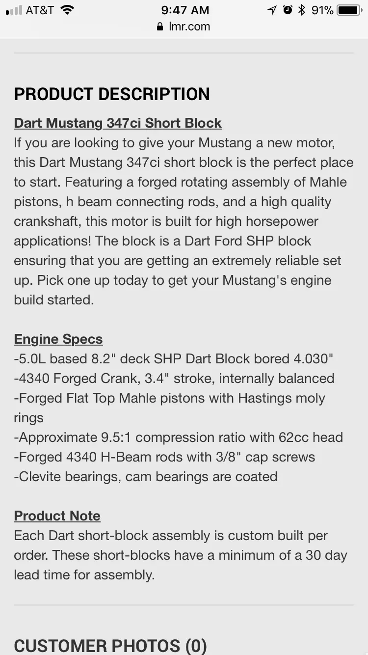

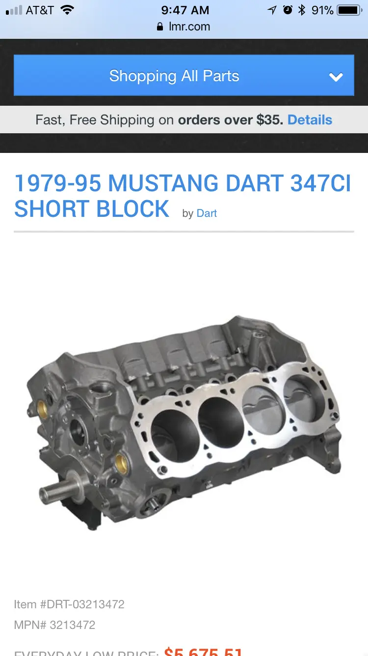

Ha ha those Jamex springs getting dogged on!! Yes that is in the plan in regards to brakes, I want to swap to 5 lug, front and rear discs. I do eventually want to swap to MM all around suspension, but for now I just installed UPR LCAs, gonna buy the MM subframes and have those welded in. So the reason i was thinking about 190s was bc I was possibly planning on stroking to 331 or 347. Do you think that if i happened to not go that route that the 190s would be to much for the set up I was talking about?

Well I’d like 400-500hp, no track days really, just a fun weekend, car show car with some power. If I did go stroker I’d probably not stroke my actual motor, I’d end up going with a dart 347. But seems like going with what I originally planned, my Tubular GT40 with ported lower done by Tmoss, 47 or 60 LB inj with pro m 80, aero 340 fuel pump with aero fuel reg, 11r heads was gonna get 190s Incase I did upgrade to a 347 but don’t want to get them if they are overkill, v3, change my f cam to either tf stage 2, or possibly custom but not sure on that. Would swap out my current exhaust, debating long tubes or equal length with a not sure muffler yet, either keep h pipe or swap to x pipe depending on header choice of course. Currently got 3.73s, get a new radiator with the contour fans I got the link for, and a 3g alt.

This is all very nice (not being facetious) but you have many parts here that a lot above what is necessary to split the stock block (overkill).
Let me pose this possibility:
You have a working motor now. It runs. Why not begin by purchasing a $2000 Dart Sportsman and begin planning for its prep? I'm someone who dislikes spending money multiple times.
While you're getting the Sportsman ready, you can look and see which head and cam will go best with the new short block.
It looks to me like you have some very high expectation of "Holy Hell" HP. May as well begin from the bottom.
I can tell you that I have roughly $10k into my DART long block and have lost track of what I have into the blower etc.
