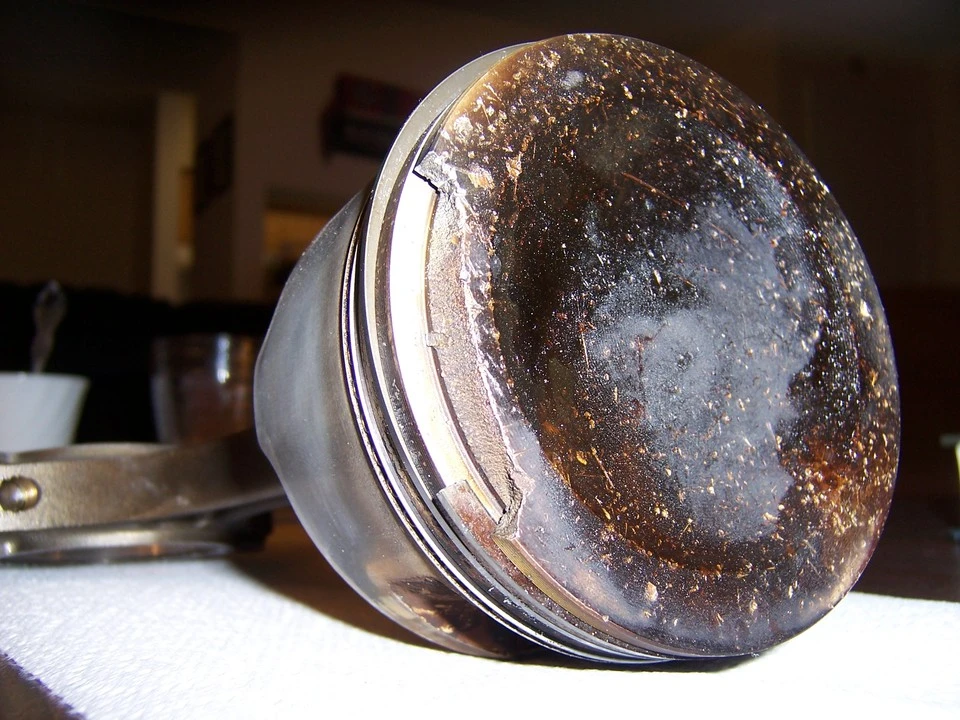

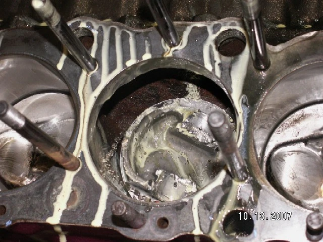

Keep on hatin'.....y'all just don't know what I've got planned. :D
OOh wait... I do!!!
:D
