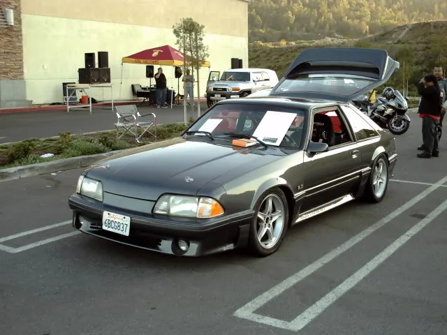

Yup heres me car at show/street height
heres my car at track/race height
PICT0047-2.flv video by ShaolinCrane - Photobucket
notice how high the rear tires are from the rear fenders, sorry but rarely can you look good and and perform well at the same time
