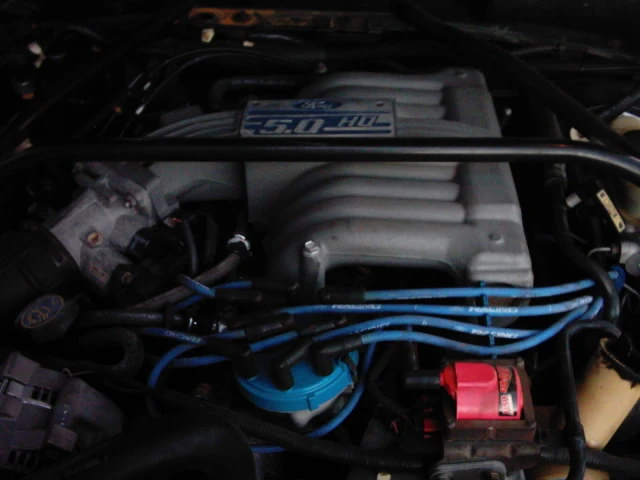

500 Degree Du Pont rattle can. After stripping the old powdercoat down to fresh aluminum.

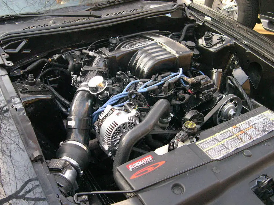

here's mine
Stripped the factory powdercoat off, sanded down all the casting seams and texture, then put down many coats of Dupli-Color 500 degree ceramic silver with 600 grit wet sanding between each coat. Also added some red to the cobra snake and polished the lettering.

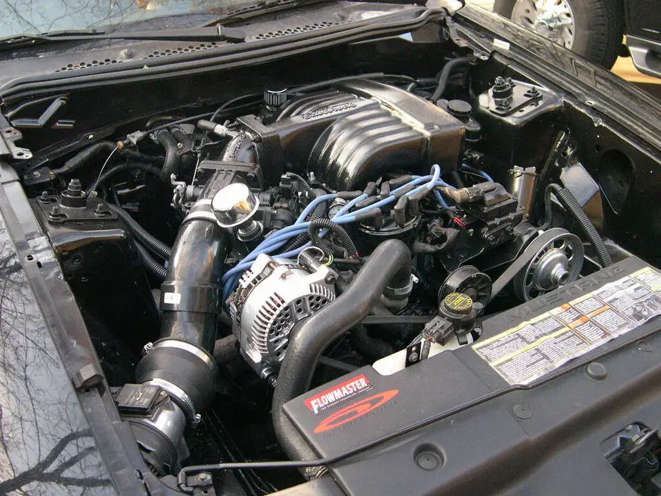

I always liked Silver...Its just stands out....I ran Black to, but to me the Black kinda hides the upper...
What colors you got on the motor??
I have a GT40 Tubular out being polished except the runners, and the cover plate polished...The runners I have yet to choose a color...It wont be Silver this time though...Maybe Rio Red to match the car???
