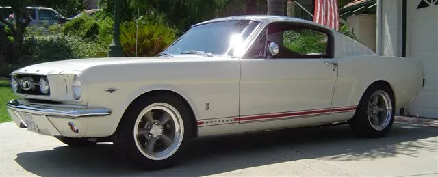

Boyd coddington timeless 5 wheels, 17 x 8 all around with 4.75 backspacing. Had to roll the lips on all 4 corners.
