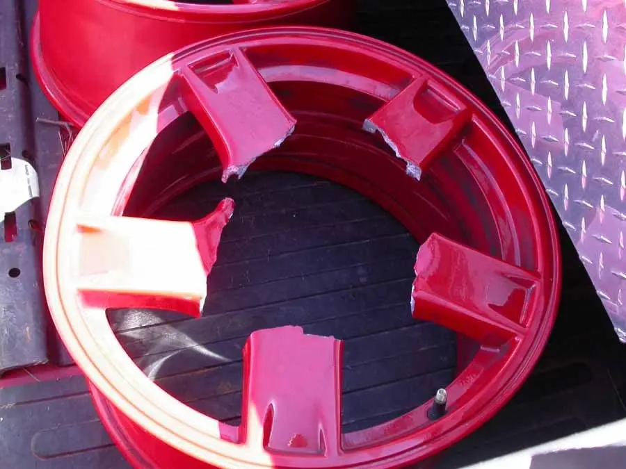

I would suggest paint vs powder coat. Pcing temps are pretty close to the temperatures which begin to affect the metallic properties of the aluminum. The heat causes the metal to begin to anneal.

They potentially combine the powder cure schedule with the metal aging schedule so both are done at the same time.
Unless you know the alloy of aluminum, and the heat treatment, you have no idea if the wheel really will weaken. Not knowing what the factory did to the wheel adds to the problem because their coating process could use a short aging temperature period as part of the manufacturing process...and then 400 degrees in an aftermarket powder coating oven could begin to overage the aluminum and reduce it's strength.
So you could be totally fine with one aluminum wheel, and then be unsafe with another because of the processes the wheel was subjected to as well as the alloy.
Most cast wheels are 356 aluminum (forged/machined are usually 6061). If a 10-hole is already at t6 condition from factory, then at hour at 400f might create a t7 condition which is weaker. But, I do not know what alloy the 10-hole is, or what heat treatment it already has. In fact, most people don't know what allow/heat treatment their wheels are....so it's a risk some people take with no issue
ASM Handbook Volume 2, Properties and Selection: Nonferrous Alloys and Special-Purpose Materials has the following information:
356-T6: aging at 305 to 315 °F for 2 to 5 hours
Yield stress = 185 MPa
Ultimate stress = 262 MPa
Fracture strain = 0.05
356-T7: aging at 435 to 445 °F for 7 to 9 hours
Yield stress = 165 MPa
Ultimate stress = 220 MPa
Fracture strain = 0.06
There are some pro podercoaters that have the metallurgical knowledge to do aluminum wheels safely, and some that just slap stuff in an oven

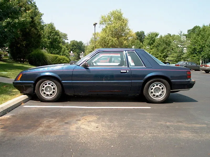

They take on a police car steel rim look when you paint them black. That's not necessarily a bad thing, just depends on your taste. Personally i like them painted a bright silvery color with a machined lip.
Here's a pic of mine from WAAAY back in the day
