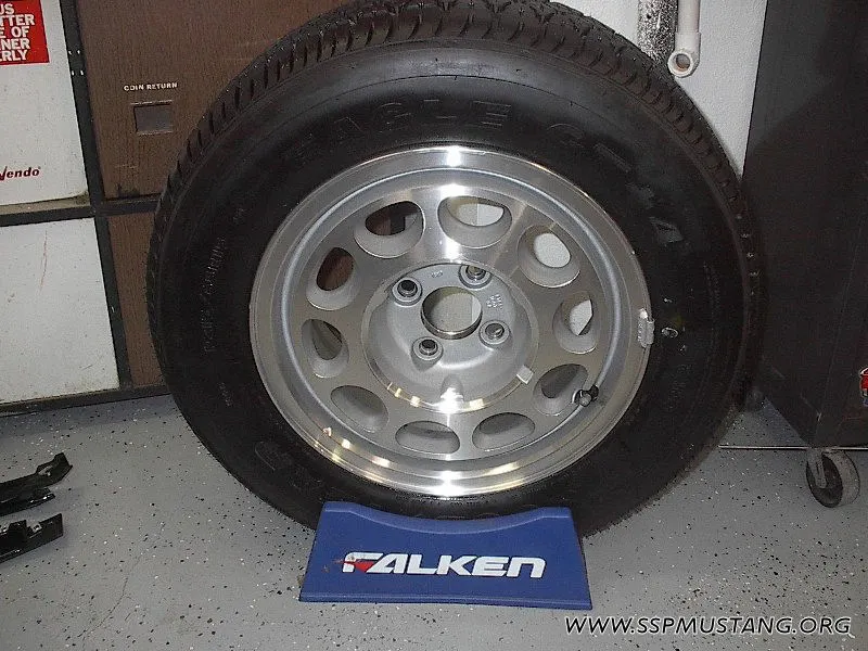

I would just get a set widened. IMHO the only way you could pull the black look off would be to leave a polished lip. I wouldn't even run a centercap. Put some chrome acorn lugnuts in the middle to help break up all that black.

Yeah 18's are a bit much imo but 17's would be fatty. as for not running the center cap, i havent even given it thought....i might have to try it and see what i think. if i go thru with it ill post some pics.

I'm a big 10 hole fan. I think of them as the poor man's Welds. I've always wanted to widen a set for the back, but i want to deep dish them and i'm not sure how well that would work or if it could even be done. They would have to change the offset somehow so the rim sits further into the wheel well and i'm not sure that's possible. They don't look bad painted black with the face left silver. You could always widen the backs and make the front into skinnies too.

I weighed them when I took them off my car and they are actually pretty heavy. SO, I don't know if I would compare them to Welds, haha.
