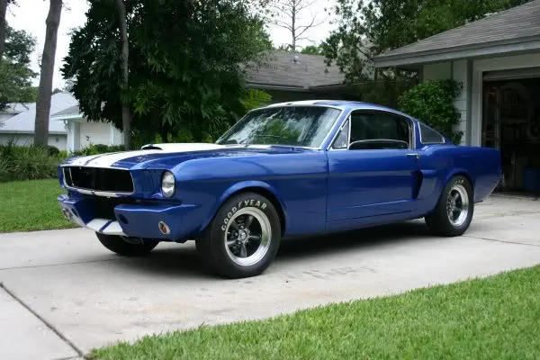

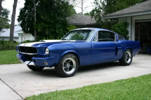

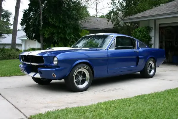

i thought of painting but if i screw it up then i am stuck with ugly wheels. does anybody have any pics of spraypainted black wheels and comparison pics of powdercoated wheels.
My dad spray painted these himself, with the cheap autozone wheel pain, their not black but their the gunmetal color. I think they look sweet.
I could go out and snap some upclose pics if you want.

thats you dads? what color blue is that?

what color is that?
Its viper blue.
