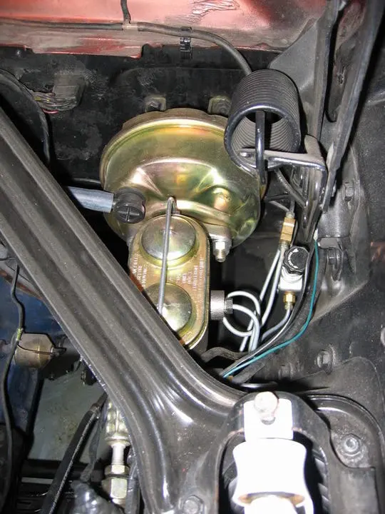

This is a booster/M.C. sold by NPD. This is in my '66 with T-5, stock clutch linkage, 4 wheel Cobra disc brake setup. 6 cylinder car (getting the same engine swap as you in a year or so).
Works well. Has about 1" clearance under the Export Brace. With the stock brace it had about 3/8" clearance. Plenty of room for stock clutch linkage.

Thanks guys. I just wanted to be sure. Like I said, I would make it work, but at least I know I won't have to invest too much time, since theres enough room.
