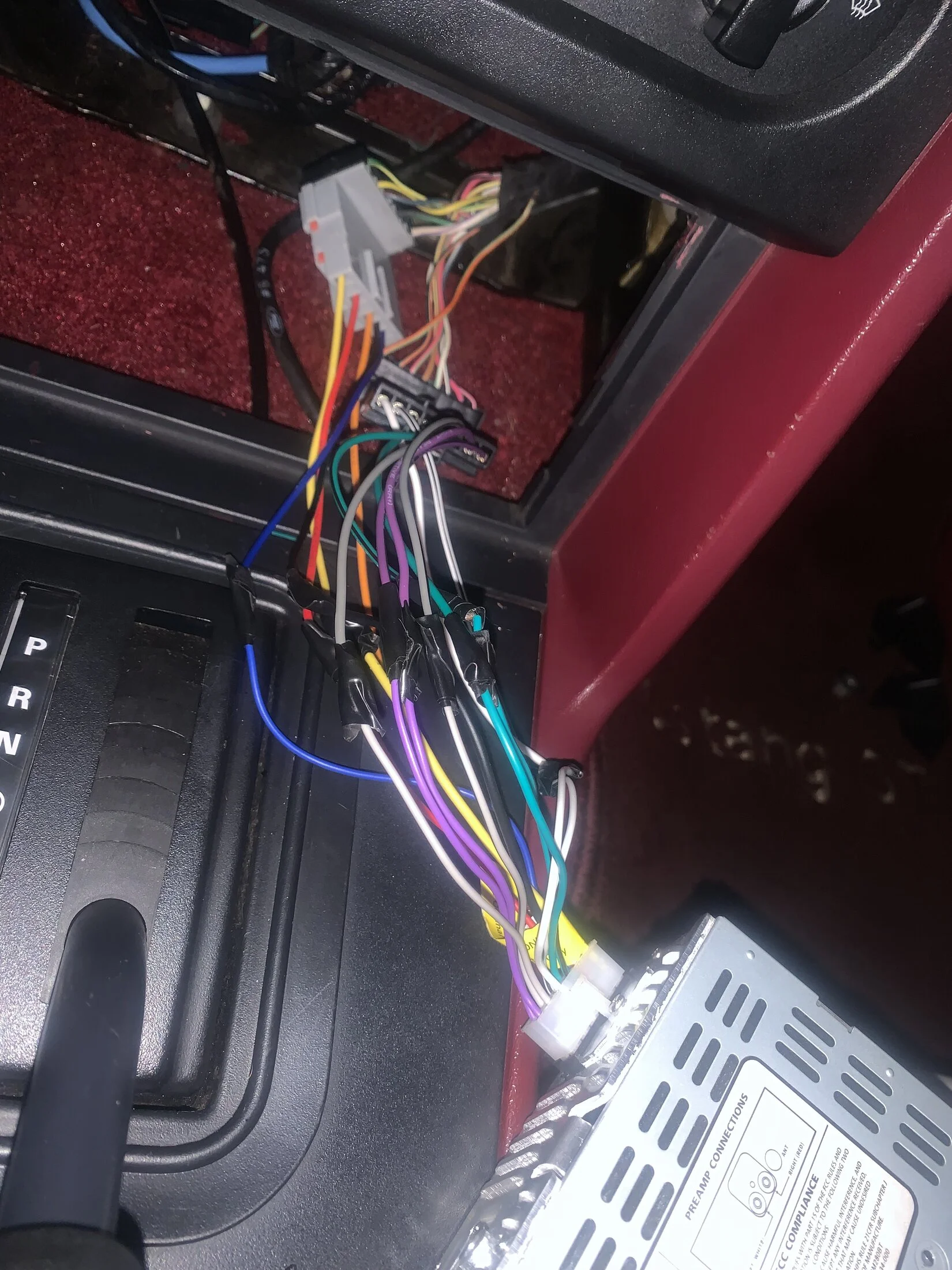

Electrical Power but not sound
Gonna need some more info. Maybe some pics of connections.
Did you get an adapter harness? Did you splice wires?
Did you connect the speakers to the right wires by using a wiring diagram, or did you just go color to color on the adapter harness to your radio harness?
IIRC, the speakers don't match up to the colors on the adapter harness.

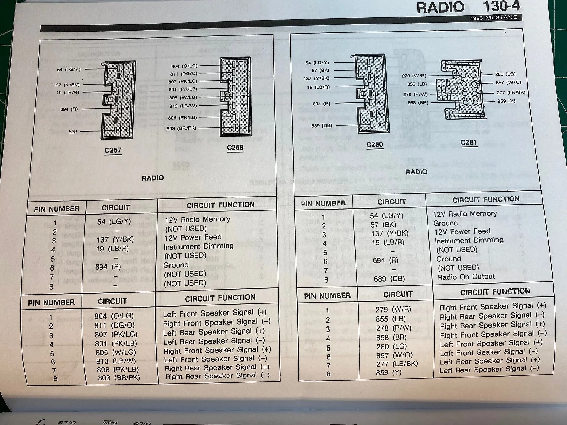

This is a 1993 right? Use this to verify the speakers are going to the right locations. This is the body harness connections, which assumes you have bypassed the 1993 amp harness completely, which I think you have by the pics.
(use the left schematic) right is the amp harness (blue wire and corresponding power plug)

Thanks for all I just run new wires
