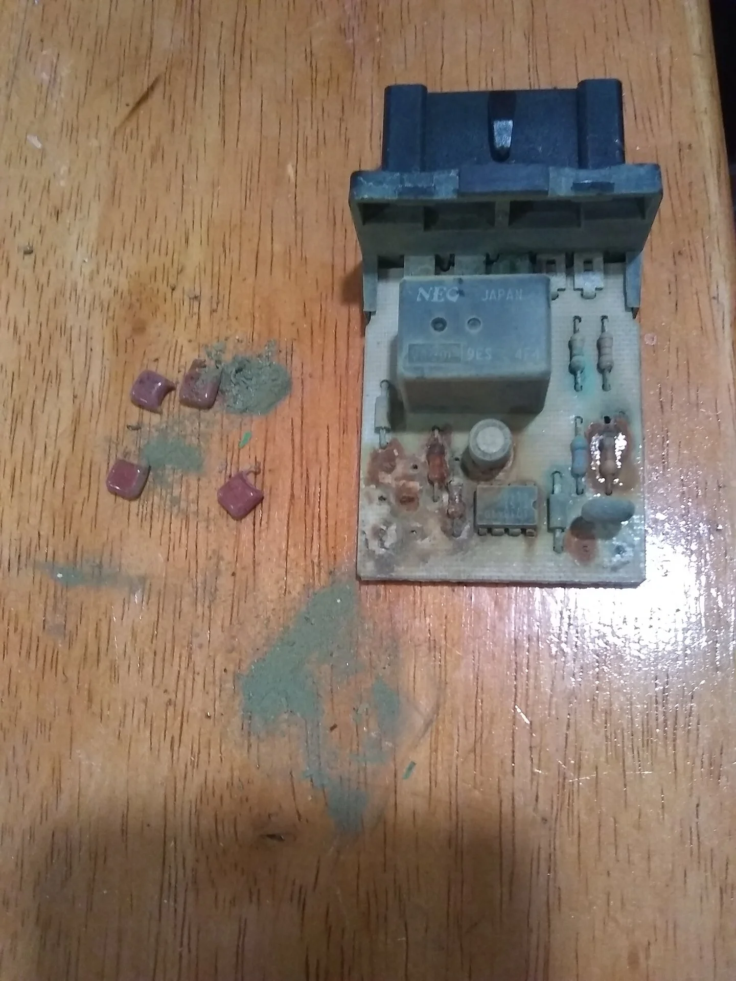

Hi guys. I have a 95 GT 5.0 with driver window not working. There's power to switch, up and down. There's power to the upper and lower halves of connector plug wires from switch to window motor, but only when pressing the up button. I swapped the driver/passenger switches, both work for pass. window but not drivers. The window motor works w/wires connected straight to battery. There's no One Touch Down option or module. I didn't check the harness in the door hinge, if the power wire was broke the test light wont light. Is there a relay not shown in the diagram or secret handshake I'm missing?

There aren't any relays or anything, but a missing/damaged one touch relay would cause what you describe. It's usually mounted inside the driver doorpanel; is there nothing there?

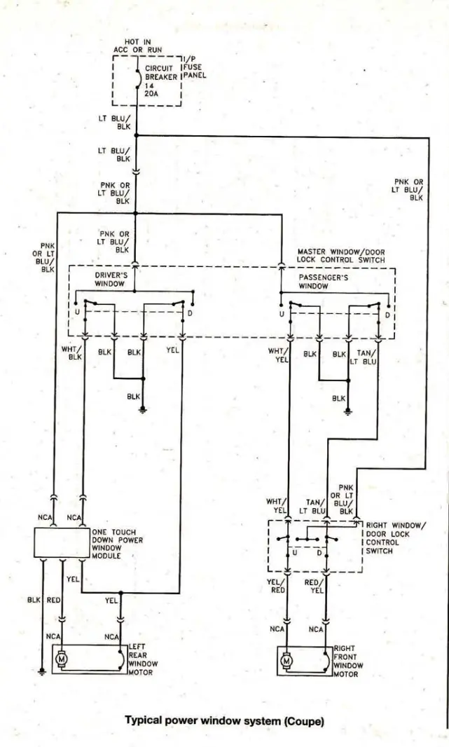

Wow there is a one touch down module in my car. I have the car 4 years didn't know I had one touch down control. It has never worked. I was always able to just roll the window up and down by holding the button.
There's something jiggling around inside mine. How do I test it or do I need a new one? Thanks for your help.

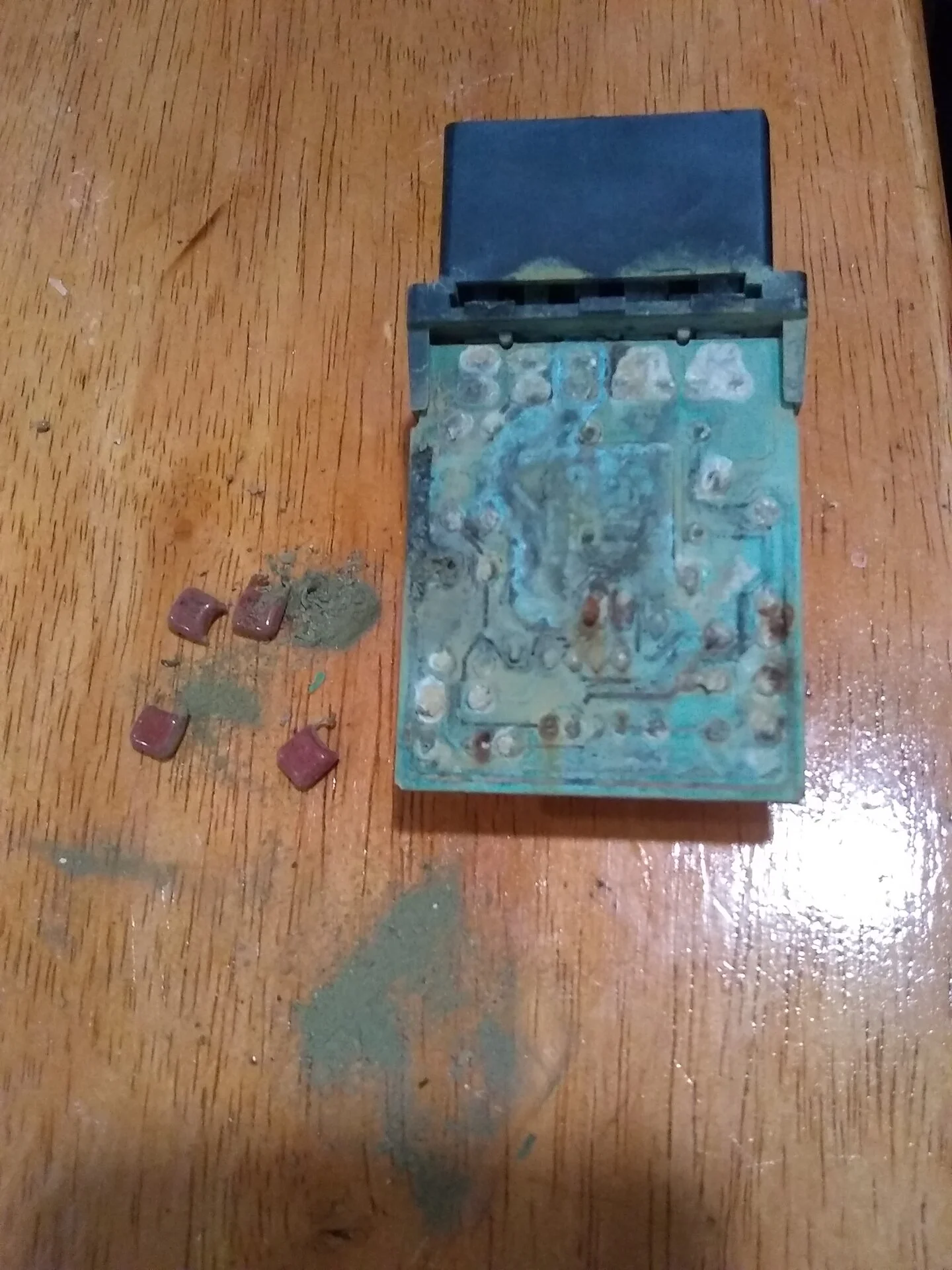

Ok forget testing the module. I opened it up and Im pretty sure it's bad, lol. ( See attached picture) Is there a way to by pass this module so I can roll my window up and down again?
