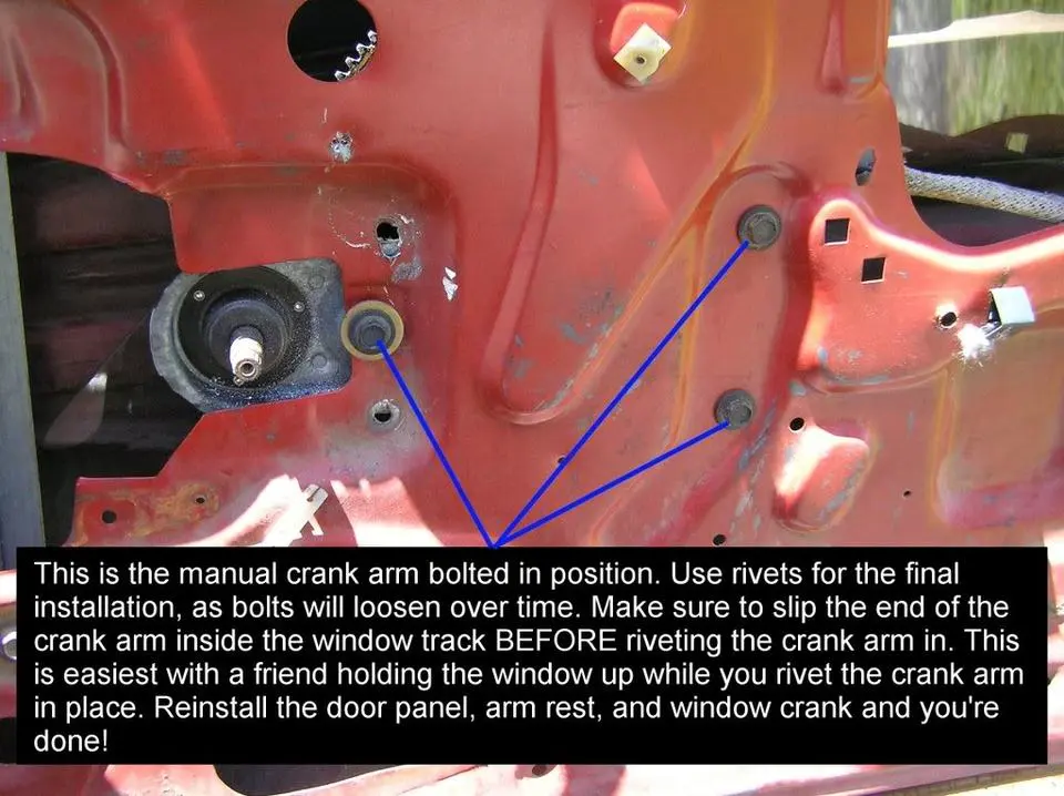

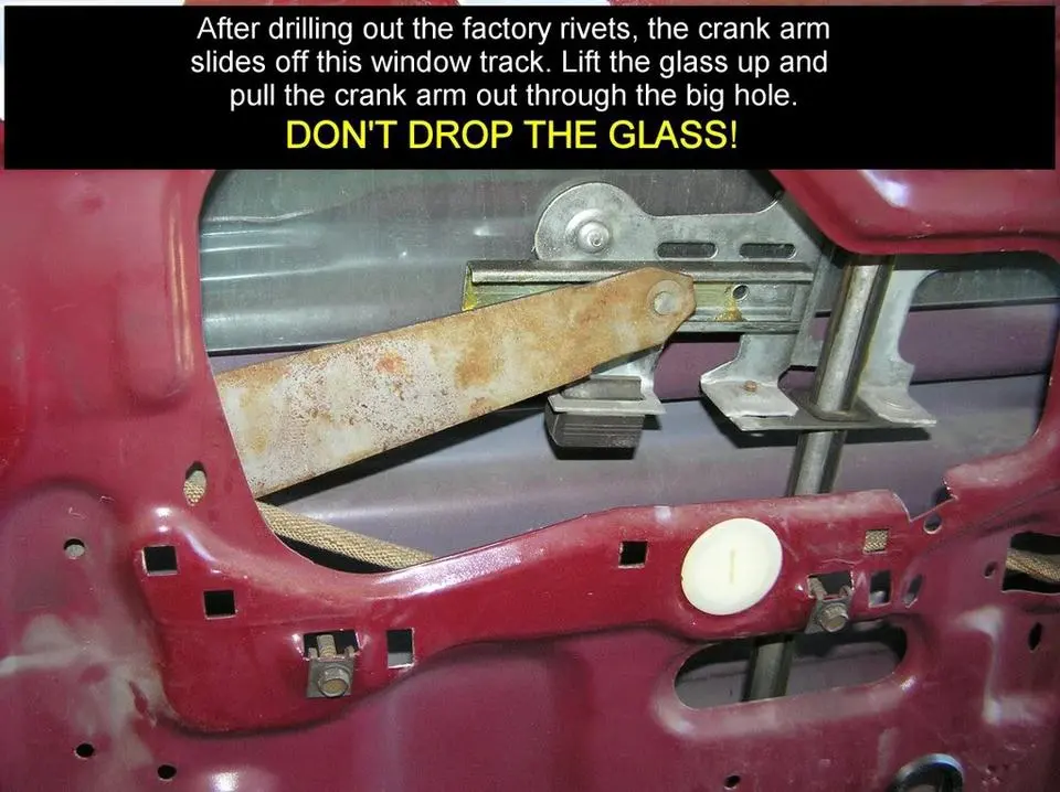

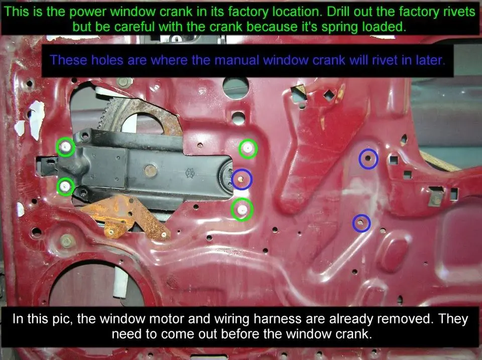

I went ahead and labeled the pics, so everyone help themselves and right click save. Hope it helps someone :D
It really is this cut and dry...it's just removing one setup and riveting the new stuff in. I can't really help with manual to power though, it should just be the same thing in reverse but the power crank is probably a PITA to rivet in since it's spring loaded.
Well the changing of the guts is just as simple...the thing that i'm not sure about is how to set up the power arm because it's spring loaded. There's an easy way to do it but i don't know it so i don't wanna write up anything that i'm not sure about. I'm also not the guy to ask about wiring either, but supposedly all Mustangs regardless of engine and year are supposed to have wiring harnesses for power doors because they didn't change the entire harness for the cars that didn't come with the option.
I've gone the other way, manual to power. As for the spring loading, you just have to put the tension on it, use a 3-4" bolt, several nuts and a few washers mounted through the hole in the center of the power regulator, with the bolt holding the arm in place with tension on it. Put a large washer on the bolt, insert into the regulator, then another washer and then a nut, tighten, then let the spring loaded arm rest against the bolt. Then insert the regulator into the door and the end of the arm into the glass slider. Put in the rivets or bolts to mount it to the door and then remove the bolt and nuts holding the arm in place.
As for the wiring, my car did not have any power wiring, so I had to pull all of it from donor cars, along with the rubber door boots. The power window/door harness is totally separate from the rest of the car, and connects to the main harness with a two wire plug located in the driver's side kick panel. You would need the power window relay in the fuse box also.

I believe i used both a 3/16s and 1/4 drill bits at one point or another. You need to drill at an angle into the center...it's a PITA but they'll come out eventually. You might go through a couple drill bits if you don't have nice bits for drilling metal. 5.0 Resto has the rivets, but the big issue there is finding the Big Daddy rivet popper to put them in. My buddy borrowed one from work.
You could use bolts....it's just a pain to get them in and tightened up especially the one that's right by the window crank, and you had better use some lock tight on them so they don't loosen. One of my doors was power and the guts were bolted in so i think it was originally a manual door. Just be sure that the bolt won't interfere with the crank arm and that they're not gonna come loose on ya and they should be ok (but i still say the rivets are best if you can).
