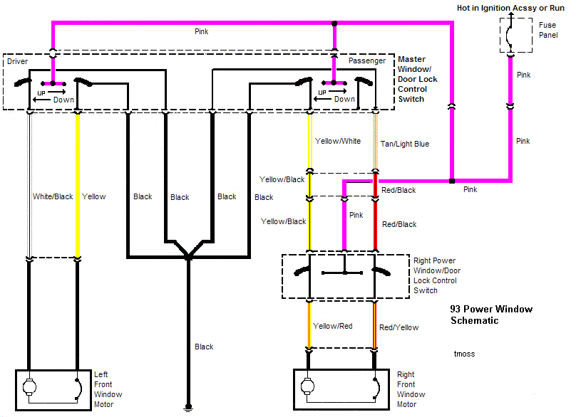

Ok boys and girls here the situation. One day my window on my drivers side started going up and down real slow. Then on the next day wouldn't do anything. I thought it was just the switch. But I pulled it out 2 find a wire melted through and exposed is this the problem or did this fry my switch and what shoudl I do. Any help would be apreciated. The first 2 pics or of the back of the switch and the last 2 are of the wire.

im going to guess it is the problem. it was probably lossing contact when the window was shaking around in the door and then it finally let go. have you tried to reattach it to se if the problem persists?
