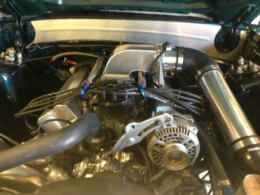

So I did a little more mock up and rewrapped some wires and just general clean up
I know most of you guys can relate one seemingly simple project turns into a long one with lots of mini projects
That tensioner is just for mock up and testi g I will get a SS rod for it later

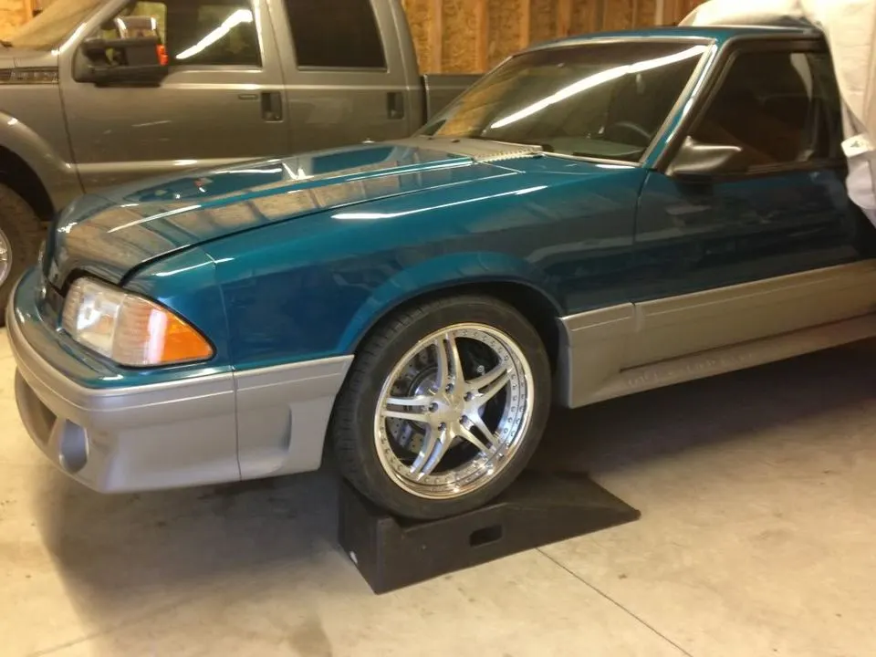

Measure the distance between the center of the tires in front of and behind the wheels. Adjust until they measure the same. This will get you close enough to get the car aligned. Did you set the tie rods up to be parallel to the lower control arms?
