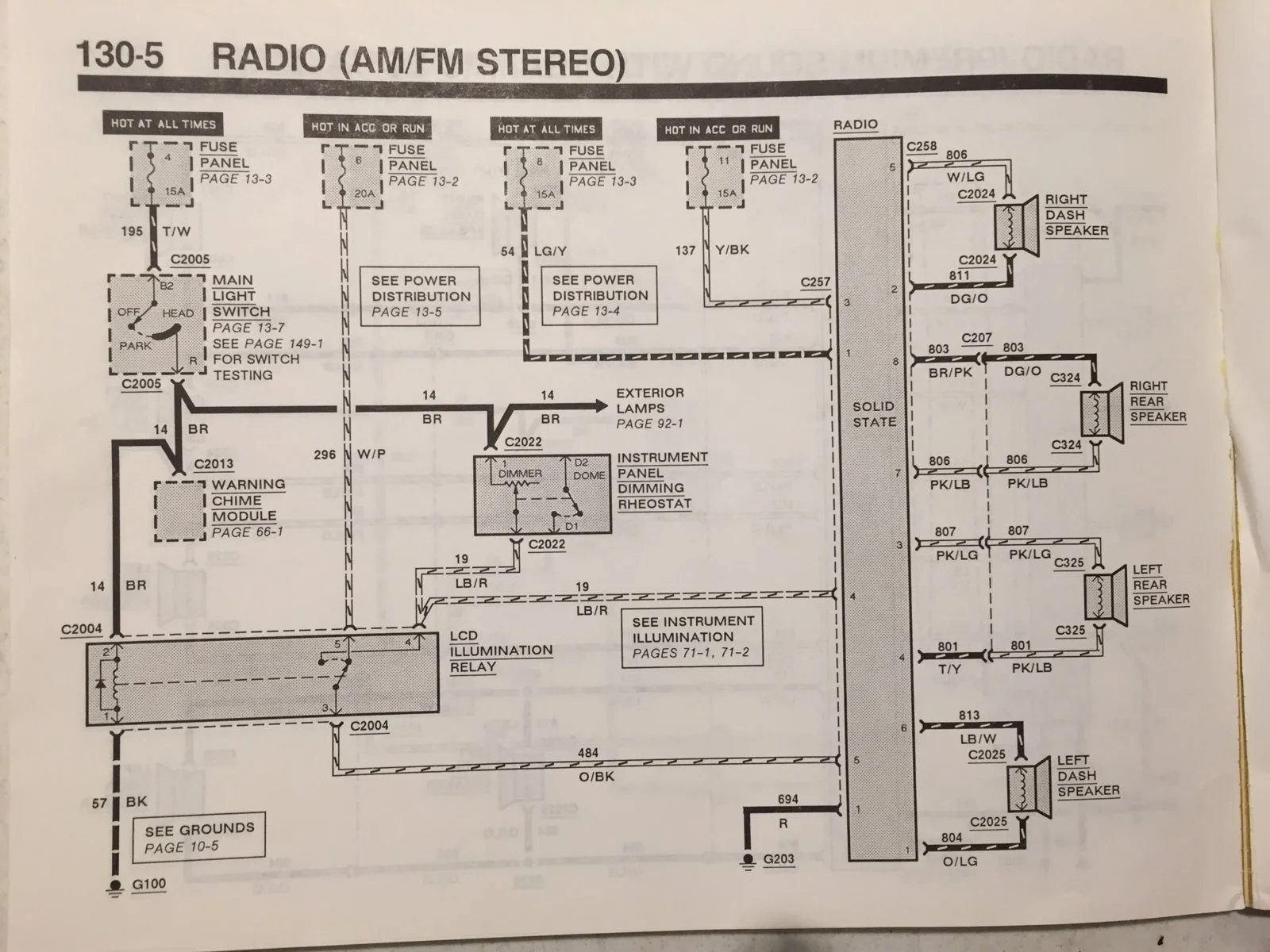

Here are a couple of pics of wiring diagrams that I found. They are for a 92 though.
