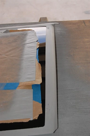

I'm using the same primer and then Duplicolor's Trim Paint. The driver's window is done and I'm working on the passenger window now. Biggest issue is some of the rubber peeled off on the "front" of the window (facing the front of the car) right where the rubber met the glass. I've got it taped off so I can create a straight line but I'm not sure I'll be able to build the primer up thick enough to match the thickness of the rubber. It may take 20 coats or some crap.

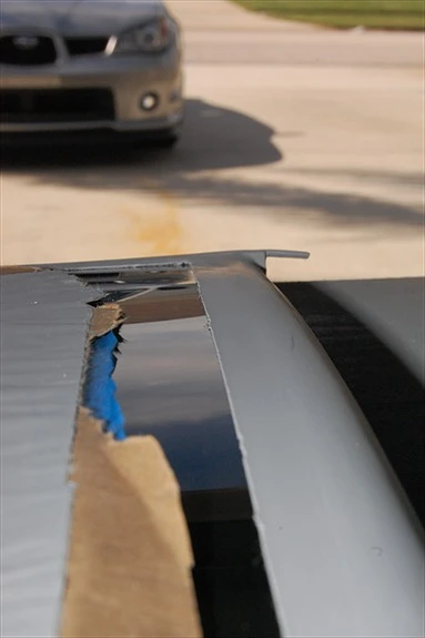

As I think I mentioned before the passenger side window was in bad shape. A decent amount of the rubber had peeled off on the "front" of the window (the edge that faces the front of the car). I taped off the line where this rubber should extend to, and started shooting coats of filler primer. I'm still nervous how it's going to hold up but it's better than what was there before. Paint, sand, paint, sand, paint, sand, paint, sand, etc. nearly all day yesterday.
I've finally got this portion of the molding built back up to look like it should be. The primer was getting so heavy that I couldn't see the tape line anymore, so I removed the tape, cleaned up the edge, and then laid down new strips of tape in order to finish off the remaining coats of primer. You can see a blemish at the bottom and the top I'm still trying to get perfect. Hopefully I'll be painting these windows over the weekend.
Before I cleaned the edge up.

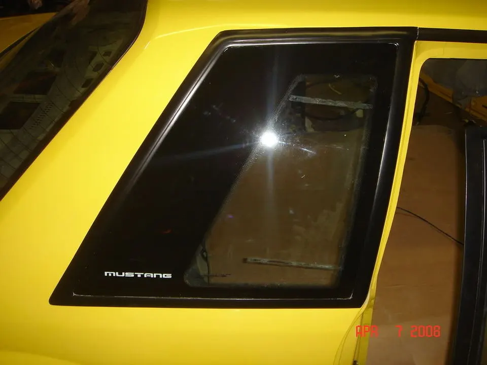

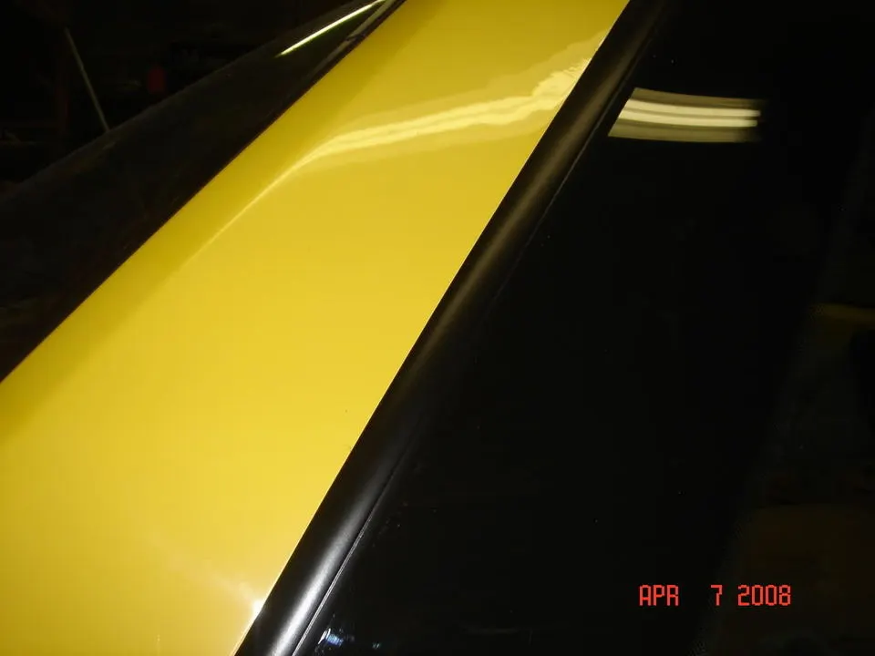

Pictured below is the 2nd set I did. Sand, Nason 2k Urethane primer...basically only two coats because it's a professional prodcut, lots more sanding, then trim black and low luster clear coat. These held up great. The 3rd set I did I used teh same method and got the same result.
From 2008
My yellow car from 2008
