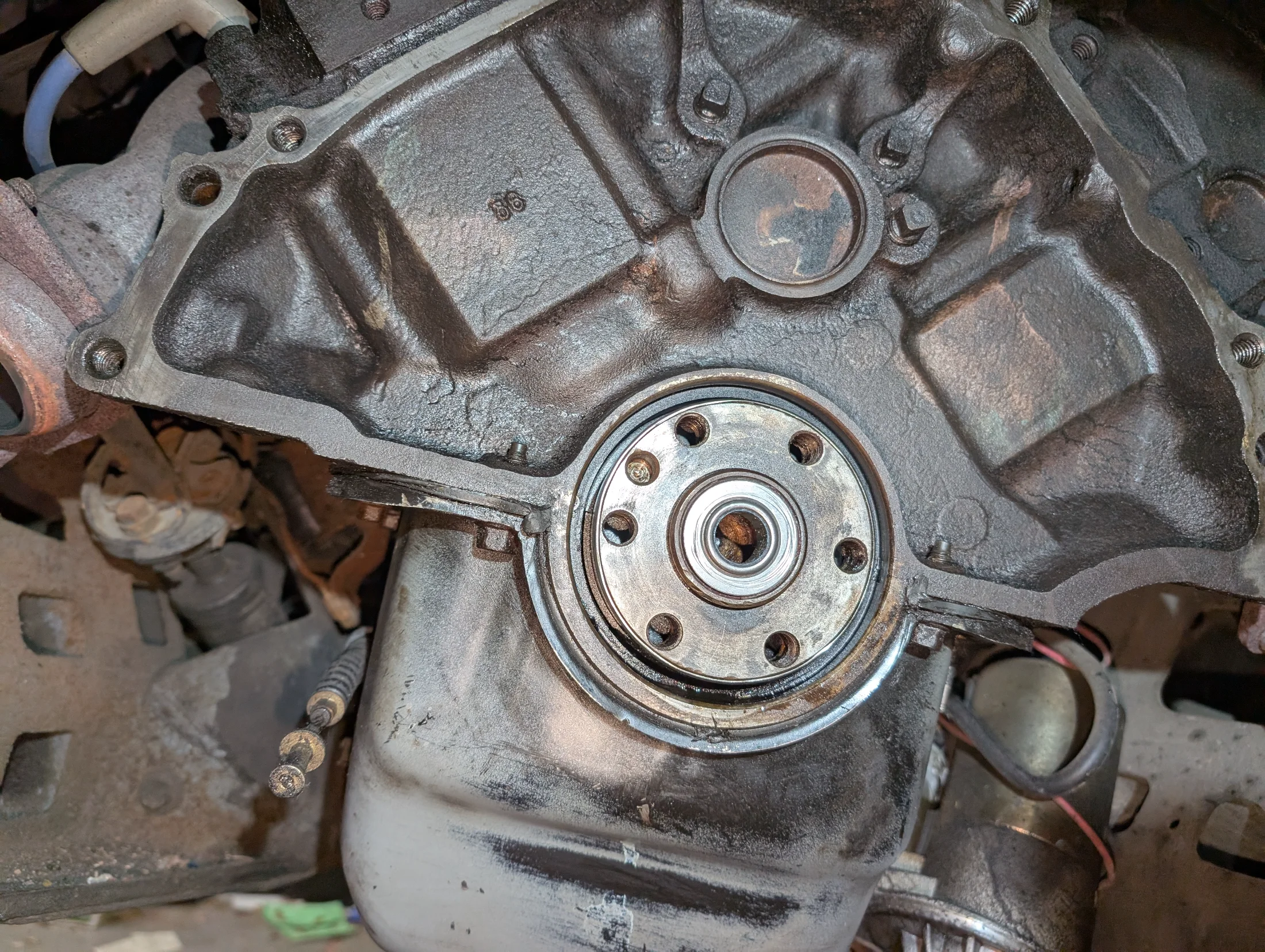

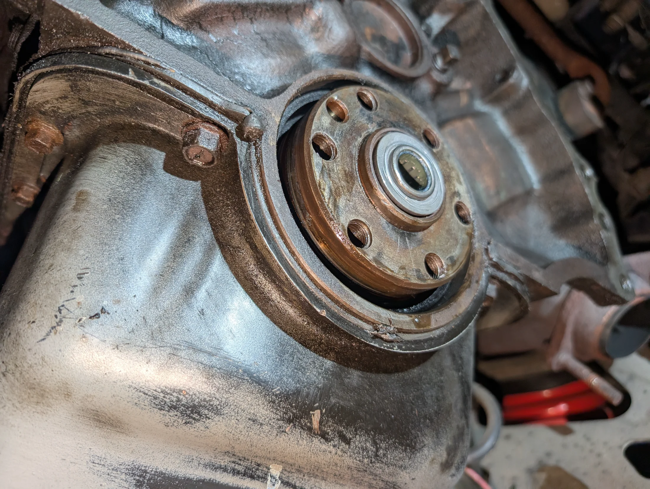

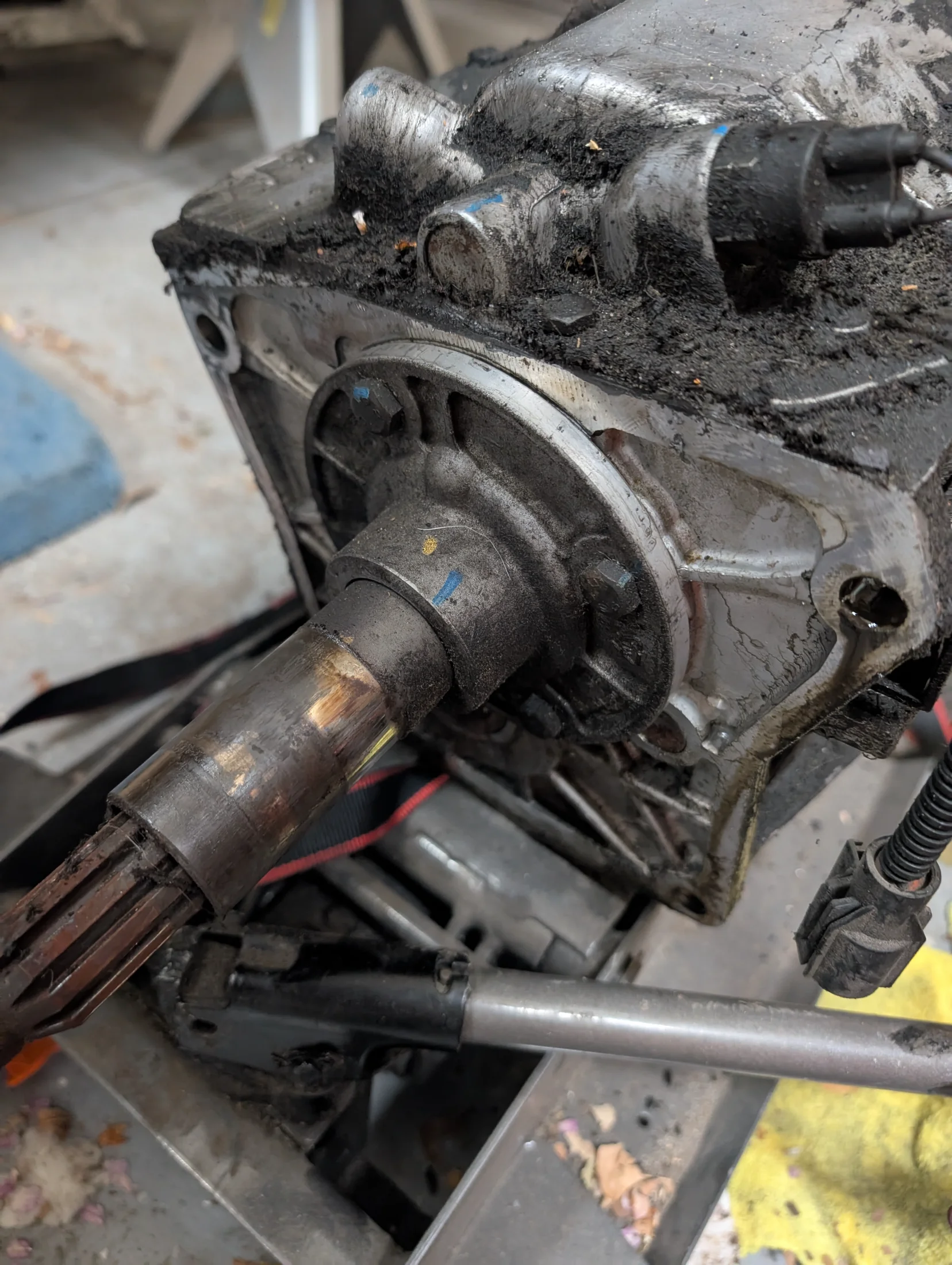

Noobz347 said:
You should swap the bearing retainer. Yours looks like ass in the image.
I don't recall it being very hard.
It all looks like ass right now.

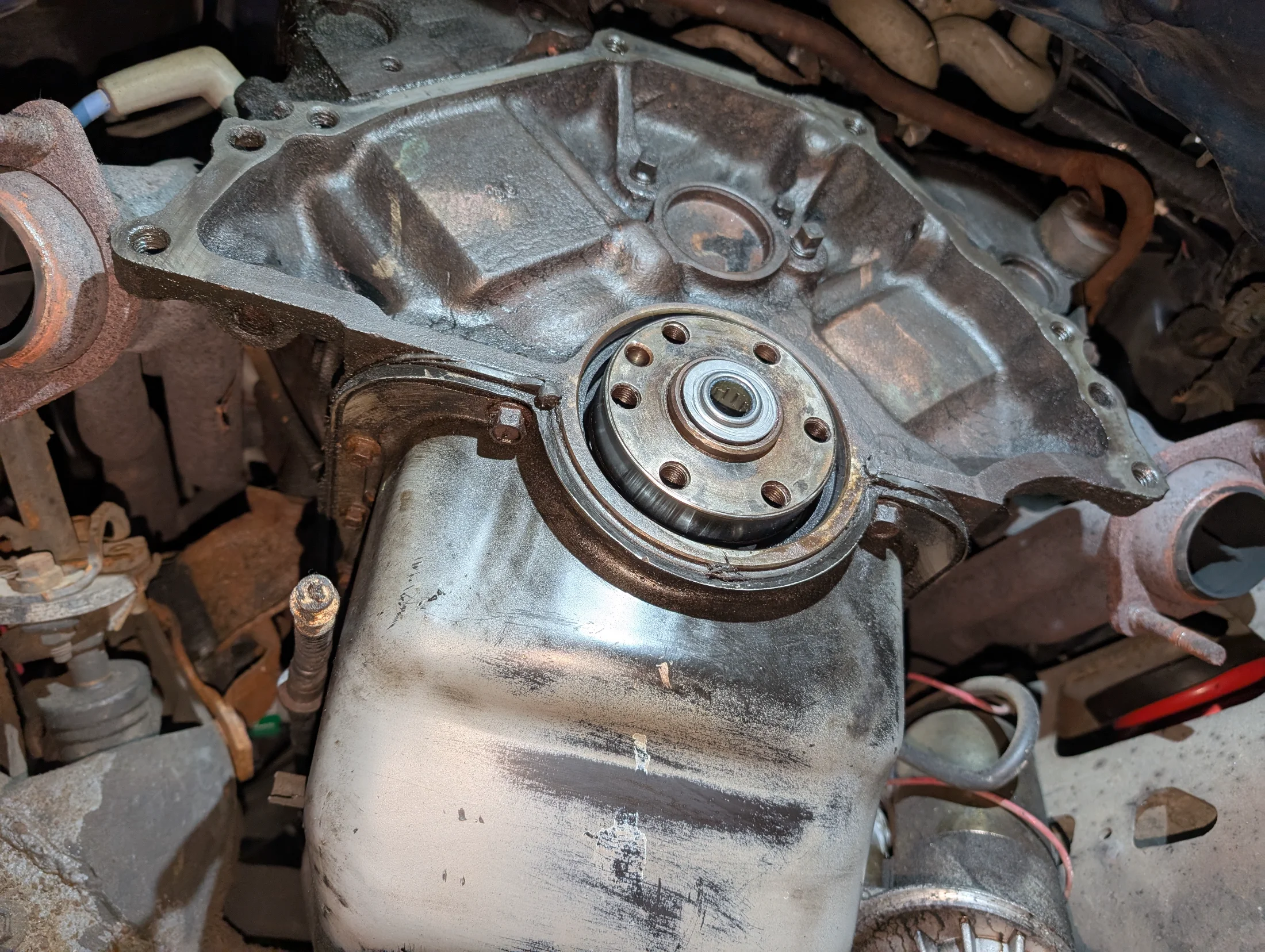

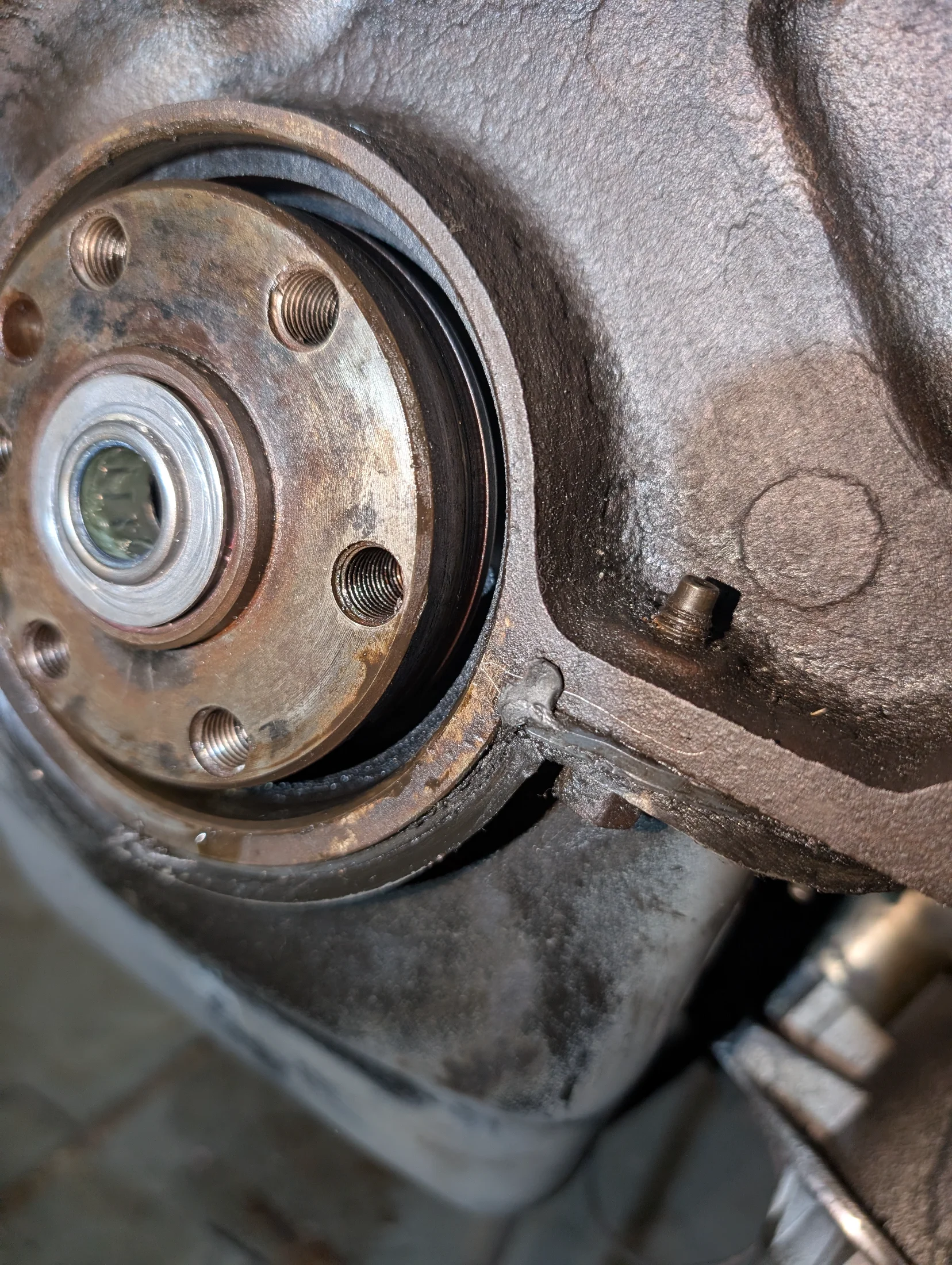

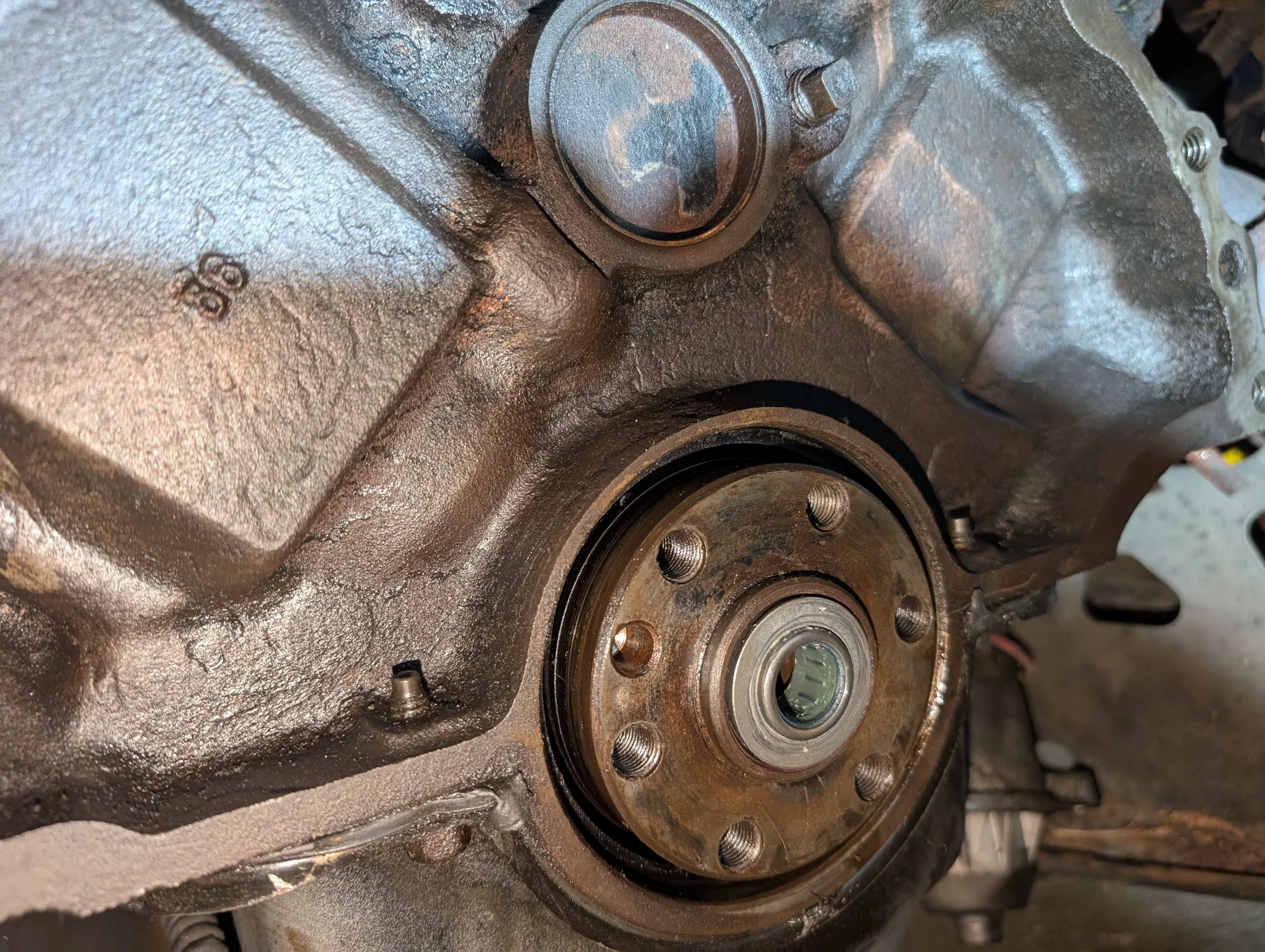

It's covered in oil. Needs a good cleaning. Imma see what it looks like after before spending more dollars.

And yeah. There's a ¼" of compacted oil on the housing. s dirty, yo.

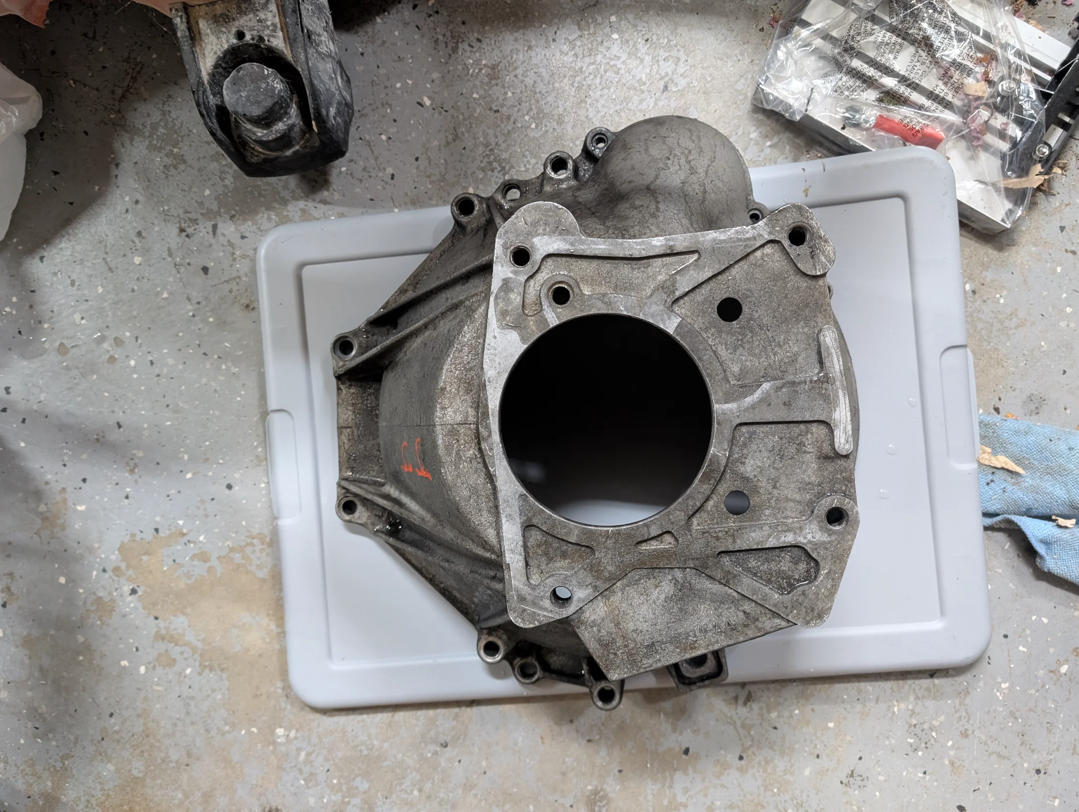

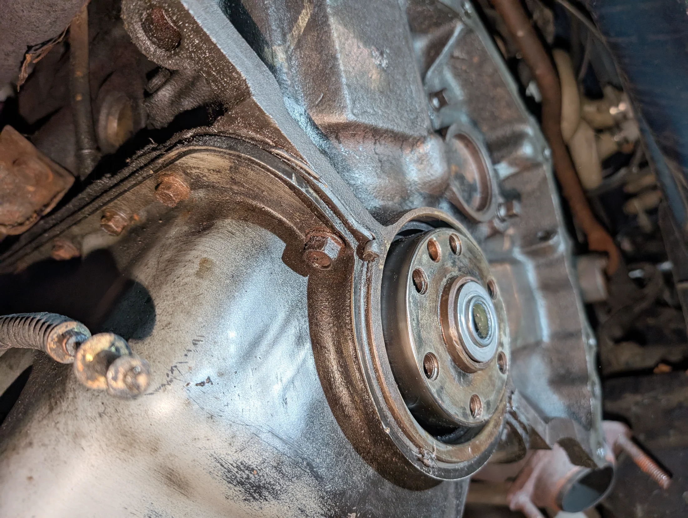

Car wash pressure washer did a pretty good job on the bellhousing. Still some areas I need to hit with the brass brush but it's WAY better.

Oh. And. Sigh.
Ordered a new bearing retainer.

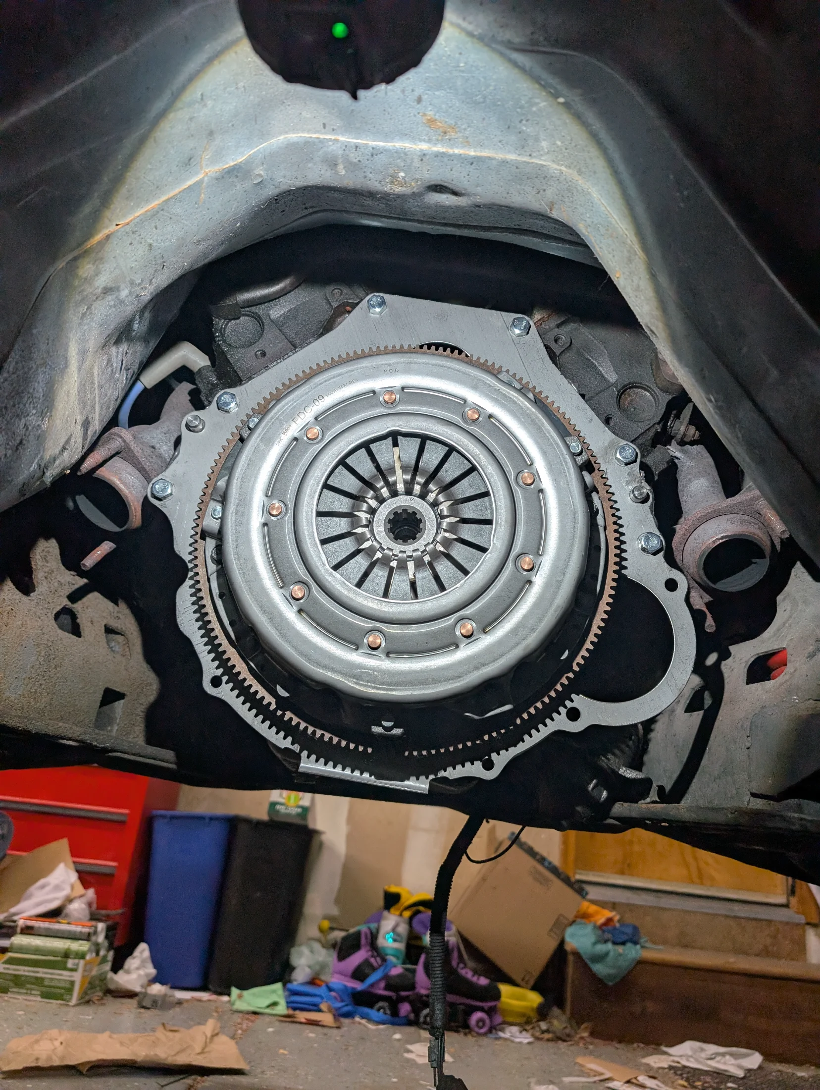

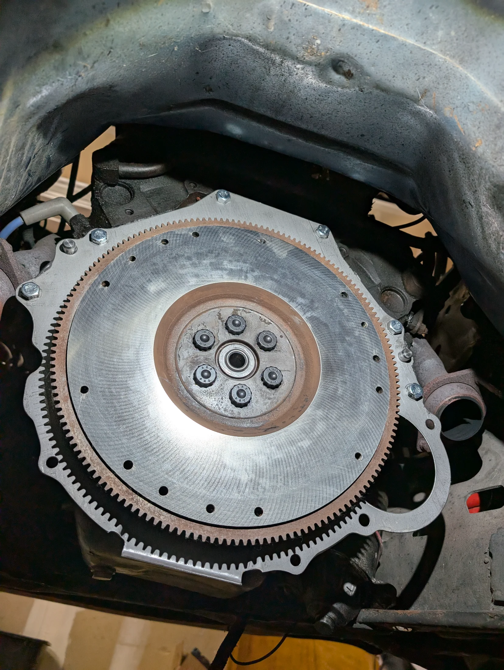

Blocking plate and flywheel installed. New ARP bolts torqued to spec. I RTVd the plate to the block. Picked up some ¾" bolts to hold it temporarily while the RTV sets up. I figured that'd make it way easier to install the bellhousing and put some extra schmuts behind the back of the oil pan.

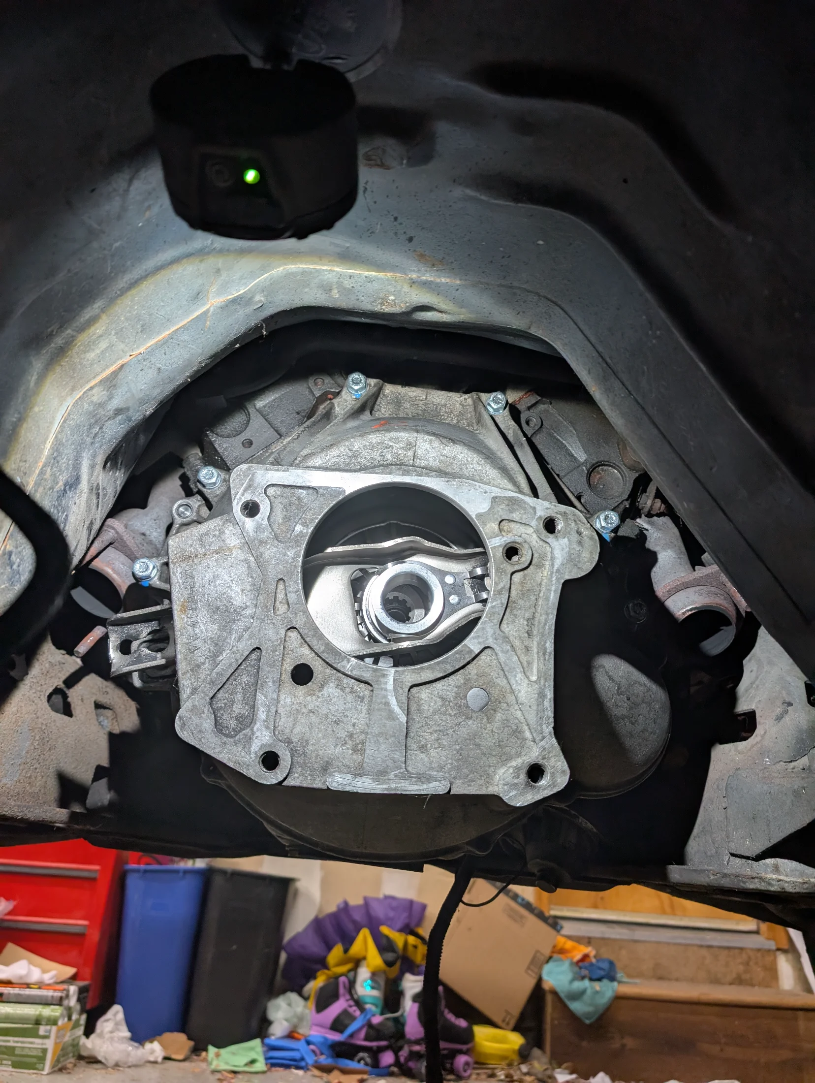

One more thing back together.

Bellhousing installed and torqued. I figured that'd make it easier to cover with canvas and protect everything while welding the floor.
Check for index/runout?
Did you put the friction plate in with, "The Tool"?

This isn't my first rodeo. Hah.

Everything went together perfectly. The throwout bearing looks wonky because I slid it all the way to the inside of the retainer so it'd stay in place while I did everything else.

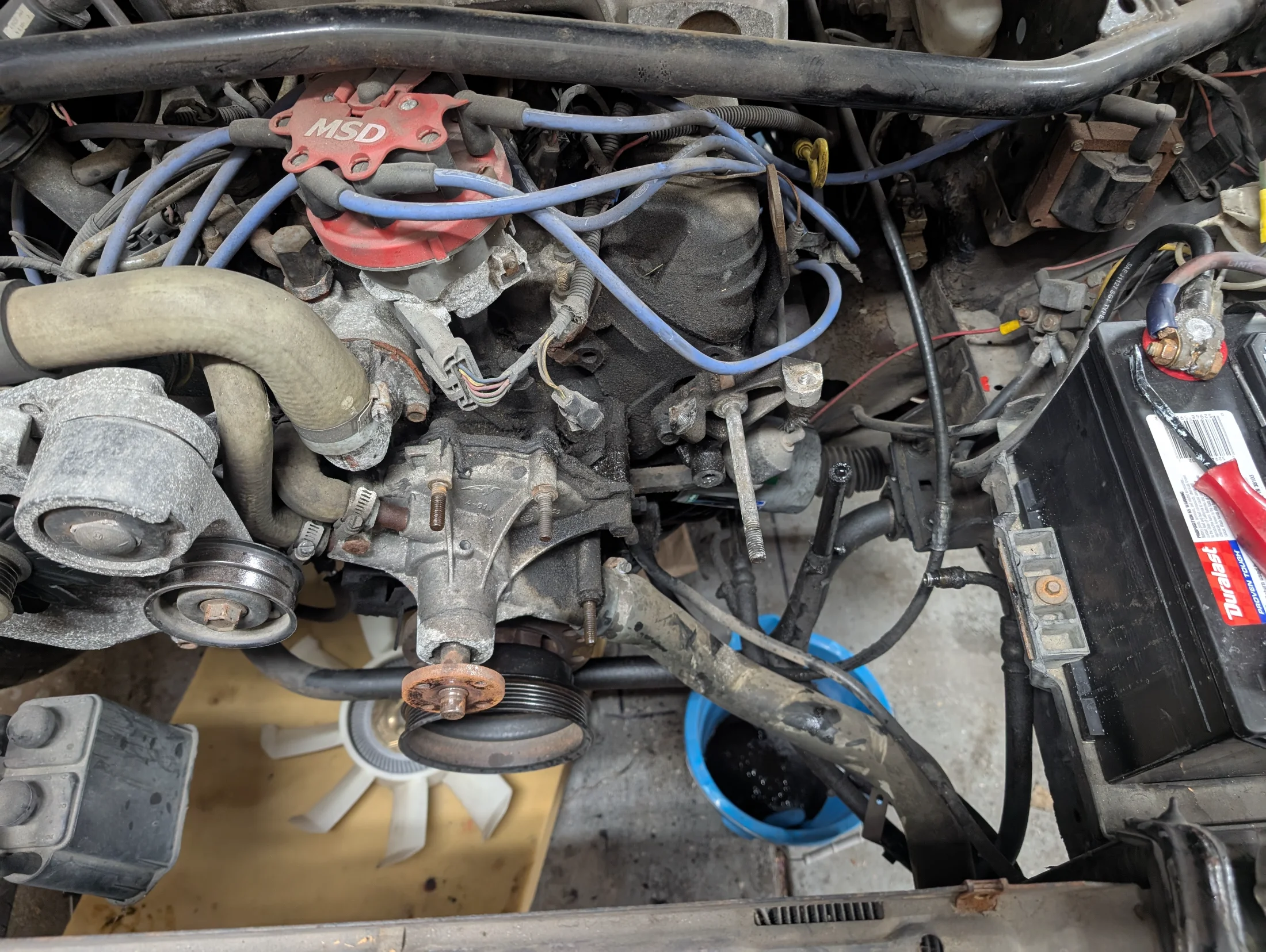

Pulling stuff apart. The cooling fan was straight cracked in half but still on the clutch. The power steering can't leak if it's not attached. Haven't opened the cooling system yet. Trying ot hold off on that till the new shows up so I can do the radiator and AC condenser at the same time.
