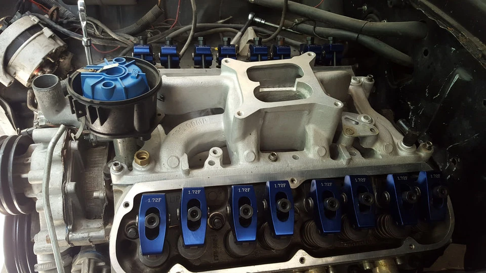

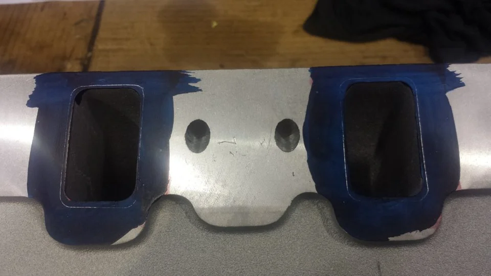

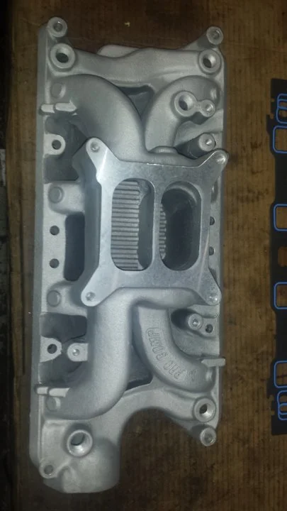

After many attempts at finding honest info about this manifold turned up almost nothing but "Don't buy the Chinese knock-off, it's un-American!" posts, I bit the bullet and bought one anyway. It was a question of money, as most things are, and I couldn't afford to pay Edelbrock prices if something similar was available for cheaper. I am sure there are many of us out there in that boat, so I am posting pics and my thoughts on the product I purchased. I bought it off Ebay from speedmasterusadc for $148/free shipping. It took about a week to get it from California to Atlanta. Anyway, on to the manifold......

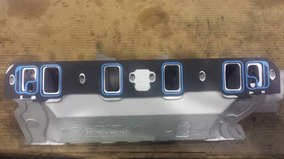

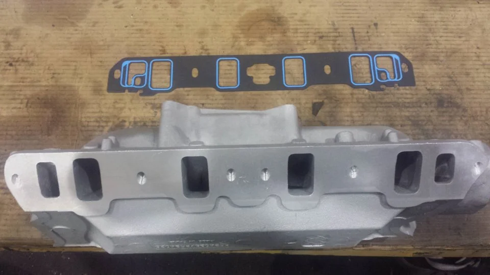

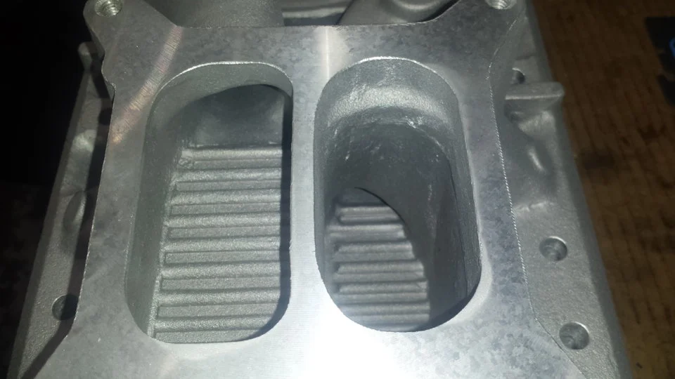

A few of the actual informative posts I found stated lots of casting flash. I didn't find this to be the case. The machine work seems to be adequate and it looks like it will bolt on without an issue. I went ahead and ran a tap through all the tapped holes to be on the safe side and did cut some material in a couple holes, but it didn't seem to be major. I have unported Twisted Wedge's on my engine, so I went with the FelPro 1250 gasket and gasket matched the intake. There was plenty of material to work with and my die grinder and carbide burr made pretty quick work of it. I also milled the center divider as the Eddy looks to have that feature. I cut it about .500 down on the short side, milled it horizontally to the deck roughly 2 inches long. I don't have the measurements with me at the moment, but going from memory, the ports measured roughly 1.10 x 1.85. (I will double check later and update if this is incorrect.)
Without further ado, the pics I took.....

Although I still haven't gotten the Cobra back together yet, I figured I could post a couple pics of what I did before the accident. Someone on the Fox forums was asking about the seller Speedmaster which prompted me to dig this thread up for reference.

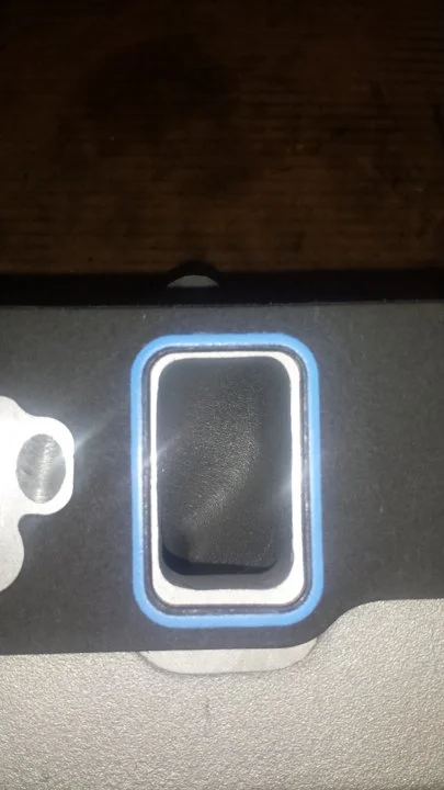

Here are my roughly finished ports. They now measure about 1.2 x 2.0. Looks like I will still have to finish them.....

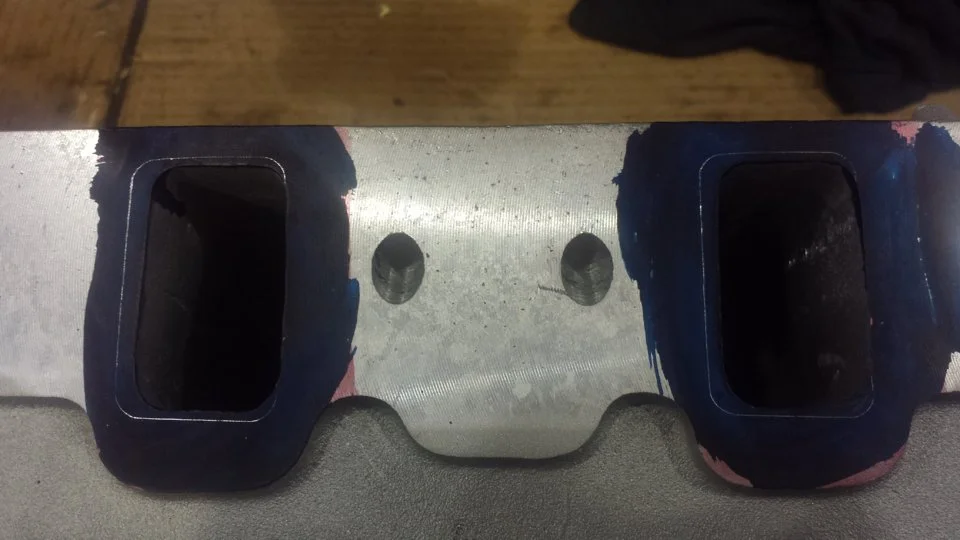

Here is the milled center divider:

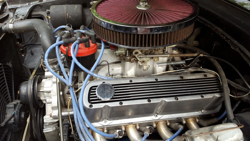

Ok! After some miscellaneous stuff: troubleshooting the 87 GT, cleaning the car port and working a little on our basement kitchen/bar among other things.... - I can finally conclude this thread! I've been fighting with the 302 trying to get it to run right after putting everything together and have mostly got it nailed down. When I tore the engine apart, I didn't mess with the distributor, so I've been leaving that alone until today. Long story short, the timing was WAY off! I had to have done it when I had it together the first time. But anyway, on to the manifold.....
I've only driven it maybe 3 miles since getting it to run right, but so far I believe it to be a superior performing product than the Offy 360 I had on there to begin with. It seems to have a little more grunt down low, as one would expect going from what is basically a single plane to a dual plane. There were no fitment issues what-so-ever, my Holley bolted to it just fine. One thing of note, there isn't a lot of vacuum ports to attach to, so a vacuum tee would probably be a good thing if one were in need of different vacuum connections. I haven't noticed any leakage around the coolant connections either. I also don't believe it to be a bad looking piece! The only thing giving away that it is a cheap knock-off is the "Pro Comp" imprint on the runner. So, all around first impression of this manifold: I believe it to be a good buy! :nice: Especially if one were looking at experimenting with port work or machining different areas since it is basically an Eddy RPM Air Gap for quite a bit less money.
Gonna revive my old thread about this manifold.... :D
I was leaving a show (spectating only) and had to make a U-turn on a 4 lane. Once I got around the median I punched it, then shifted to second gear when the car decided to try and go sideways on me. It never did that with the Offy - it would go, but not like that!! The only thing I did to the car this year was took my carb back to stock jetting and installed a power valve that was appropriate for the vacuum the engine was producing, It was probably a combination of the 2 things (the carb and the intake) why she seems to have picked up some grunt. I'd really like to take the car to a dyno tuner and let them have a hand at the carb since I know it's running rich, but there are too many irons in the fire right now to worry about that. Unfortunately I wasn't shooting a video, I had the stuff with me, I just opted to not do it since it was a decent distance from home. Some day.....
