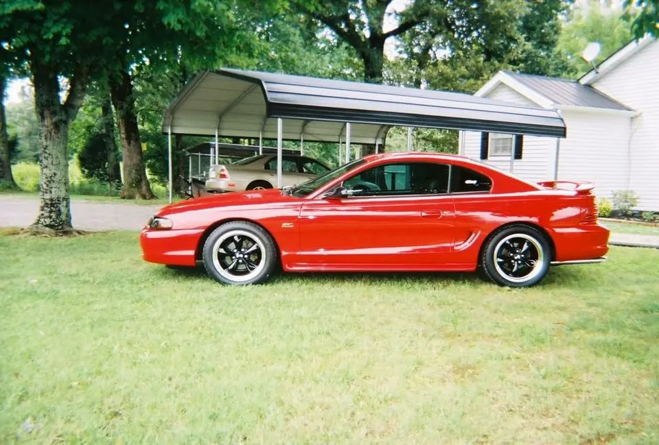

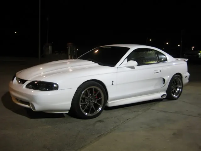

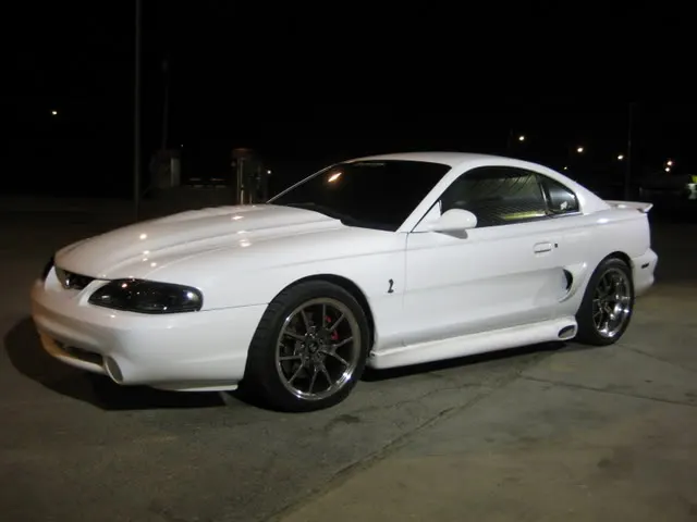

i personally think that the sportlines would be fine... i am running them as a daily driver, durin the summer with the 18s theyre wonderful... winter i run my stock tri bars and they handle just as well.... 2inch drop in the front, so to each his own....

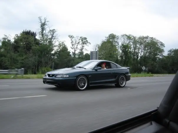

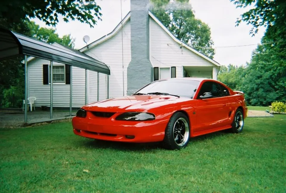

i run the sportlines on my 95. from what i have seen, they are lower than the pro kit but you usually get the dreaded sportline sag :( . ride quality is decent. definetly can feel the bumps but isnt terrble. i have some pics but cant post them now because of works firewall :rolleyes: . i'll post up later

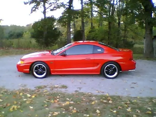

I run the Pro kit. I switched from Bullits since I don't drive the cobra daily anymore. If daily drive, I would have stayed with the bullitts. For me, any lower than the Pro kit is too low. I have a vert and the vert brace sits really low.

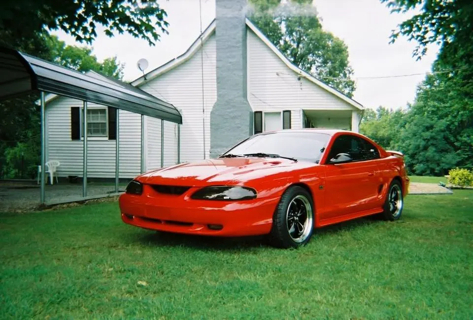

Here's the Prokit (stock spring isolators reused - I mention it because that's important to know when viewing pics). Sorry for the small pic - there's a size limit with my account:
I have an aftermarket catted H and it scrapes occasionally - I dont know if I could do a lower spring with cats (just something to consider). I really like the ride with HP's (a nice budget-ish combo IMHO).

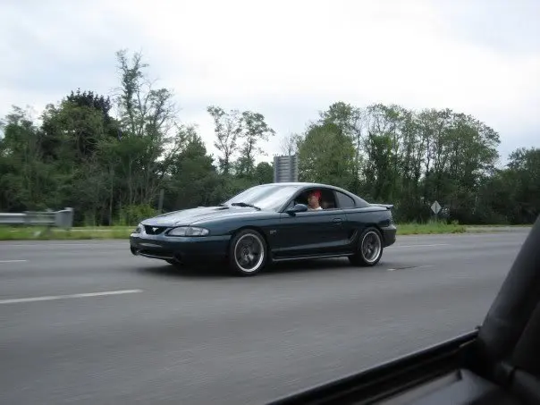

For comparison, here's the pic Inphiniti posted:

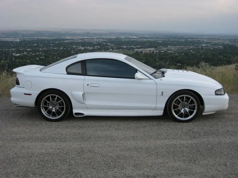

.....sportlines [in front, Bullitts in the rear].....
i forgot to add... im currently only running sportlines up front... im running the springs that are normally in the Bullits in the rear... it was only a .5 drop which helped me clear with bigger and beefier tires... failed to mention that... :D

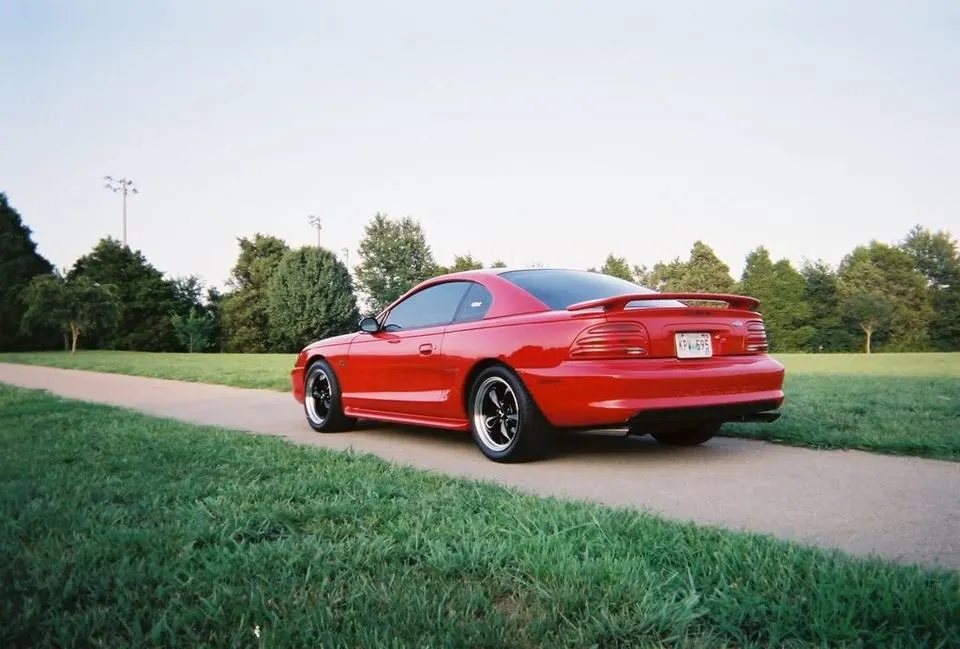

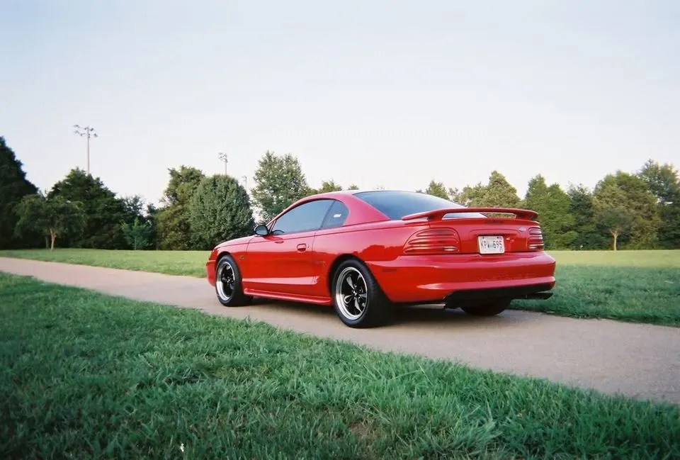

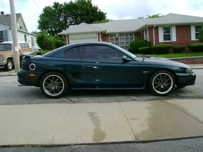

eibach sportlines
latest pic, wingless and no covers. i think i like it. the wing is black now tho

I have owned Sportlines and they were not too bad as long as you keep the factory shocks.. When I went to Tokico blues the ride became much more stiff.. Pro kit barely lowers the car at all.. I have pics of a prokit 98 gt on my puter somewhere, (my buddies dads car).. He eventually lowered it another 1/2 inch with steeda x2s.. MY sportlines on my GT ride better than my stock 97 explorer if that helps, lol..

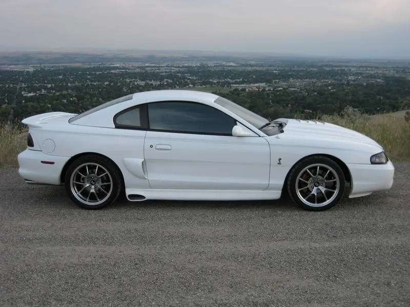

i have heard of this...just swapping out the ball joints for the x2's will drop 1/2" ? i want my front to drop about that much. if this works, that would give the exact stance i want
I also did the balljoints.. I DO NOT RECOMMEND THIS SWAP UNLESS YOU HAVE A TON OF PATIENCE... swapping the Balljoints was the most frustrating thing I have ever done on this car, and I've done EVERYTHING myself....

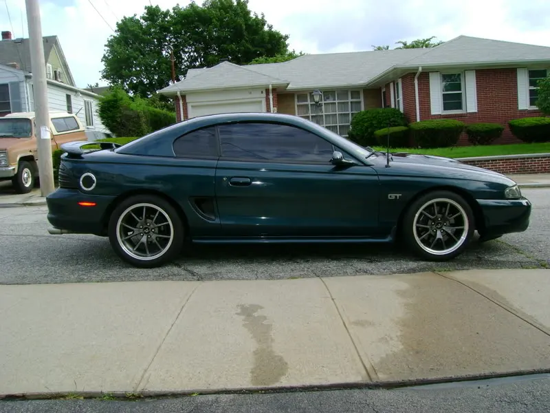

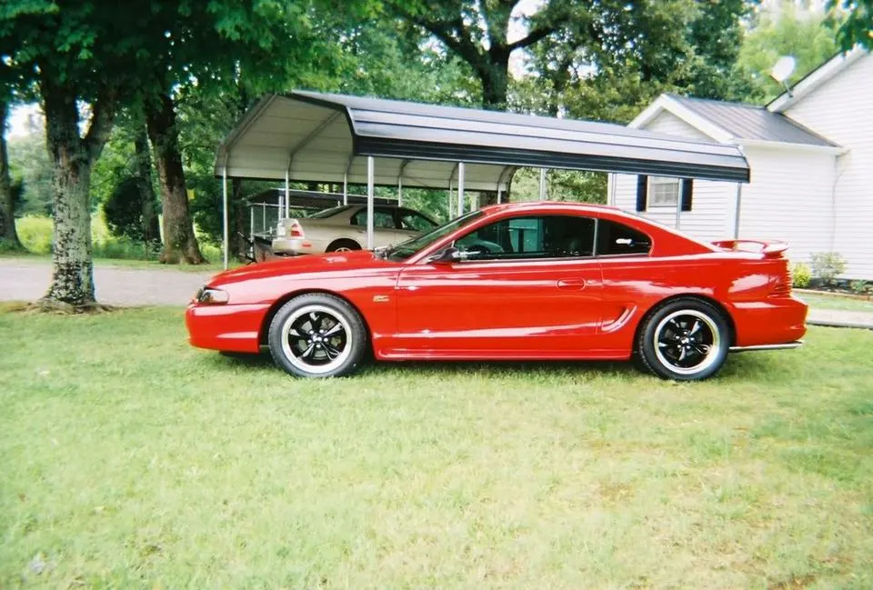

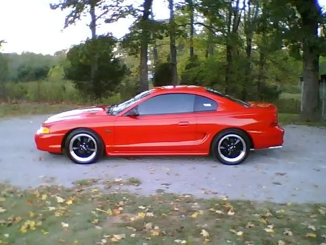

My stance after x2 balljoints, no isolators, and bbk springs (which are relabeled eibach prokits, I think)
