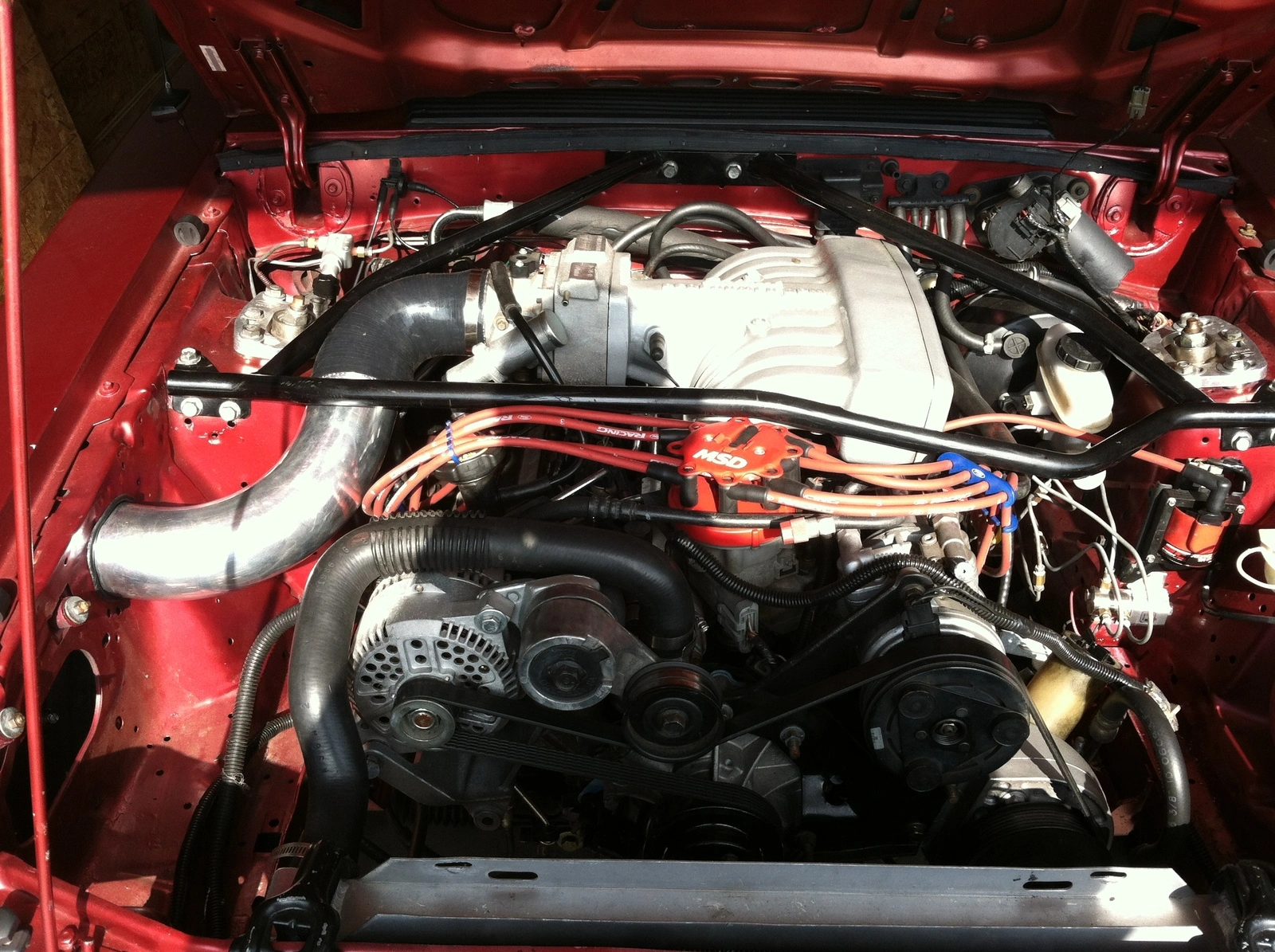

Hey guys,
I just installed a used Pro-M 80mm meter and filter on a home made power pipe, calibrated for my injector size. I am now getting an intermittent CEL that only comes on after a pull the rpms up and let the car pull the motor down (coasting after a pull). I have two theories:
1) The meter is no good
2) I am short one worm clamp and the intake tube is just slid onto the pipe until I can go by one (just test driving it right now). Could unmetered air be getting pulled in on the coast and causing the light to trigger?
I have pulled the codes, but they are all smog equipment related, and its all deleted, so that is expected. You can see where the clamp is missing in this picture.
Thanks for any help!
Joe

Recheck all electrical connections for a possible intermittent connection. Splices should soldered if any.
Look for codes associated with O2 sensors being out of range.
Recheck all vacuum connections since deceleration is when vacuum pulls most.
I took the maf back out and cleaned the sensor. I also cleaned the connectors and tightened down all the clamps. I went for another ride and it started doing it about the third attempt. Then, after just a few times of doing it, it stopped. I tried about a dozen times to make it happen again, but no CEL. I have four codes. They are all emissions related, and have always been there. All vacuum connections are good. I'm hoping that the computer is just having to learn the new meter????
Going to take it out again when wife gets home. I'm not too optimistic that I am out of the woods yet.

Reclocking the meter a few degrees can sometimes help smooth out the inlet tract as well. I've seen that make a difference a countless number of times. Only applies if you've not already tried it.
Still haven't got back out to test drive yet, but I did finally find an old thread on coral where someone had the same problem. He was actually datalogging and said that when the throttle blade shut, the engine was still pulling air past the throttle blade and causing a lean condition. He said that it wasn't lean enough to really do damage, but enough to trigger the light until the computer could fix it and richer it up. If this doesn't go away, I'm hoping a tuner can compensate with more fuel and correct this. We will see.

I went for another test drive today. I am positive its a lean condition. When the car is warming up, in closed loop (I understand that the car runs rich during this time) the light will not come on. Once the car reaches operating temp and goes into open loop, it will trigger the light under the decel conditions that I described above. I can override my electric fans and actually bring the car's temp way down by letting the fans run nonstop. Once the car gets really cool, I am assuming enough to throw it back into closed loop, the check engine light goes away again.
I pulled all codes, both KOEO and Key On Engine Running. Just so you can see, here are my codes, all emissions and evap canister related (gone when I bought the car, and these codes are always present).
81, 82, 85, 84
94, 44, 33
I have always heard that the C&L's make your car run rich, and I guess this is the case. Again, I am assuming that when this car gets a tune, more fuel can be added. Am I wrong about this? The car runs way better with the Pro-M and does not appear to be down on power at all.

I talked with a tech from Pro-M. He asked me to measure my voltage at 1K, 2K and 3K rpms and email him the results. Here is what I came up with:
1K = .89
2K = 1.30
3K = 1.59
I don't know if these values mean anything to anyone besides a pro-m employee, but I thought I would throw them out there and see if anyone had anything to say. I just emailed the tech, so hopefully I will know something tomorrow.
Joe
Have you checked the maf sensor wiring harness for shorts? Because it's not putting out enough volts if i'm understanding right from the numbers i'm seeing.
