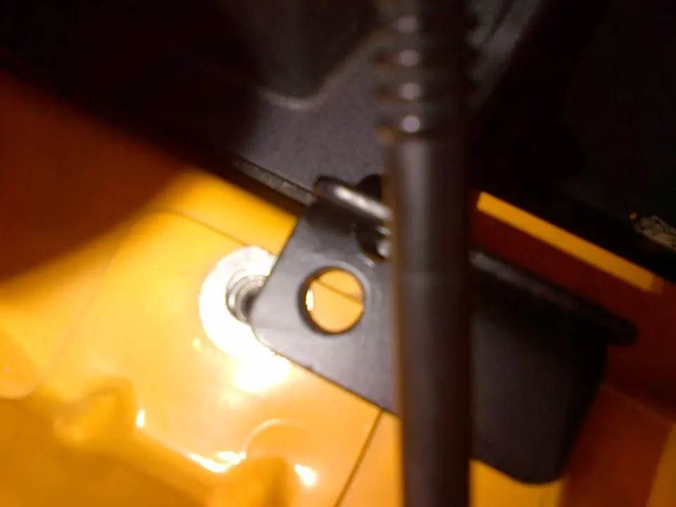

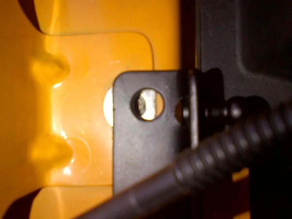

I purchased a set of the black hood gas struts for my wife's 2011 Mustang as a Christmas gift.
I went to install them today for her and was disappointed to find that the fender brackets do not fit. The bolt hole is waaaaay off and will not work.
The bracket appears to need to be about a half inch wider on the dimension that lays against the top of the fender, which would allow the bolt hole to be positioned properly.
I emailed them about this -- We are putting this vehicle into storage this week and need to have this installation figured out asap. Otherwise we will not be able to address until springtime, so hoping the company gets back to me quickly.
I was going to try and elongate the holes to see if that would work, but to me, the edge of the hole would be getting dangerously close to the edge of the bracket and would alter the strength of it IMHO. Not to mention, the powder coating would then be trashed. Not pleased.

Heck, I put on a set for may 2012 Boss and had no trouble at all. I did have to modify a rubber piece on each side but the directions were excellent and showed where to cut and place them. Did you get detailed instructions?

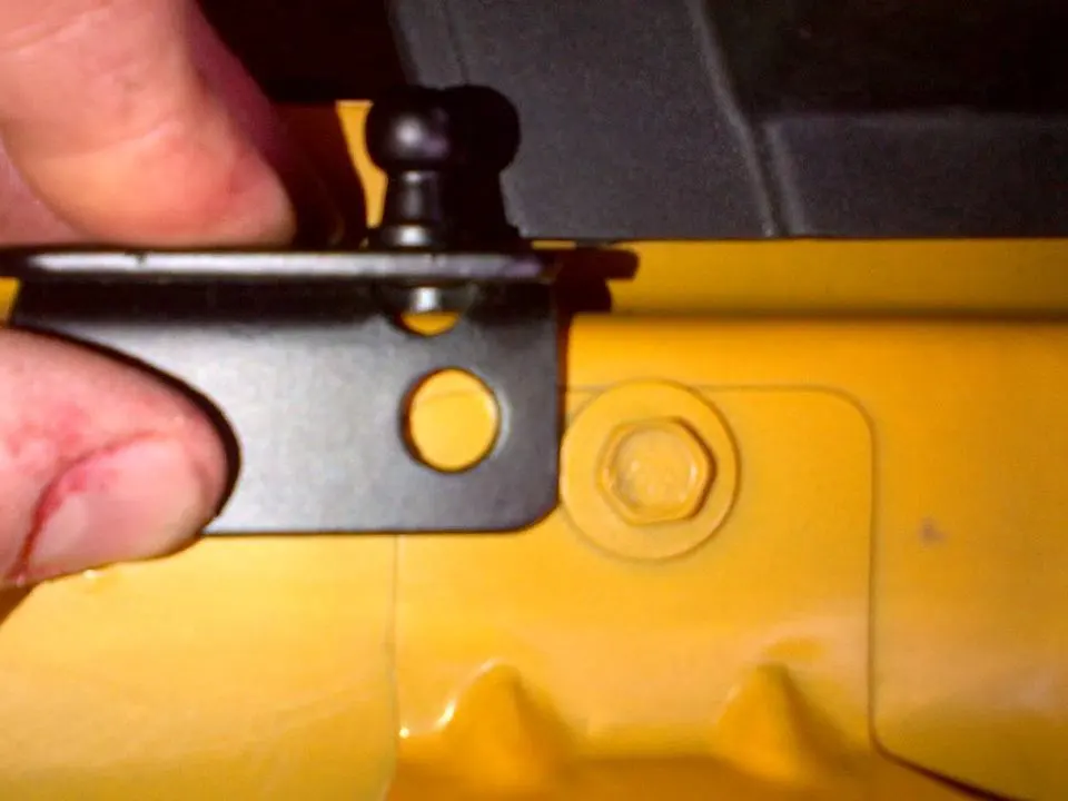

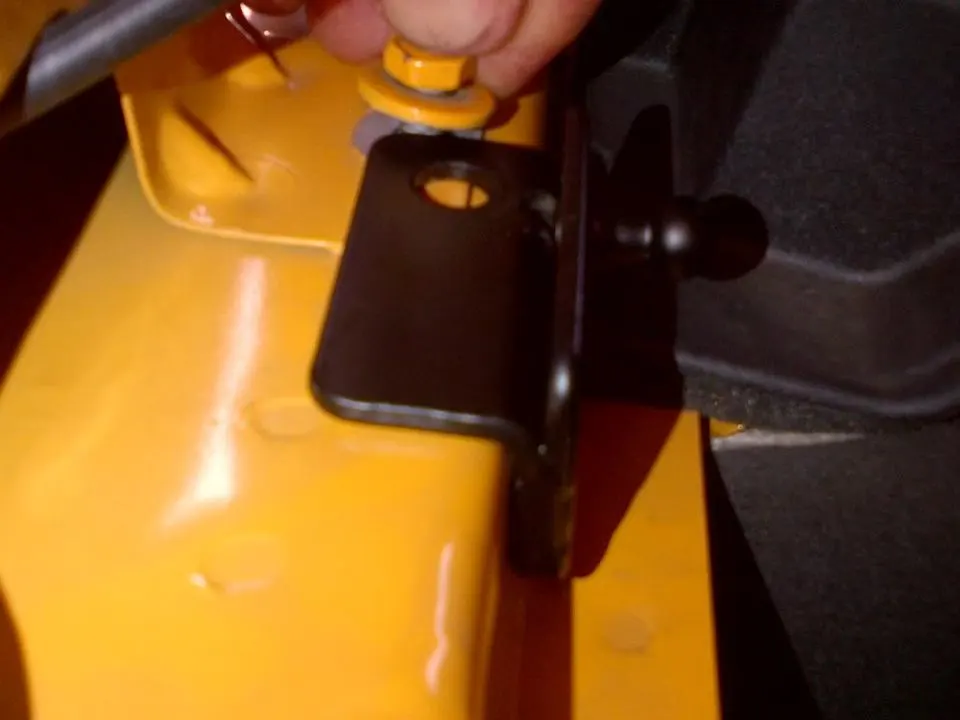

I think you have the brackets upside down.
I've never installed these before but I couldn't help notice:
Are there clearance problems if you flip the bracket over? It looks like it would move INBOARD the required amount if upside down. Otherwise... slot the bolt hole and call it a day.
Just for the heck of it, I looked thru the site too. On the customer pics, most are upside down from the OP's pics but one car was the way the OP has them. Also, pulling up the install instructions, it shows them the same way as the OP has them. All the MRT's that I have done went on like the OP has them positioned. Hmmm....appears to be a discrepancy in the instructions and how most mount them....
We actually have a redesigned bracket coming out for those in a month, because of this problem. Those bolts are for adjusting the fenders, so the tolerances vary. We typically install them upside down, though you can also install them the way you show (which our instructions call for and will stay the same with our new bracket). I believe most of the competing kits also install the bracket upside down from your picture and our instructions. This new bracket should fix all of that, but you can definitely flip them and install and it should work perfectly. We just are building the new bracket for a cleaner install.
We'll have the new bracket in about a month - anyone interested in swapping out for it can PM me in about 4 weeks and I can send them a set! Hope this helps!
If you have any questions in the mean time or if you just want us to refund the purchase, let me know and I'll take care of it. Sorry for the confusion and inconvenience. You'll love them once they're installed, though!
