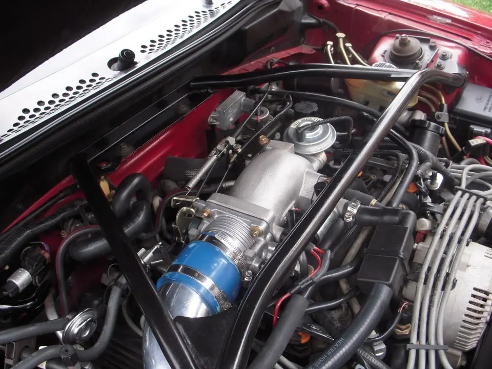

Heres a pic

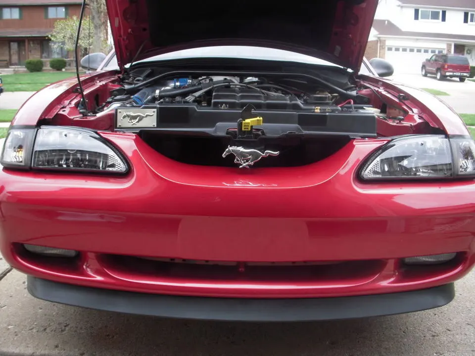

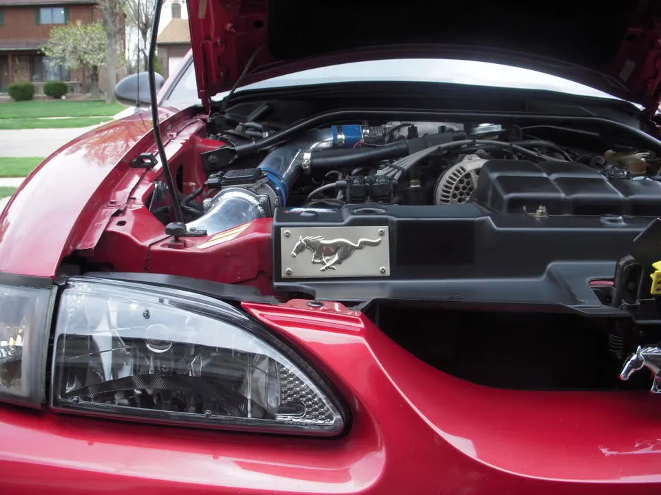

Here is the redneck in me kicking in, maybe i shouldnt have lol but i want one of those polished aluminum radiator covers so screw it
