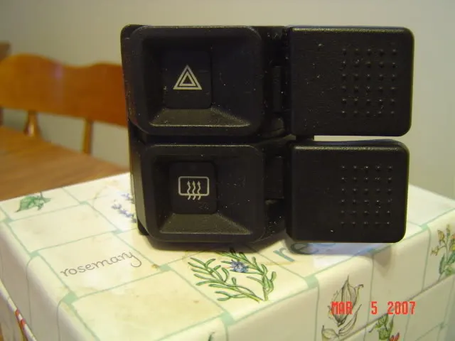

Hey iv been having the same problem and tehn my tranny blew on ym car so i didnt really have tiem to check it out untill last night ... i have read that if you move the dimmer back and fourth you might find a spot that lights the dash lights and i did it and it worked but the dome light stayed on all the time so i just tok it out untill i can fix this problem corectlly also when the lights are on you know how the hazard switch will light green are the other lights suposed to do the same?
and anyone else have a problem with like an amber glow over your mileage?
Red88: the hazard flasher does light green when the parking lights or headlights are on. Mine stopped lighting one day, probably been out for weeks before I even noticed it. There are two bulbs in the back. The one behind the flasher had fallen out and got lost. I got one out of the jy, they do not sell the bulb base anymore or the switch for defroster/hazard lights anymore either.
ya i wasnt sure if the other side lights gren also cause mine dont. and i always wanted to know what was suposed to be under the hazard ha thanks i really need a rear defog but i wont talk about that in a light thread ha
