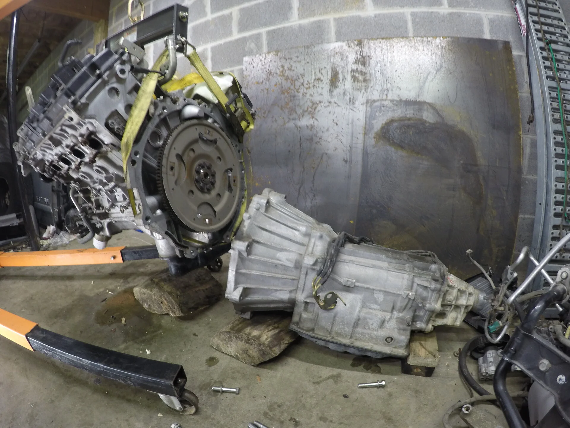

I guess I do have a question. The pic of the engine/transmission hanging in the air is the assembly you've transplanted, correct? What are your plans for the transfer case section? Do you have a bead on a 2wd transmission to at least replace the tail shaft housing? Or do you plan to make it a 4x4? Please say no, please say no, please say no.... (@MustangIIMatt will know why I say it that way. :rlaugh:)
No 4x4 lmao . I replaced the tail shaft housing with a 2wd version

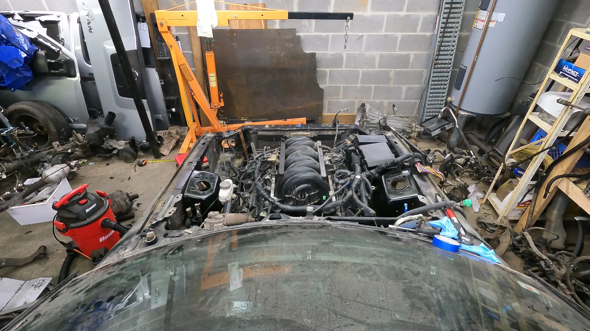

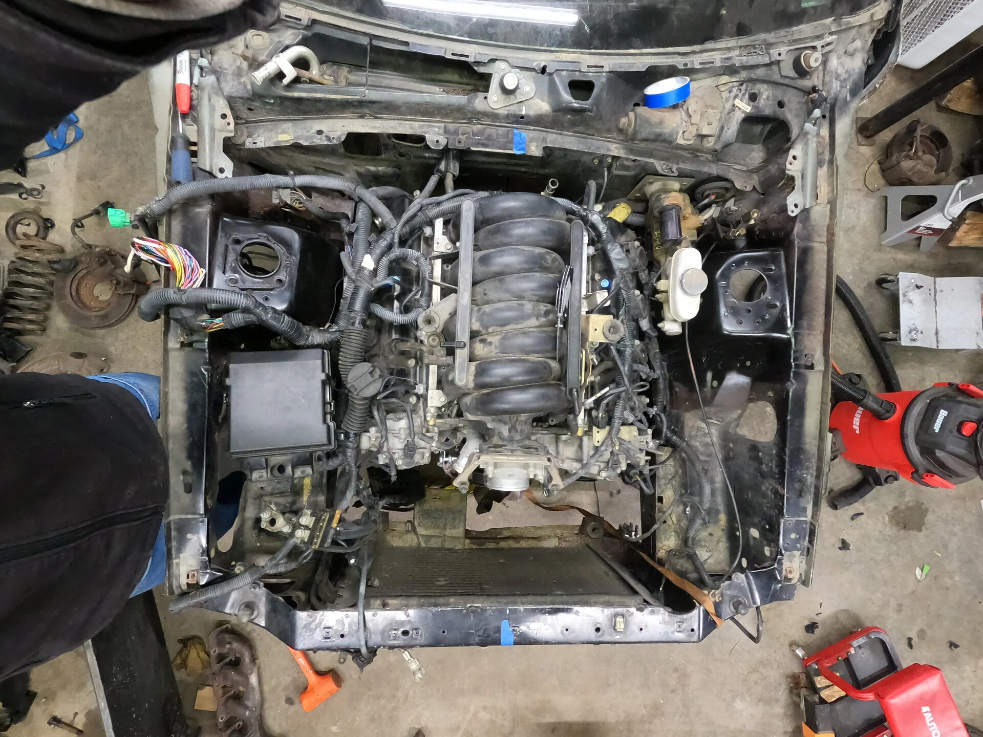

More random pics. I need to take some more but I broke the camera lens on my phone so I have to take them with something else and upload them :doh:. More to come though!

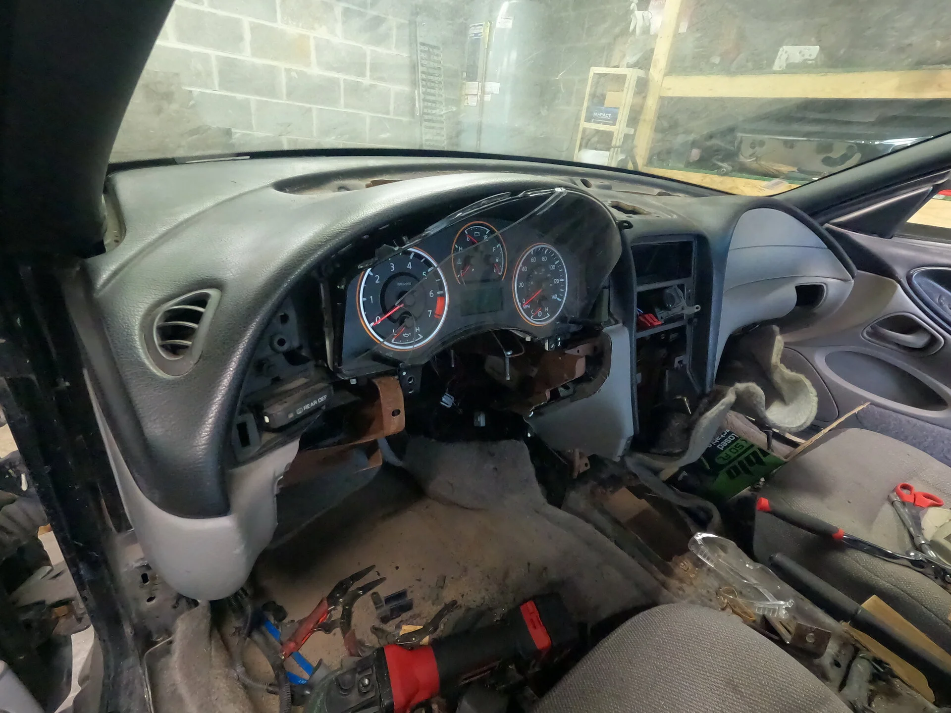

Looks like that gauge pod is almost the perfect size, just a little trim around the brim. Dunno what you'd have to do about the clear cover though. Maybe you could get some clear plexi that would be flexible enough? :shrug:
