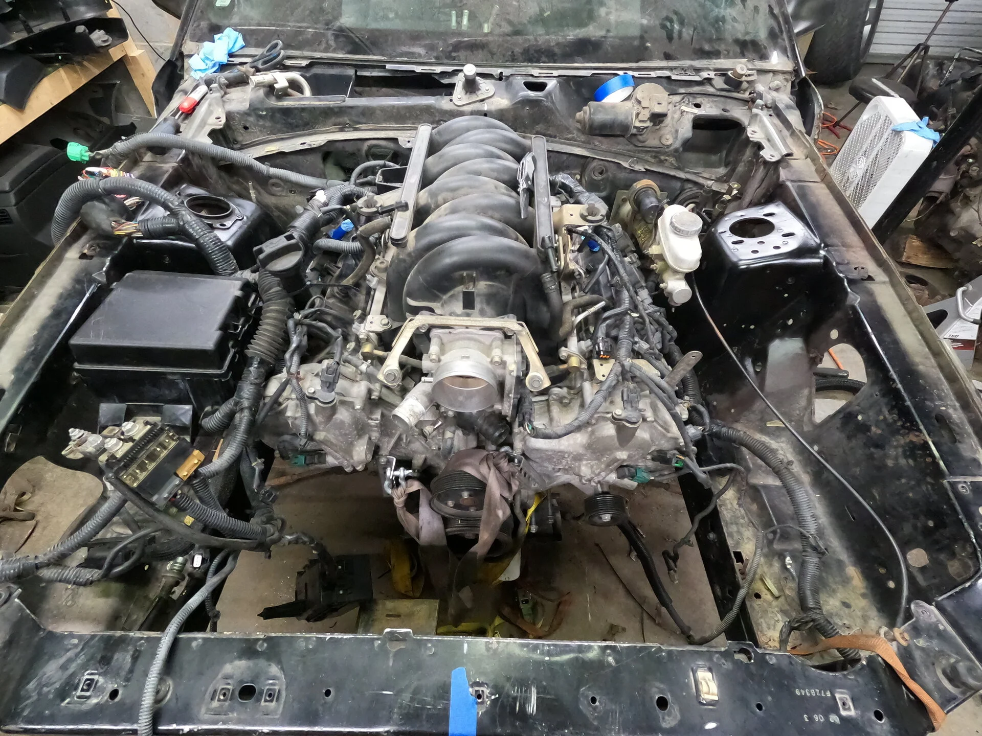

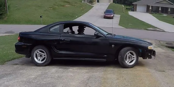

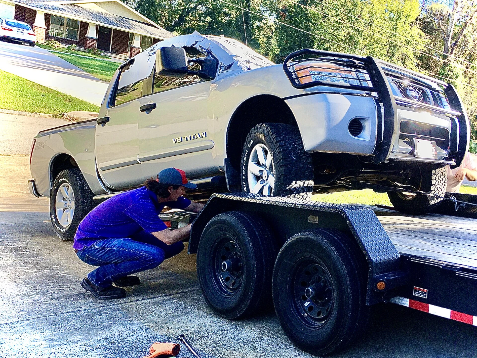

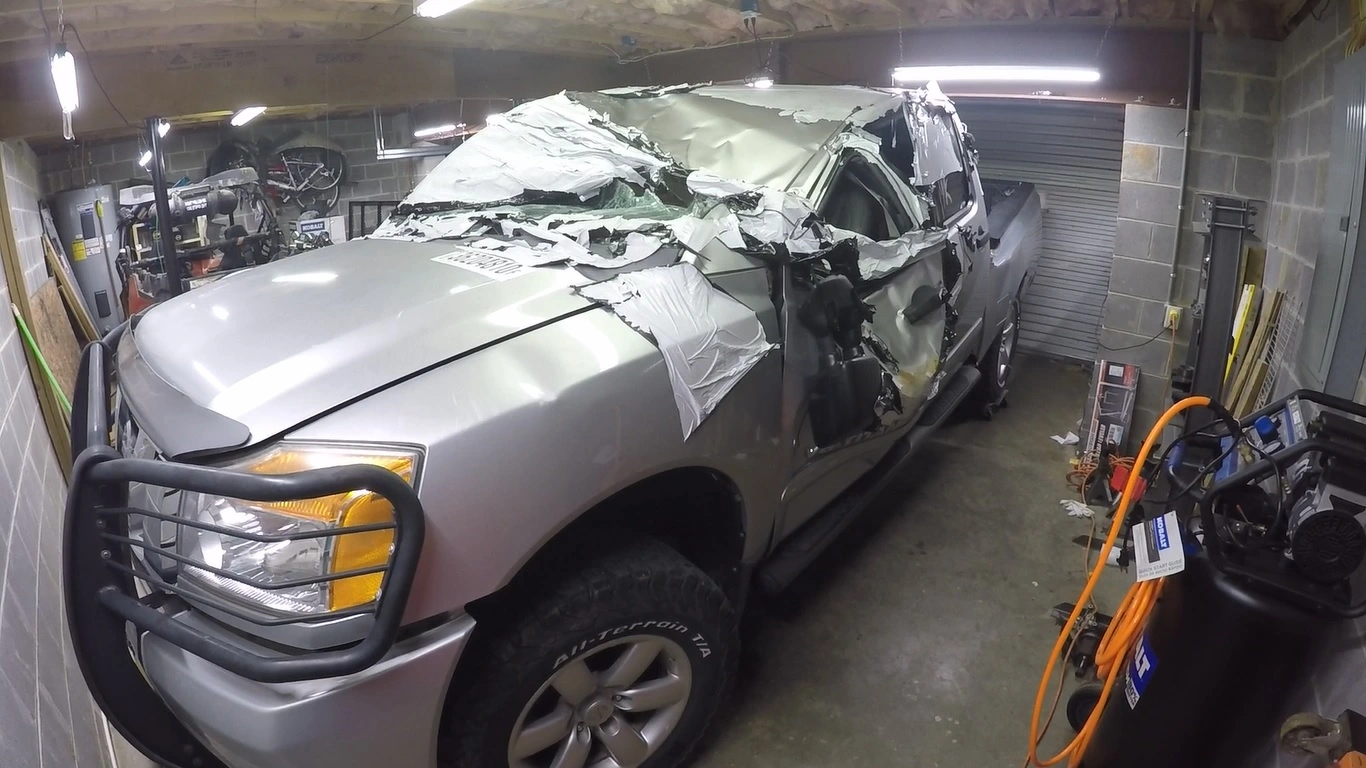

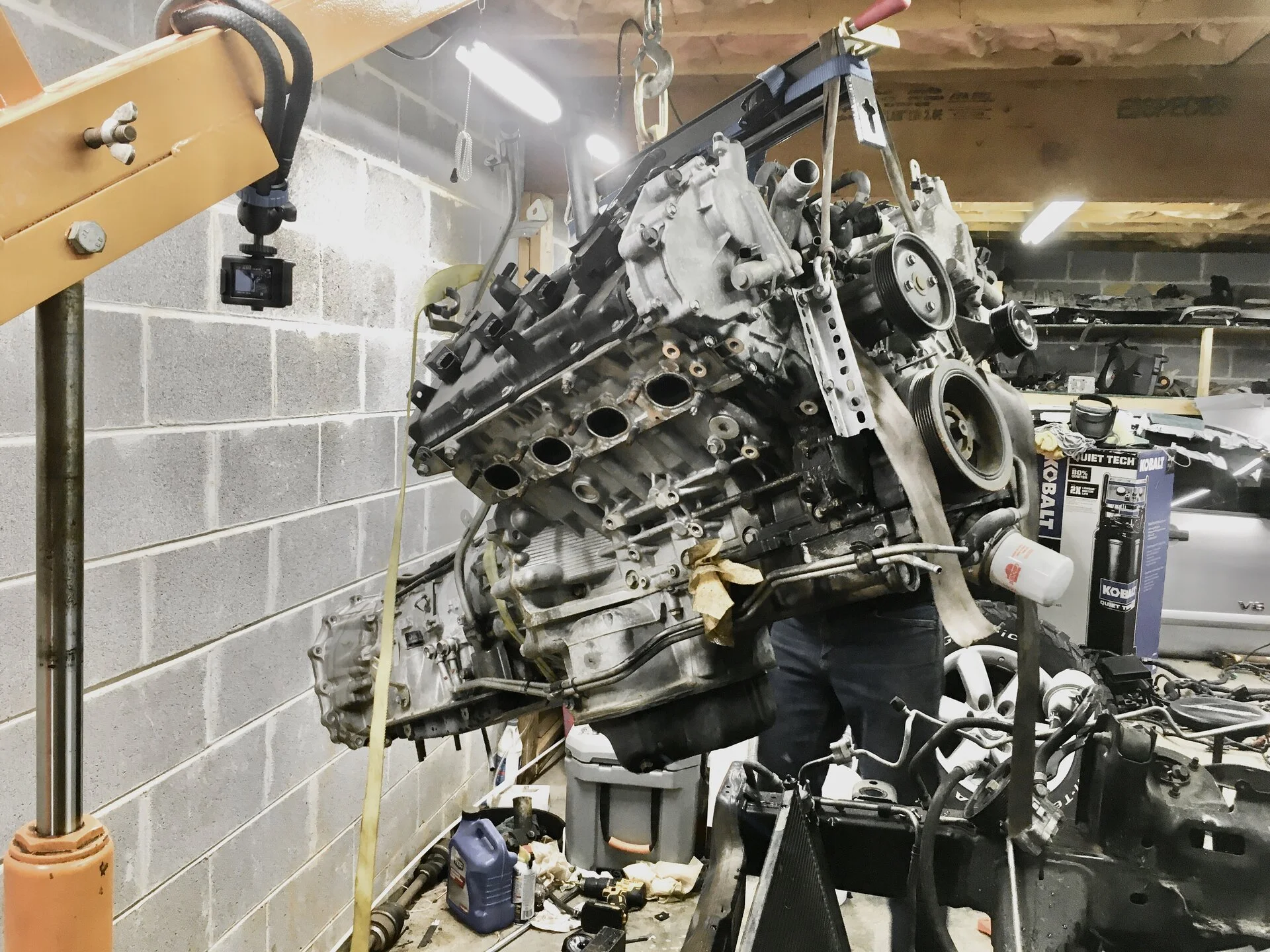

About 6 months ago I came up with the wild idea to Nissan V8 swap a 1996 Mustang.
My daily driver is an 07 Nissan Titan 4x4 with around 150k. As I have been driving it I have noticed a noise occurring in the front of the truck that sounds like a bearing going. It is most noticeable when city driving at 45-55 mph when the truck shifts to OD without much load. I was having trouble determining if it was my front diff bearings going or my trans/torque converter going. Both of these would be expensive, in-depth fixes that would require a ton of technical ability/tools. I found a truck being sold in an auto auction that had been crushed by a tree. The tree landed on the driver seat and only damage the cab, bed and the steering column. My plan was to pull the trans, front diff, tires and some other bits for my truck and scrap the mangled body.
At the same time I was gifted the 1996 mustang from my parents after quite a bit of pestering on my part. The car is a v6 auto with northern rust so it needed a ton of work. My mom bought this car to drive after her 98 explorer bit the dust with only 100k. #4.0SOHCProblems :O_o: I drove the stang a bit in high school but it had sat for the past few years and didn't start anymore. The price/scarcity of a 5.0 these days is the reason I was open to the Nissan swap. I tried to find a wrecked v8 SN95 to pull the drivetrain from but I wasn't able to snag one for a good price.
This is where I came up with the idea to pull the Titan Engine from the wrecked truck and put it in the mustang. Doing research I've discovered that the NATS system on Titans is quite intensive so I figured I would completely gut the mustang and pull the entire engine/trans/engine harness/body harness and steering column from the wrecked truck and put it all in. Can't have security problems if I swap over everything, right? Well, yes but no... Here is where it gets interesting. I mentioned the tree fell on the driver seat and smashed the steering column. For this reason I assume the insurance company didn't think getting the key from the owner was important so I never ended up getting the key for it. Rookie mistake. :shrug: When I got the truck I was so excited to cut the truck up and scrap the body to make more space in my garage that I didn't have a key made before doing so. Hindsight is 2020 I guess. Luckily I got in touch with a locksmith that was willing to cut me a key and then come back later to program it to the harness/bcm after I finish the swap project. I figured others might be interested in the project so I have actually started a YouTube channel documenting the process thus far. My first videos are a bit lacking as its the first time I tried anything like this but they are getting rapidly better due to the addition of better equipment and know-how. You can search "TJ Rebuild Mustang" if you're interested. I have a video of me tearing the truck apart as well.
Pics below of the car and the donor truck. Let me know if you have any questions or comments on the build!

Seems like a neat project and a way to stay sane during a pandemic. Those Nissan 5.6's and the Titan's would dust other half tons when they came out. They're a very peppy motor and sound great when they put down the power.
I'm just happy to see another mustang lose a V6 and gain a V8! How far along are you in the swap? If a modular 4.6 fits I'm assuming that 5.6 does okay? How about the trans in the trans tunnel?

Yeah the V6 just wouldn't cut it without major engine work and the 2v Mod motors weren't much of an improvement in N/A form. The nissan motor is roughly the same footprint as a 4.6 although that motor is still a pretty tight fit.
I had to pick up a hydroboost as the stock brake booster was not going to fit but luckily the 96-98 gt's came with these from the factory (for the same reason) I think I am going to use a gt P.S. pump mated to a custom bracket as the nissan P.S. pump wouldnt clear the frame. I'll have to put it in place of the A/C compressor for now. I have to machined out the center of the nissan P.S. pulley to press onto the mustang pump as the nissan pulley bolts on. I picked up a set of factory P.S. lines and I'm running the factory steering rack. I'm planning to modify the nissan steering column to accept the mustang steering shaft u-joint. This should be fairly easy and that way I can use the stock nissan wiring harnesses (minus the HVAC controls). I have the engine and trans mounted in the car. I had to cut the trans tunnel to get the trans to fit. I need to remake the motor mounts to drop the trans even lower. I was waiting until I got the trans installed, steering in place, and exhaust to determine the motors final position. I cut the cats off the factory manifolds so I could change the angle they are welded due to the mustang being narrower than the truck. My end goal would be to put a manual trans in it (probably from a 370z) but I need to get it finished and driving first.
