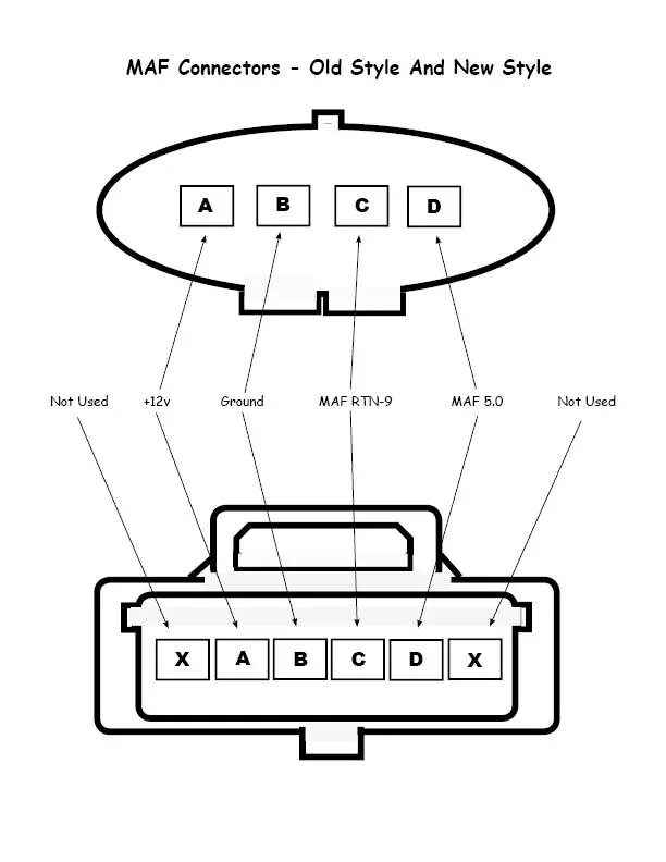

Nope. Just use the factory Lightning pigtail and use this diagram:
The two wires on the outside are for the internal IAT (intake air temperature sensor). You can use these two wires if you want your tuner to use this IAT vs. the one on the intake.
Reactions: 85GT4V
So I will have to splice the lightnings into my pigtail wiring?
If I decided to use the two outside wires I guess I would have to splice those two into my IAT's wires?
Just asking about the IAT thing though as I don't plan on making things too complicated and will likely just use my IAT....

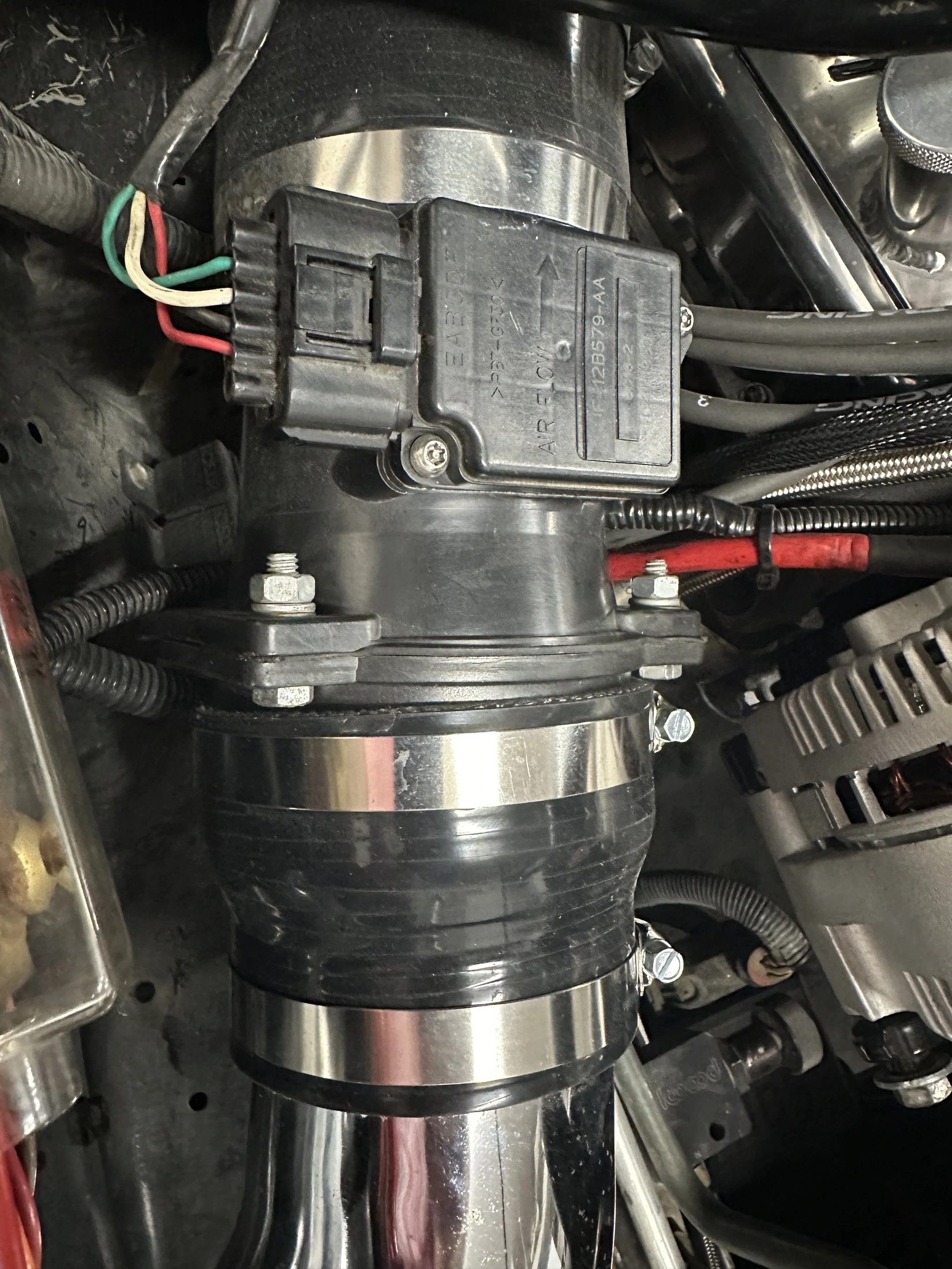

Yes and yes. This is what mine looks like. I just depinned the outer two wires but you could just tape them up in the harness.
Reactions: 85GT4V and gkomo
Gotcha

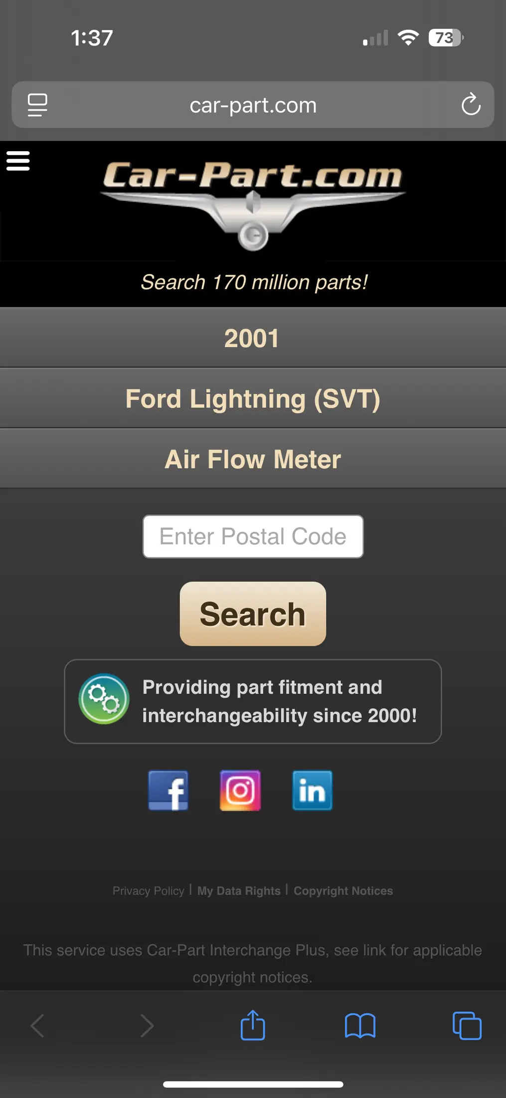

On carpart they do not have a listing for mass air meter and the closest thing is air cleaner assembly. Without being able to call them until Monday do you think that's along the lines of what that would be?
