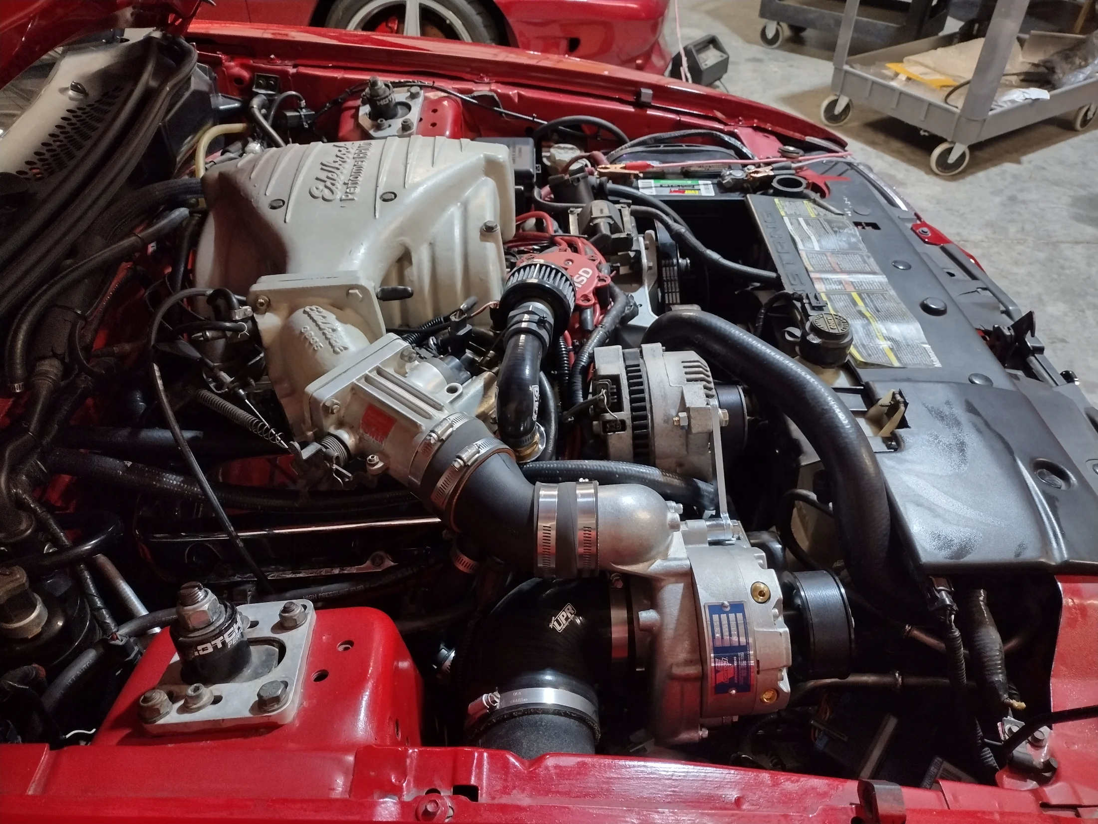

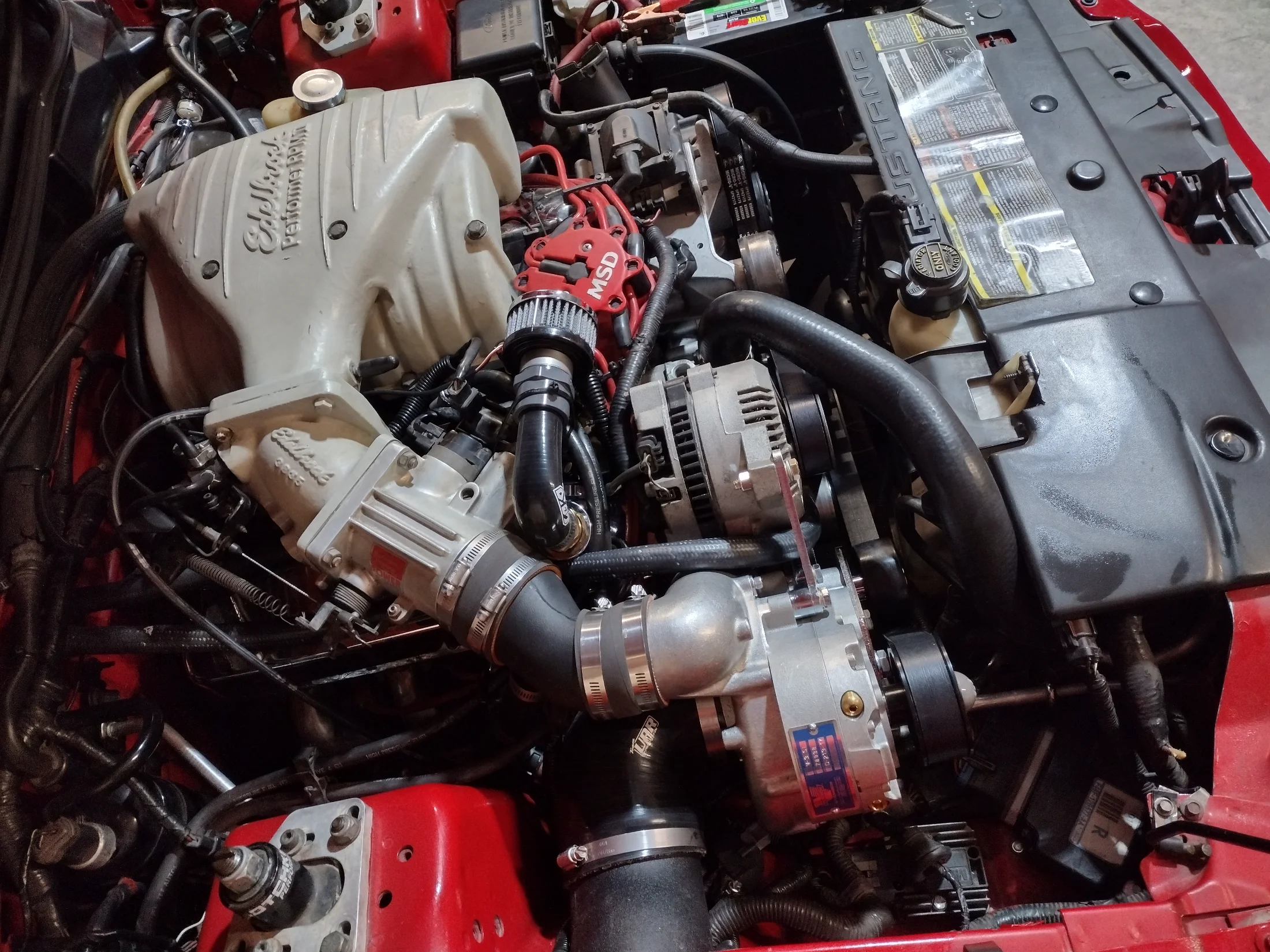

The big line that you don't see a hose on yet it gets that biggest line from the vacuum tree

I still can't tell what's what.
Here's what I think I've picked up from your description:
From the vacuum tree, you're going to a line and then a T and then off to the FPR and Boost Sensor... Is this correct?
If so, you [should] come off of the vacuum tree and go straight to the FPR with nothing else fed from that line.

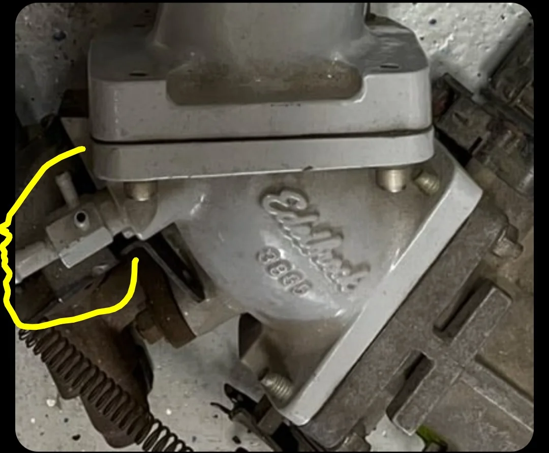

Okay I just googled an image of the elbow adapter that has that screw in fitting that has ports for vacuum. The biggest Port gets the biggest vacuum line coming off of the vacuum tree. The other two ports are for the fuel pressure regulator and now the boost vacuum sensor. Prior to the boost vacuum sensor that port was capped. So they are all getting vacuum at that adapter which is after the throttle body.

Ok... That does seem to be as it should be.
I just didn't want you teeing off a quarter inch line to two components at the same time. You're going right to the source which should be totally fine.
