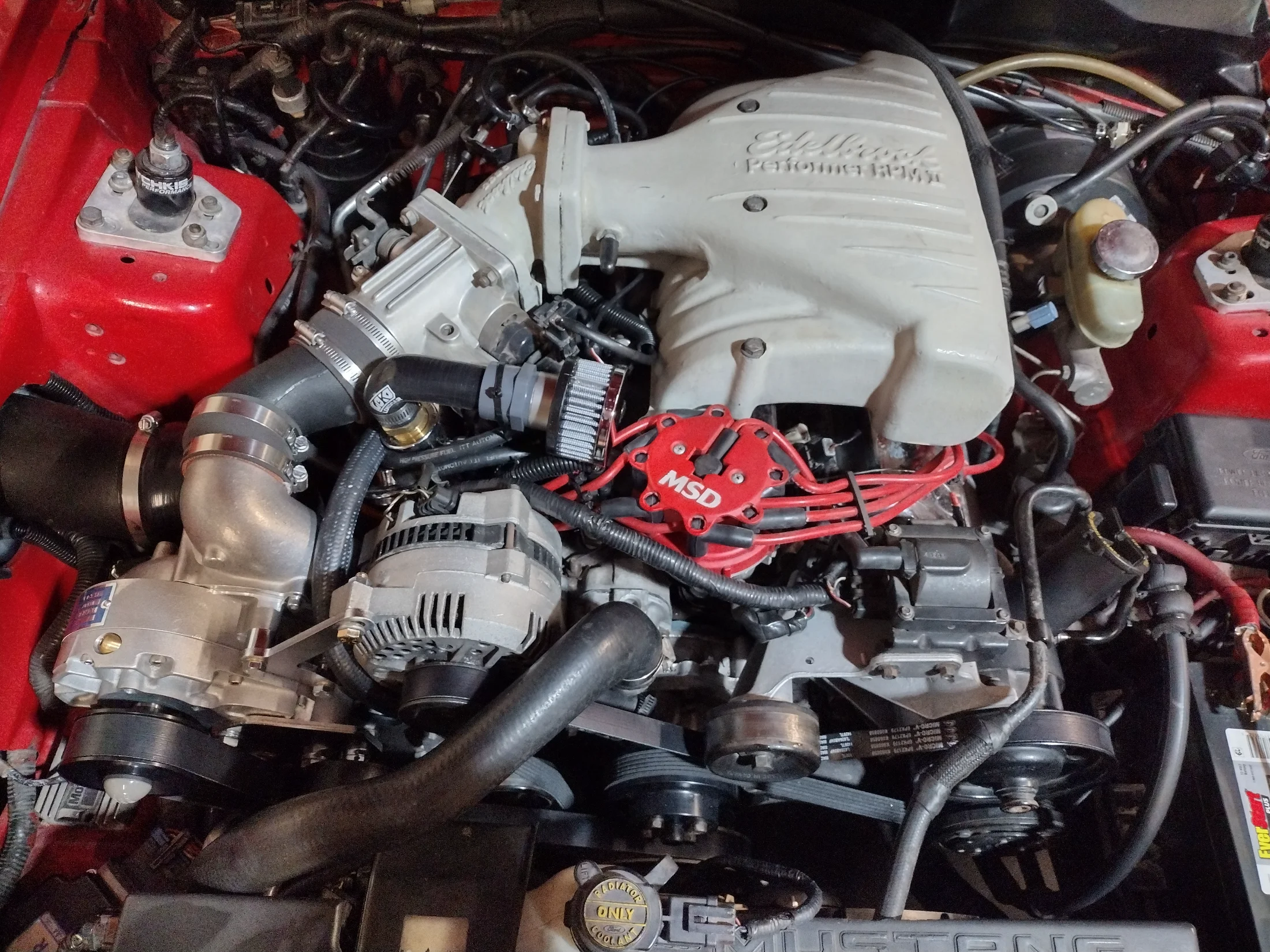

gkomo said:
Hopefully this was all just faulty readings due to the electrical stuff. Do you have a photo of the whole car all this is about? I get confused on which cars you have and are talking about sometimes.
Yes indeedy man hopefully that's it and yes I will attach a few

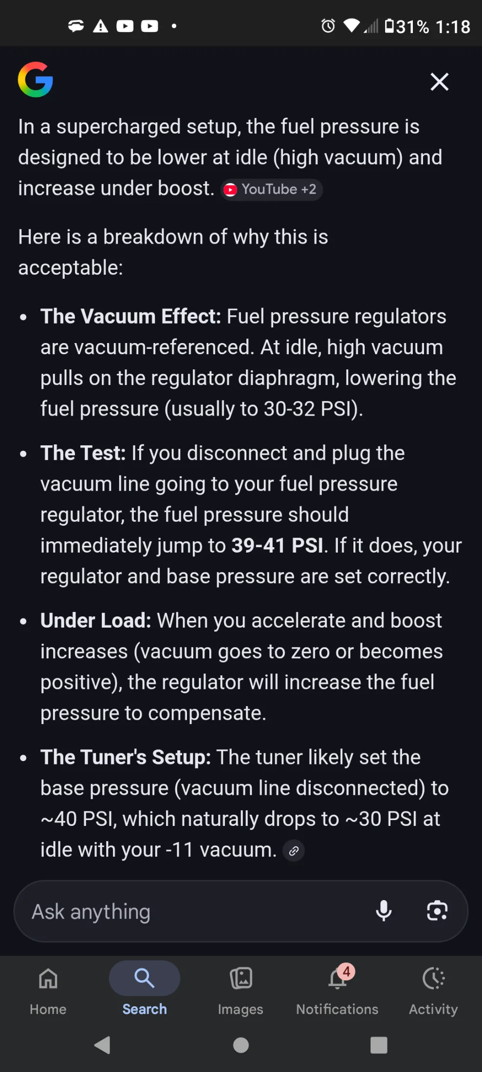

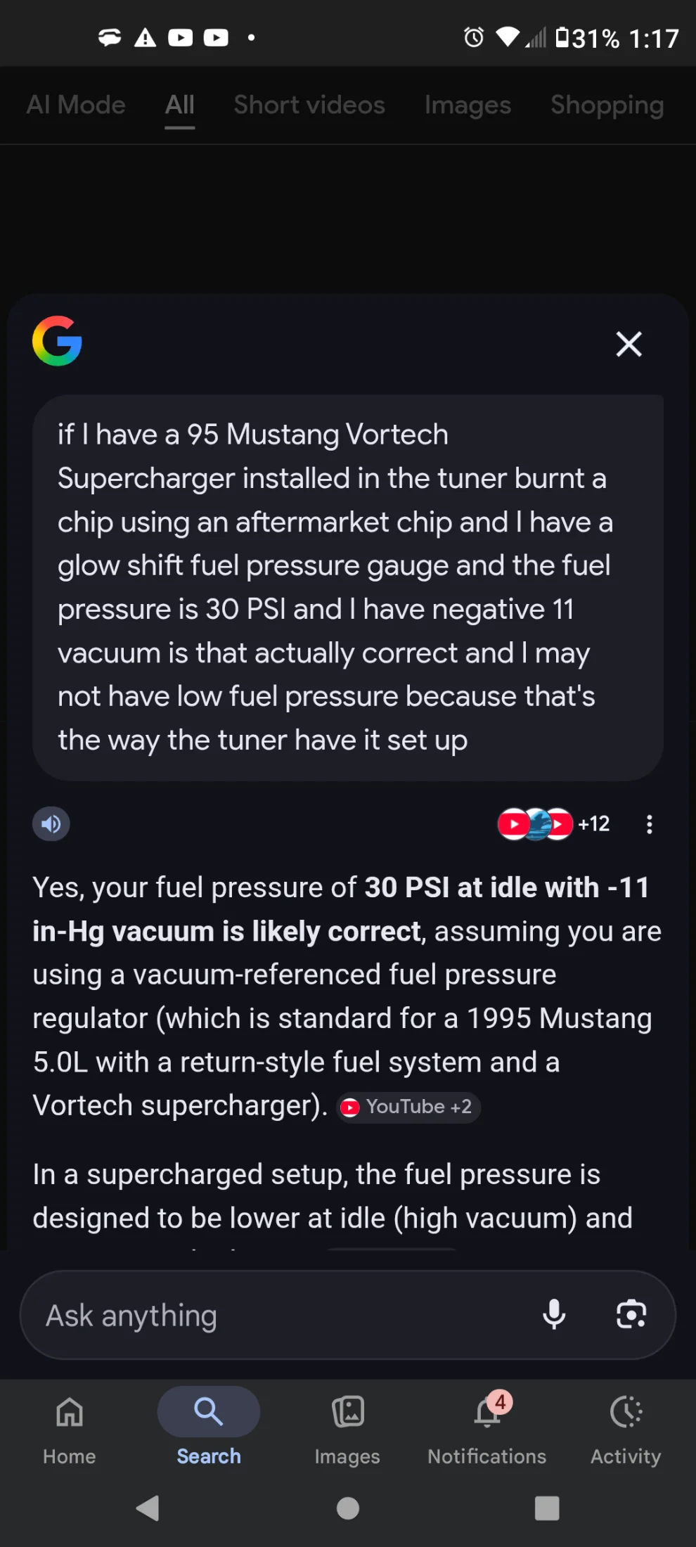

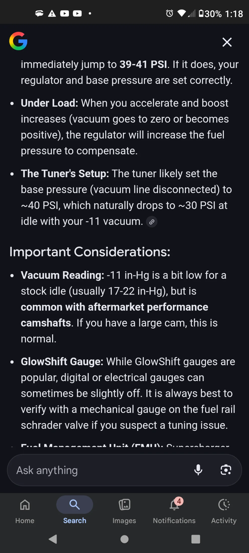

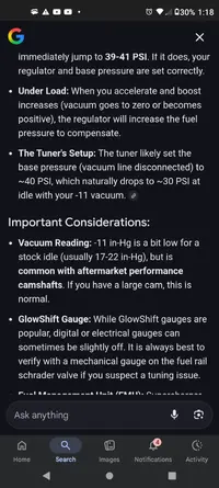

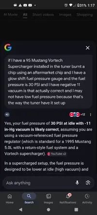

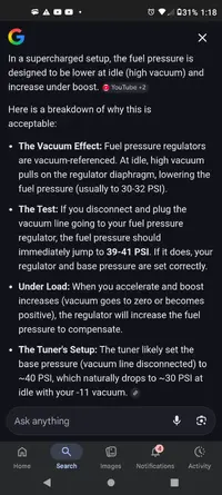

Well something's still going on with the fuel pressure. I googled some things earlier and it took me to a thread and I'm just copying and pasting my reply there even though it's an old thread on the corral.
Google brought me to this because I am having something going on with my fuel system after vortec installed and 255 pump. Had an adjustable pressure regulator on the car for over 10-15 years and I put the OEM One on to see if that was it but still no difference fuel pressure now reading after I put the OEM One on it's reading 25 at startup. The crazy thing is like I drove the car today for about a 30 minute trip got on it pretty decently a little bit but not the whole trip. Pulled up in my mom's cul-de-sac and fuel pressure was around 19. Stayed there for a few hours went to the car to start it up in fuel pressure was still showing around 19. Something is off I'm going to probably just put the adjustable pressure regulator back on and adjust the fuel pressure but it's still crazy why it actually started out yesterday when I started driving the car it was at about I want to say 28 so why would it have dropped all the way down to 19 20 and then when I started the car a few hours later it was still at 19?
I want to adjust the pressure at the regulator first just to see what it does even though the car is Dyno tuned so I want to be careful with that. But I want to just adjust the pressure up and see what happens if it holds pretty steady or what

What smog and EGR hoses and devices do you have left?
I'm starting to think, that there's something [opening up] when the car gets warm and goes into closed loop. Whatever that thing is, is taking a portion of your vacuum.
How does your idle sound and feel at cold start vs. when it's fully warm?
It may be time to install a vacuum gauge in the car to help pinpoint when this change is occurring.
No smog or EGR on the car.
I can diagnose the difference in the idle tomorrow but off the top of my head I believe they sound about the same but I would like to make sure for certain.
I actually have a dual wide band vacuum boost gauge. I researched what the vacuum should be on the gauge and it seems a negative vacuum is perfectly normal on the gauge and so just sitting there idling the vacuum is around I want to say negative 11 or 12
