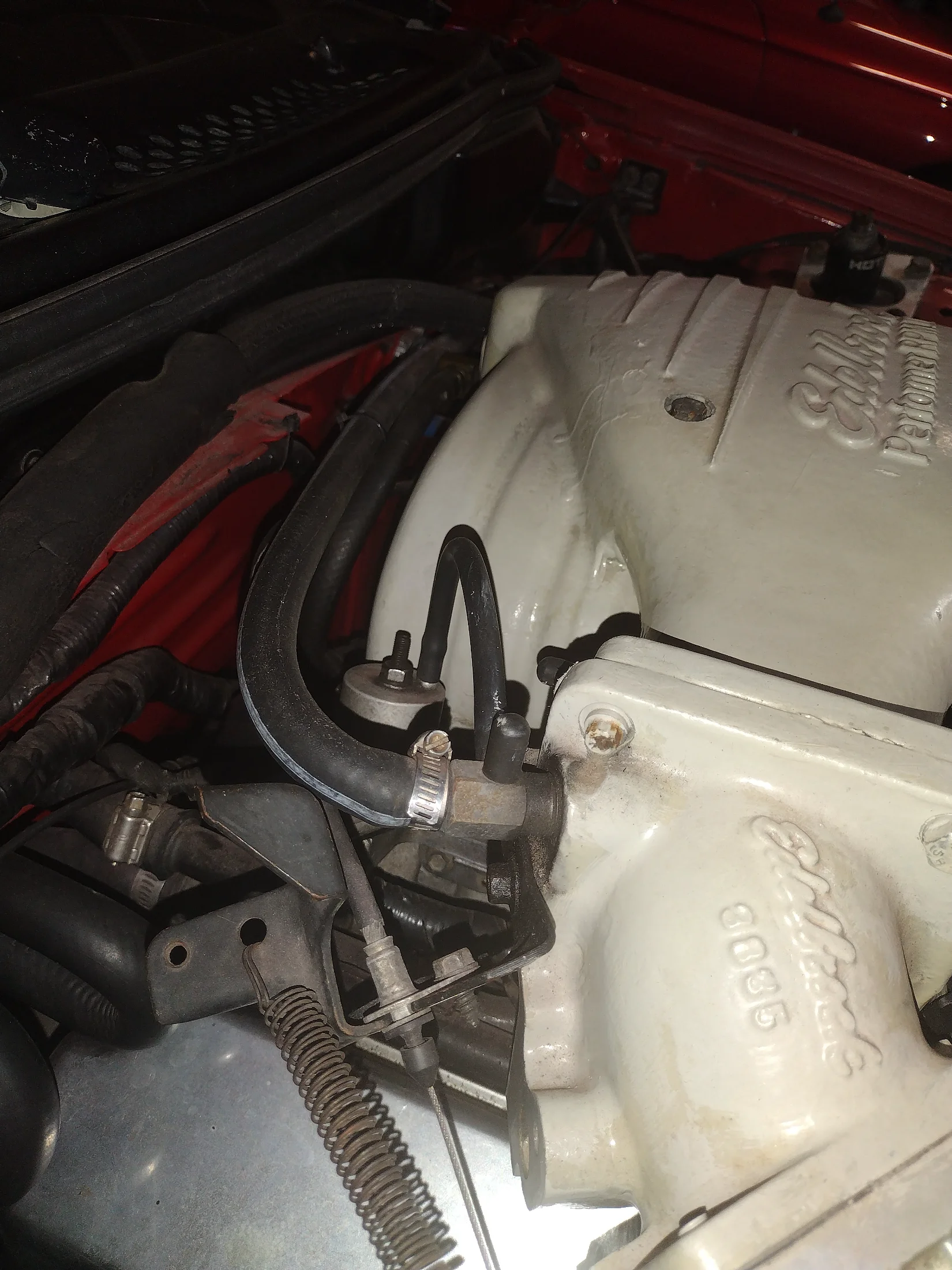

I'm no guru so hopefully i'm explaining this correctly, but the way my valve cover part of the PCV system is almost 'like' a breather with a check valve. Instead of running the hose from the VC to TB (after MAF), it runs from VC to 'before' the MAF, into the airbox, but with a check valve. So its basically venting to atmosphere but just right into the air filter and the check valve makes sure no unmetered air gets into the crankcase.
The other check valve is added in between the factory PCV and upper intake.
I'm not sure who @Noobz347 was referring to with not being able to picture this set up, but thats how mine is.

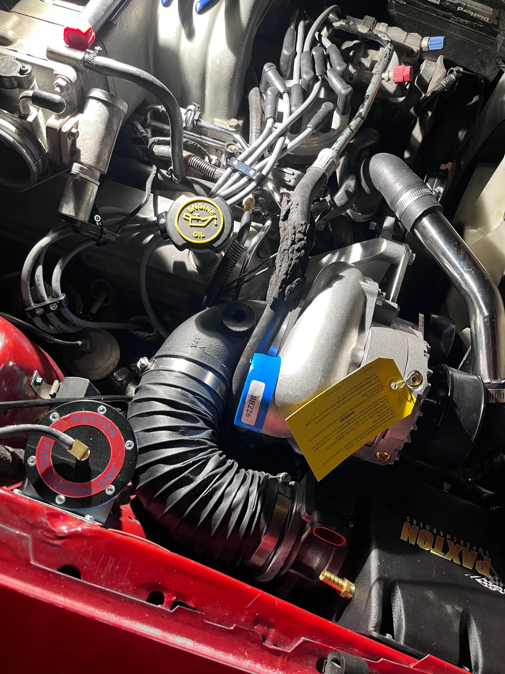

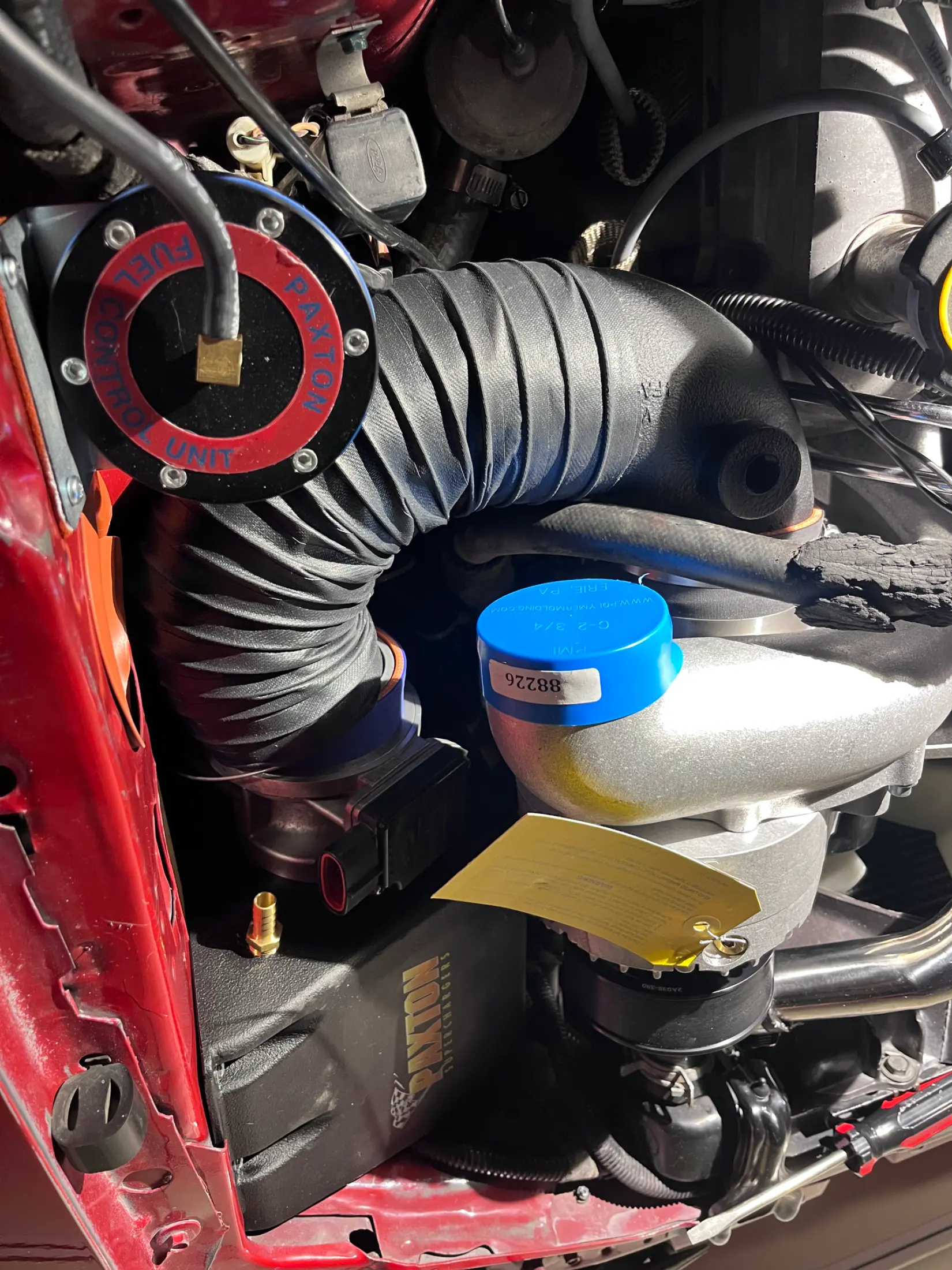

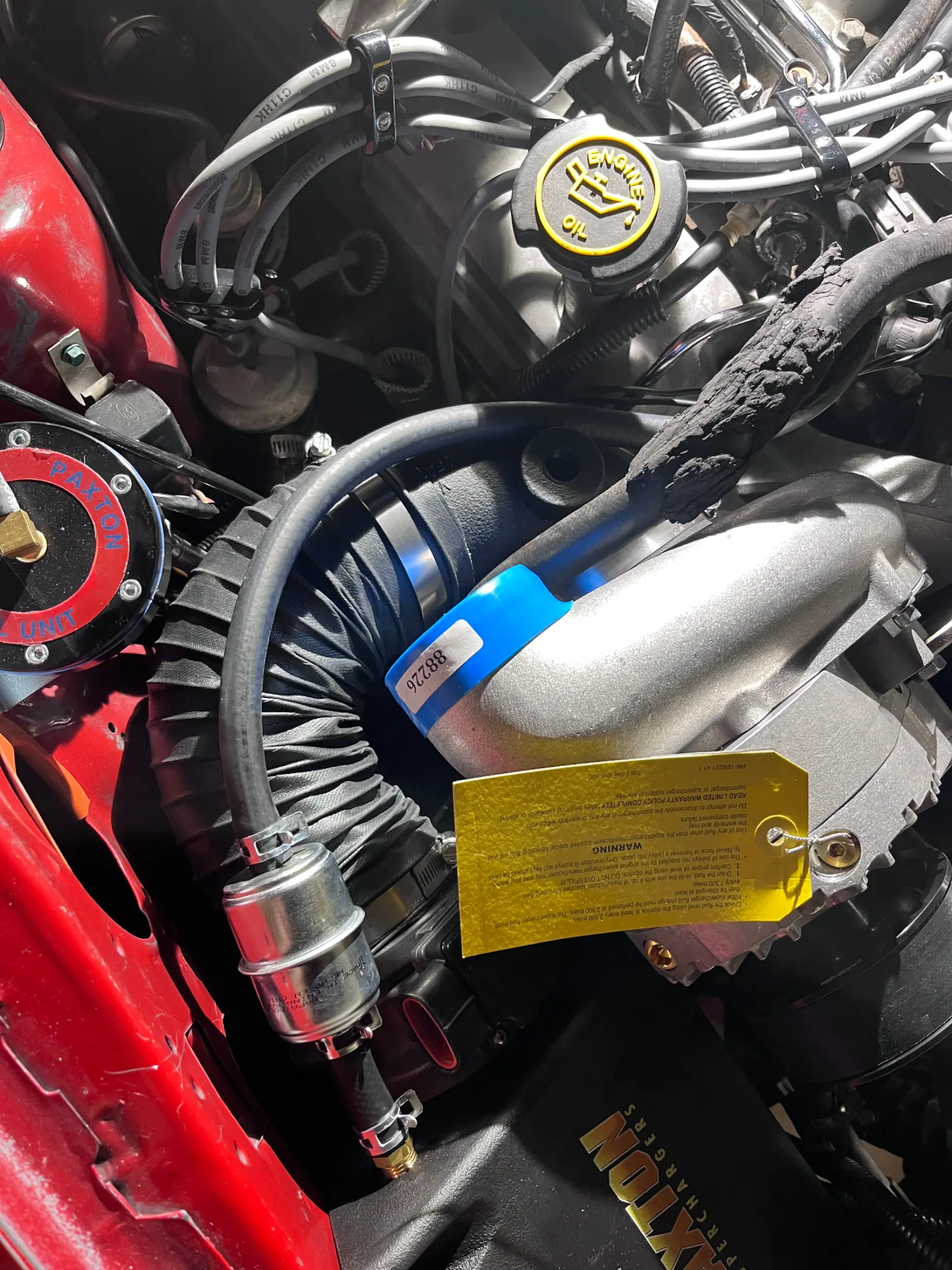

Progress Thread Post in thread 'Komo's 1990 GT - Parts Gathering Purgatory & Home Remodel'
May 9, 2025
Supercharger install is done!
Got the fuel feed hardline out of the little bracket and that was it, elbow was so easy to get on with that out of the way. One thing I had to do is route the A/C hose in between the inlet and discharge piping. It has wiggle room so not pinching anything and it’s not bent all weirdly:
Then put the line from the oil fill tube to airbox:
From there it was just putting the discharge tube on:
Which basically wraps up the install.
I found the right hex head bit to put the breather on the...
  • gkomo
Reactions: Noobz347

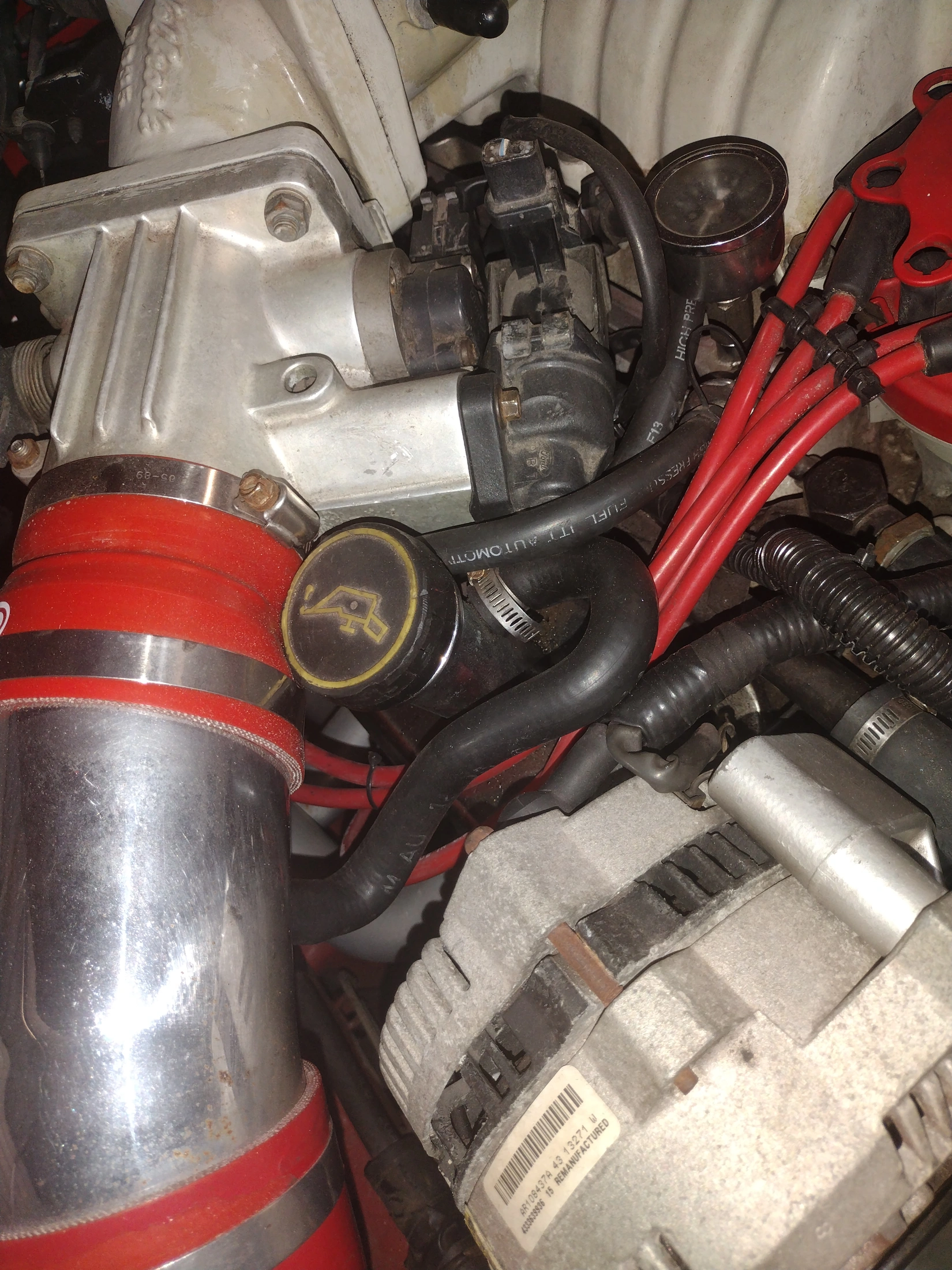

As for mine mine is currently the valve cover goes to the CAI and that is after the meter.
Running the power pipe it appears that it will also be after the meter I will just have to run a long hose that will connect to the power pipe, run it through the fender well where the pipe will be.
