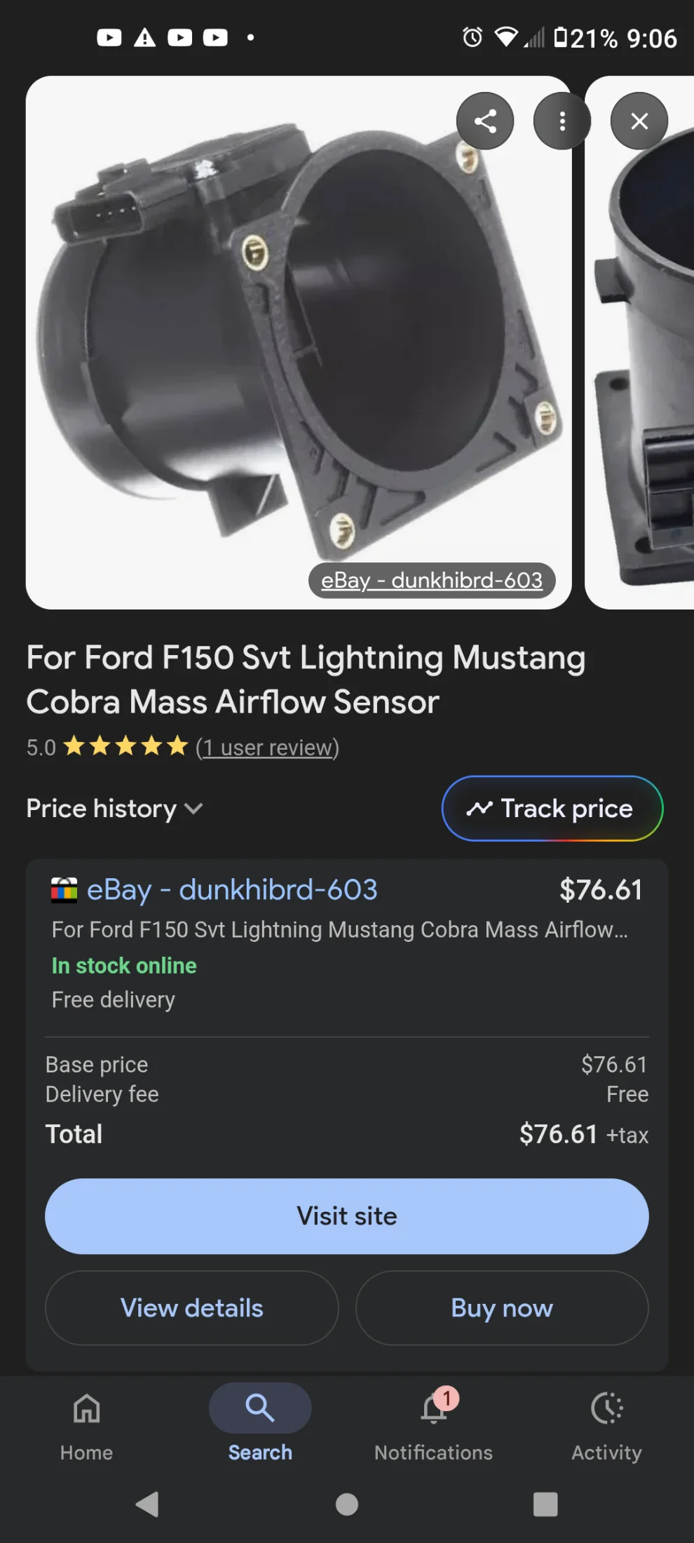

Just get a 90mm Lighting MAF. Go on car-part.com and buy a couple so you have a spare. A good tuner will already have that transfer function and the OEM stuff is super accurate.
Reactions: from6to8
Or this?
from6to8
There's suction so I used that end O_O
Sep 2, 2012
1,897
142
94
Nov 7, 2025
#180
  • Nov 7, 2025
  • #180
Any particular year range lightning?
