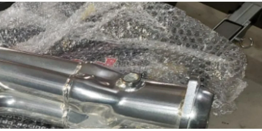

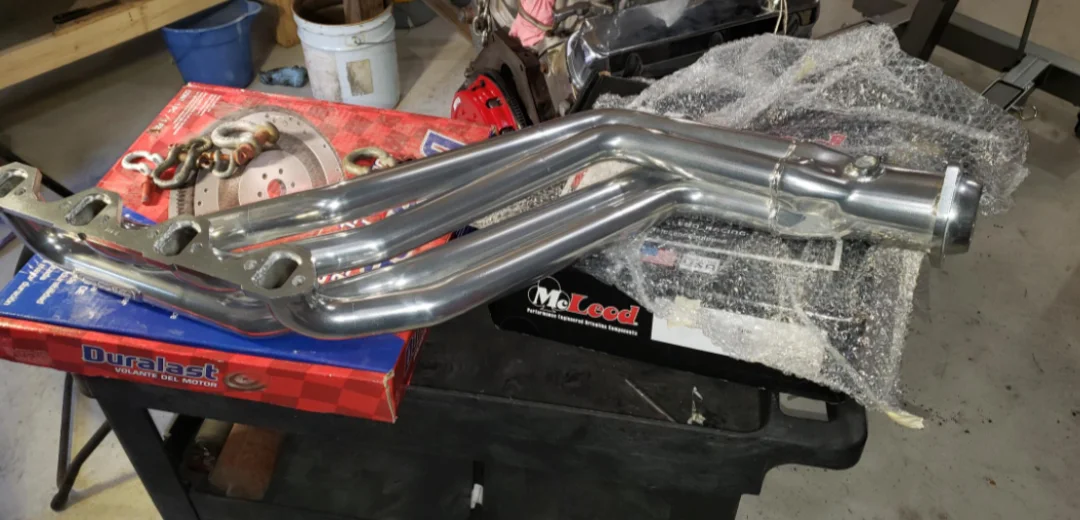

If it's mostly horizontal then look for a spot between 9 and 3 o'clock on the pipe.
You think there will be enough room on the collector?

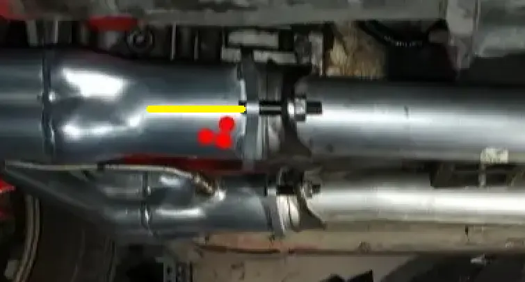

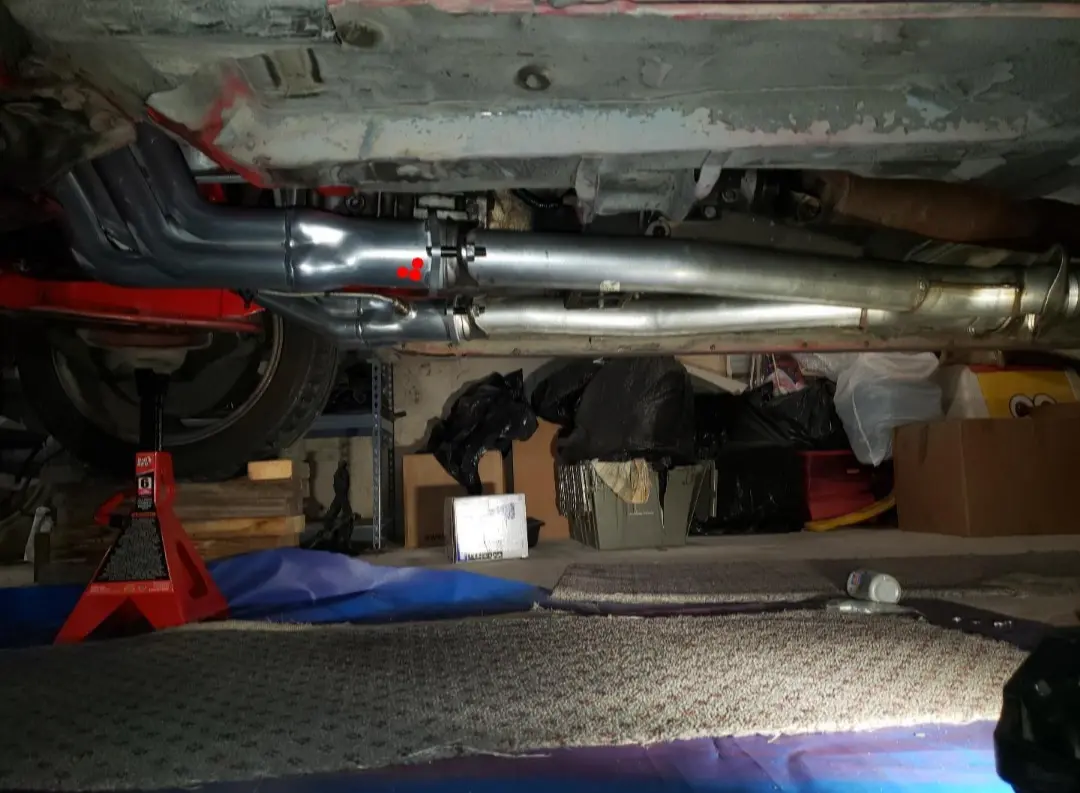

There's a better image. If you got a stylus pen or you know how to edit a photo Mark where you would put the other bung
Would it be around near where this red mark is? The other one of course is on the opposite side.
My phone is doing something stupid and will not let me attach an image so I'm going to put it in the next post
At or above the yellow line so as not to interfere with hardware:
Does it matter if it's in relation to where the other bung is in other words does i't matter if it's lining up across from the bung?
The other one is actually more closer to the collectors though matter of fact right after where the collector s end
It should not be directly inline with another bung. You can move it past the connection too, if necessary.
