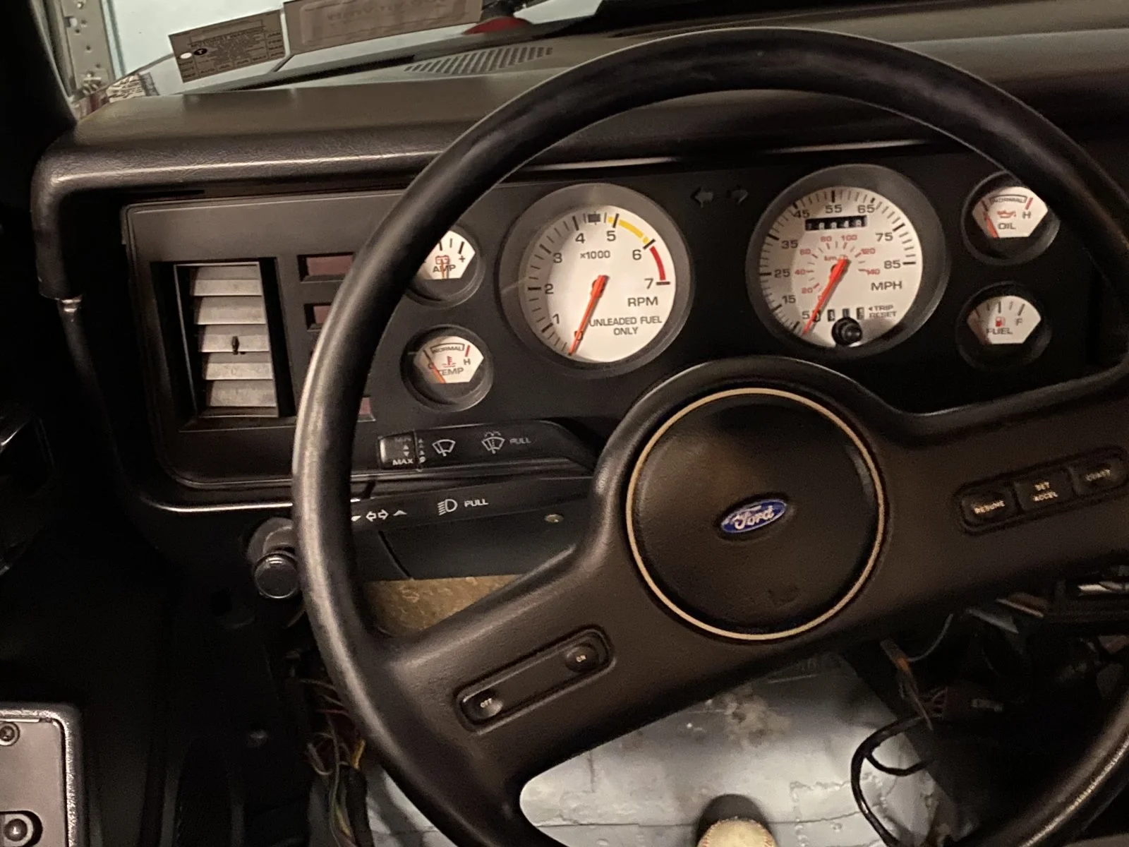

Had these for a while. Couldn’t decide whether to do it or not.... but I finally did. The more I look at it, the more I like the white face.

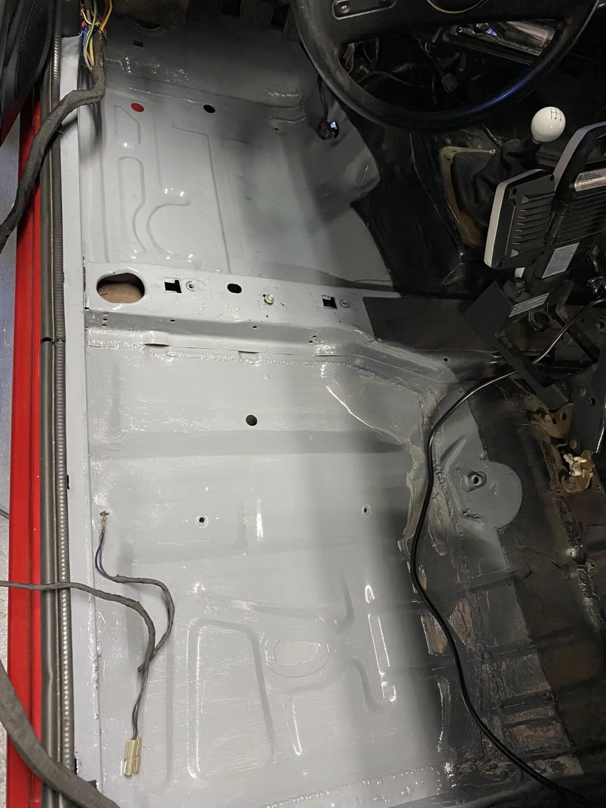

My interior work with seam seal and POR 15 will wait until no one else is home and I can have garage wide open, with a fan blowing out. I want to scuff down the passenger side and paint.
I was not the most popular kid on the block with my first shot of sealer and P15. Apparently the smell was much worse than I realized :shrug:

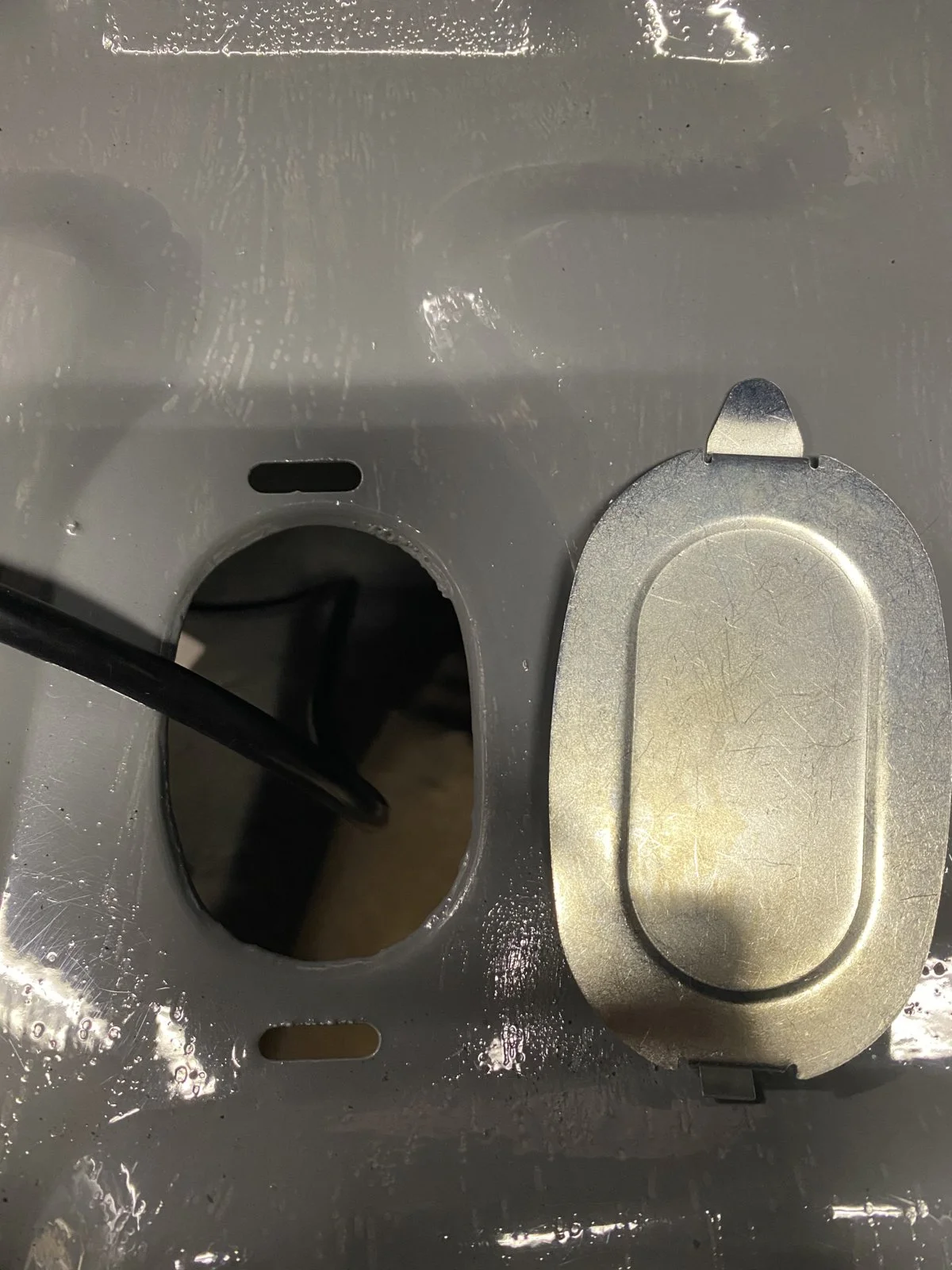

Back to my drivers side. I have new plugs for the floor pans.... my question to those following, should I grind off the POR15 before I put the sealer down to seal the plug, or will the sealer stick to the P15?
And I have to say, I’m completely jealous of you guys with those nice shops! I have to get this driver side finished up. Put the seat back in, lower the car, drive it out and flip around, and jack it back up. I’ll get it done, but this limited space sucks!!

lol..... I had to set up a big Patton fan the other day when I finished the POR15. It seemed to do the trick, and the family was happy!

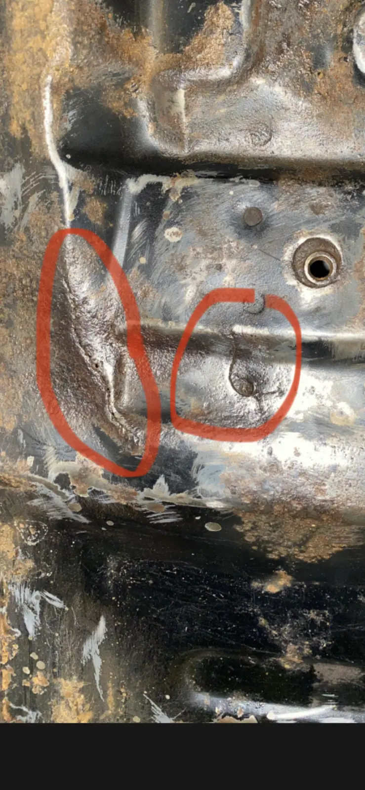

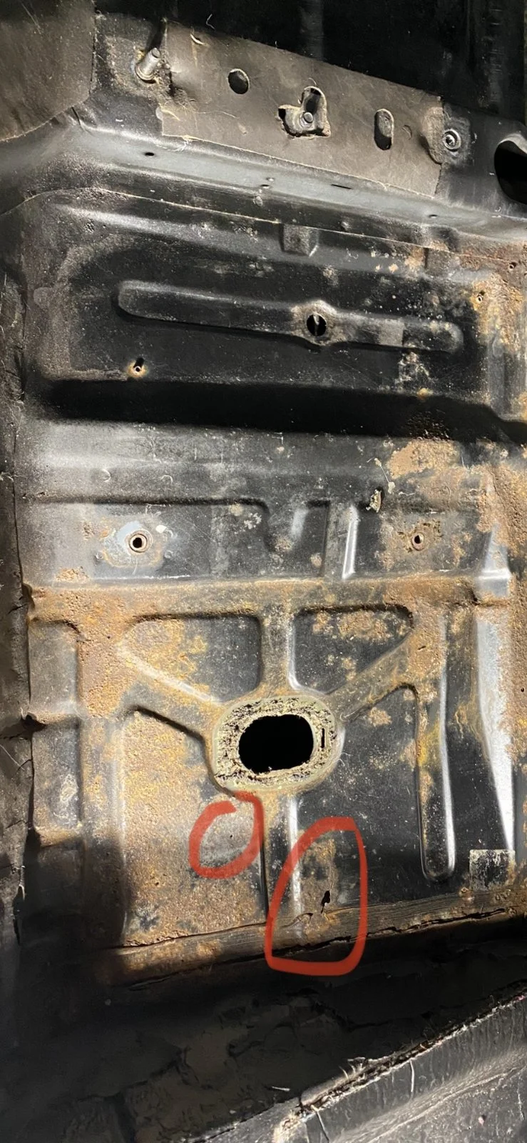

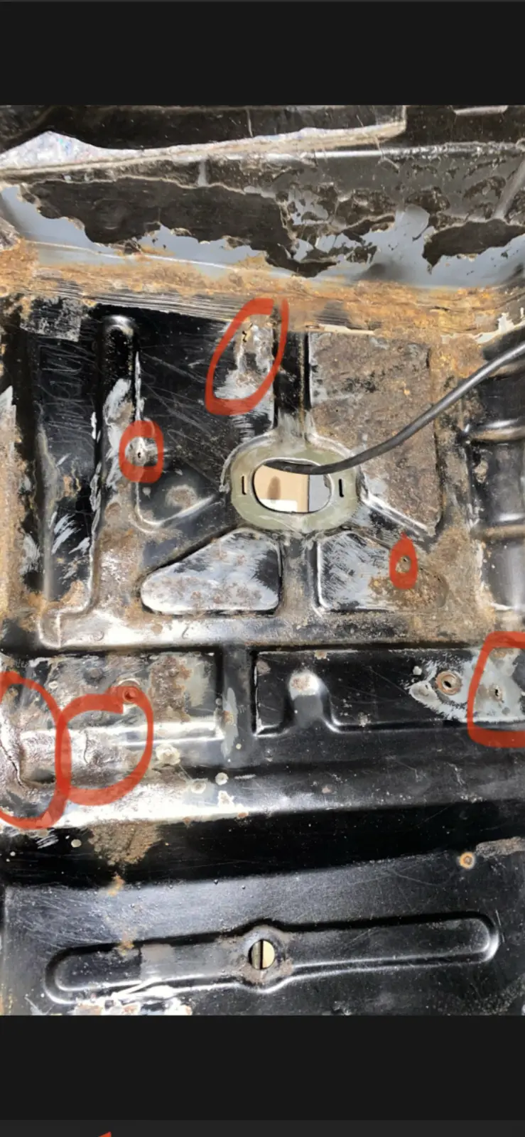

Got the car out and turned around in the garage (felt good to hear it run for a bit). But in the spirit of “it’s always worse than it looks”....... here it is.
I have cracks, I have holes, I have more than I thought all over this passenger side.

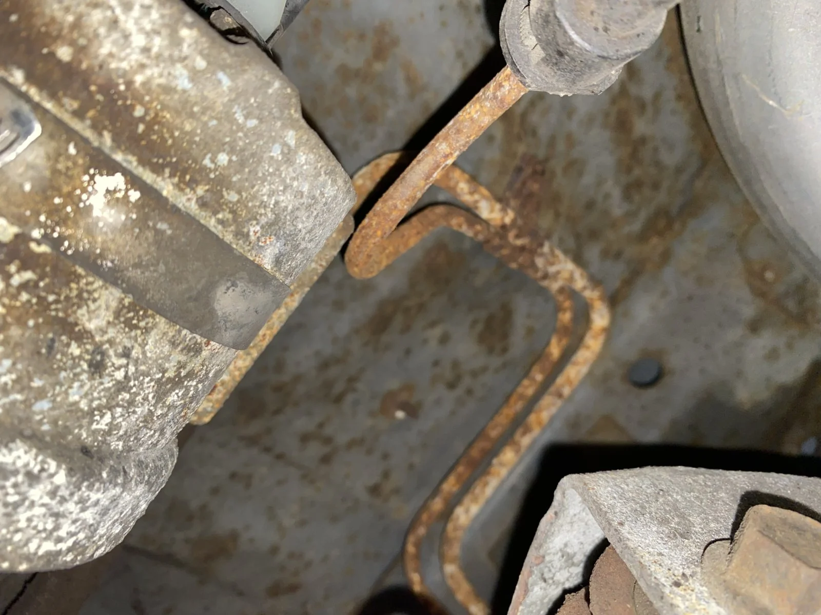

So this leads me to (because this is how my mind works) whether I should pull the fuel lines that all of this is directly over. That would lead to..... pull the tank down, replace the filler neck gaskets, etc etc.
My goal from the beginning was to replace everything I could, that needed it on this car. My novice welding skills tells me to get the fuel and vent lines completely out of the way, and replace what’s needed on the reassembly. My “I can do this” tells me to cover them in spare sheet metal, and welding blanket, fix the floor, and get back to driving.
I always say WTF when I see people do stupid things causing major damage. Welding over fuel lines seems to me, to be one of those things! My fuel system may be getting an overhaul, thanks to my bad floor pans!
Here’s wha the lines look like right around the tank.
