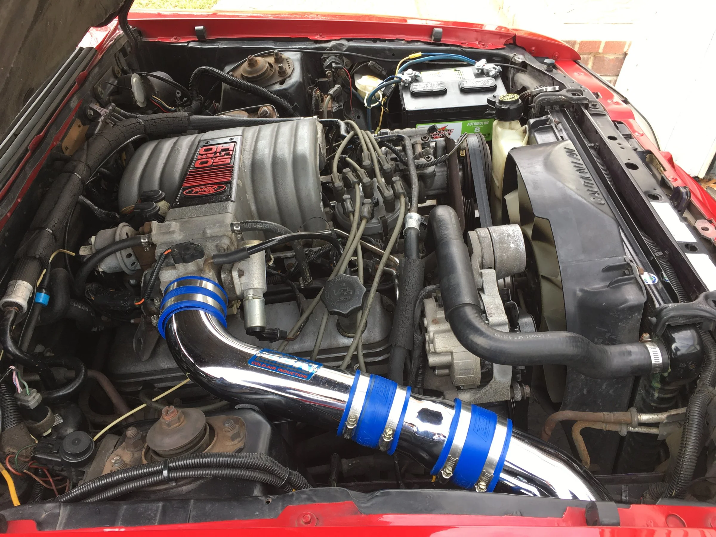

I would also recommend you replace that hot air intake with the stock CAI box, install a set of MM subframe connectors and upgrade to a 3G alternator
Picked up that “non mass air” adapter on eBay and got that filter out of the engine bay. Looks nicer too .... IMO

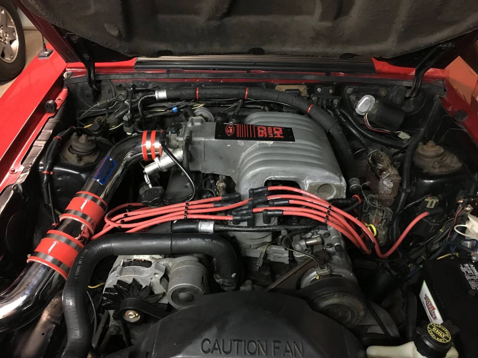

Did some engine compartment upgrades. I just wasn’t feeling the BBK blue couplers. Love the Ford Racing wires too!
Cap and rotor coming from LMR..... will do plugs then also.

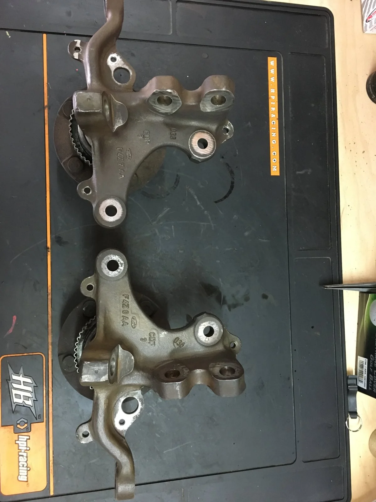

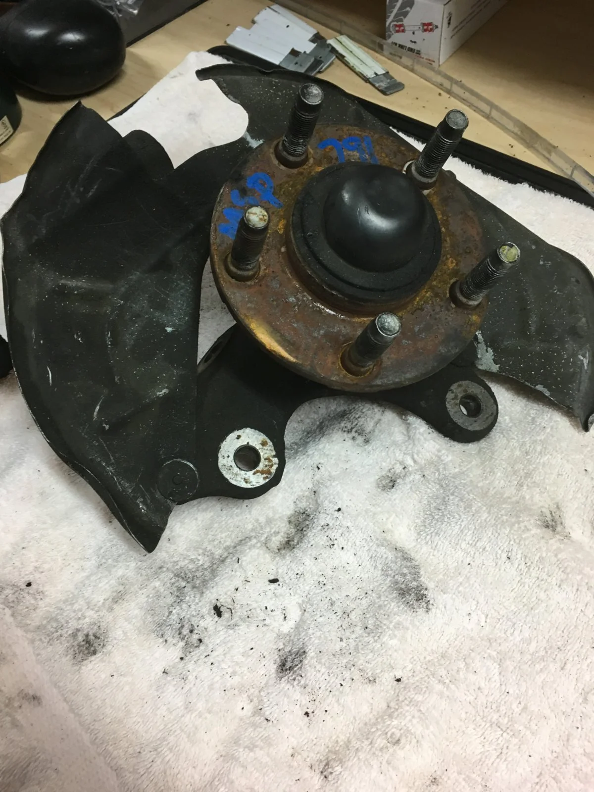

Scored some 94 spindles from eBay. I’ve been cleaning them up for a while, got the old hubs off, now looking to put some paint on them.
Should I look to the high temp stuff, or will regular primer and paint do the job?

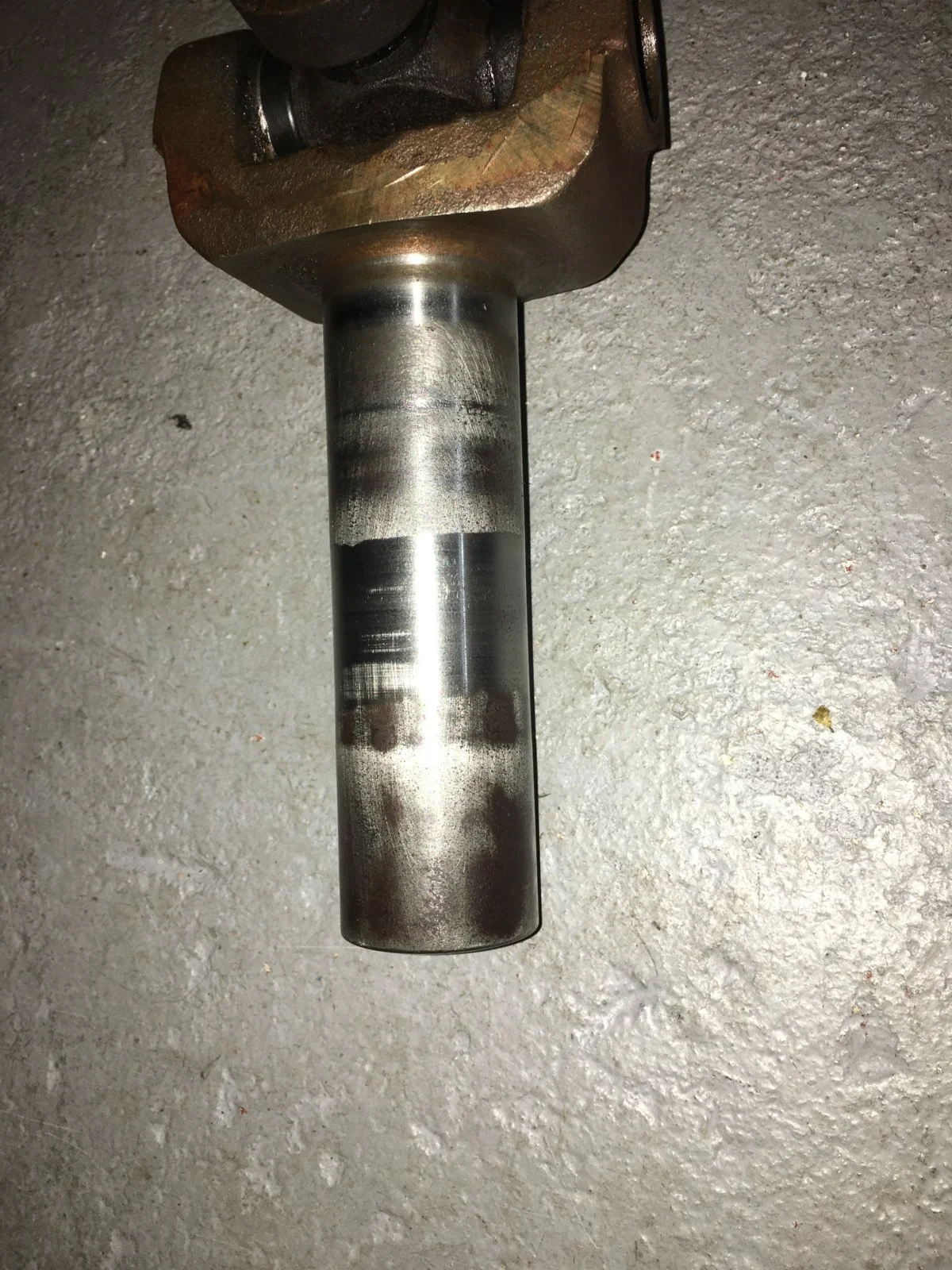

I decided to tackle the tail shaft leak and what I’m pretty sure is a rear main leak.
I bought the seal and the bushing, but when I pulled the shaft, this is the shape the yoke is in. It has a slight hourglass shape to it. Should I just replace the yoke and seal, or does the bushing need to be done also? (I’m weighing my options of buying “the tool”, or trying to find a shop to change it if it really needs to be done.
