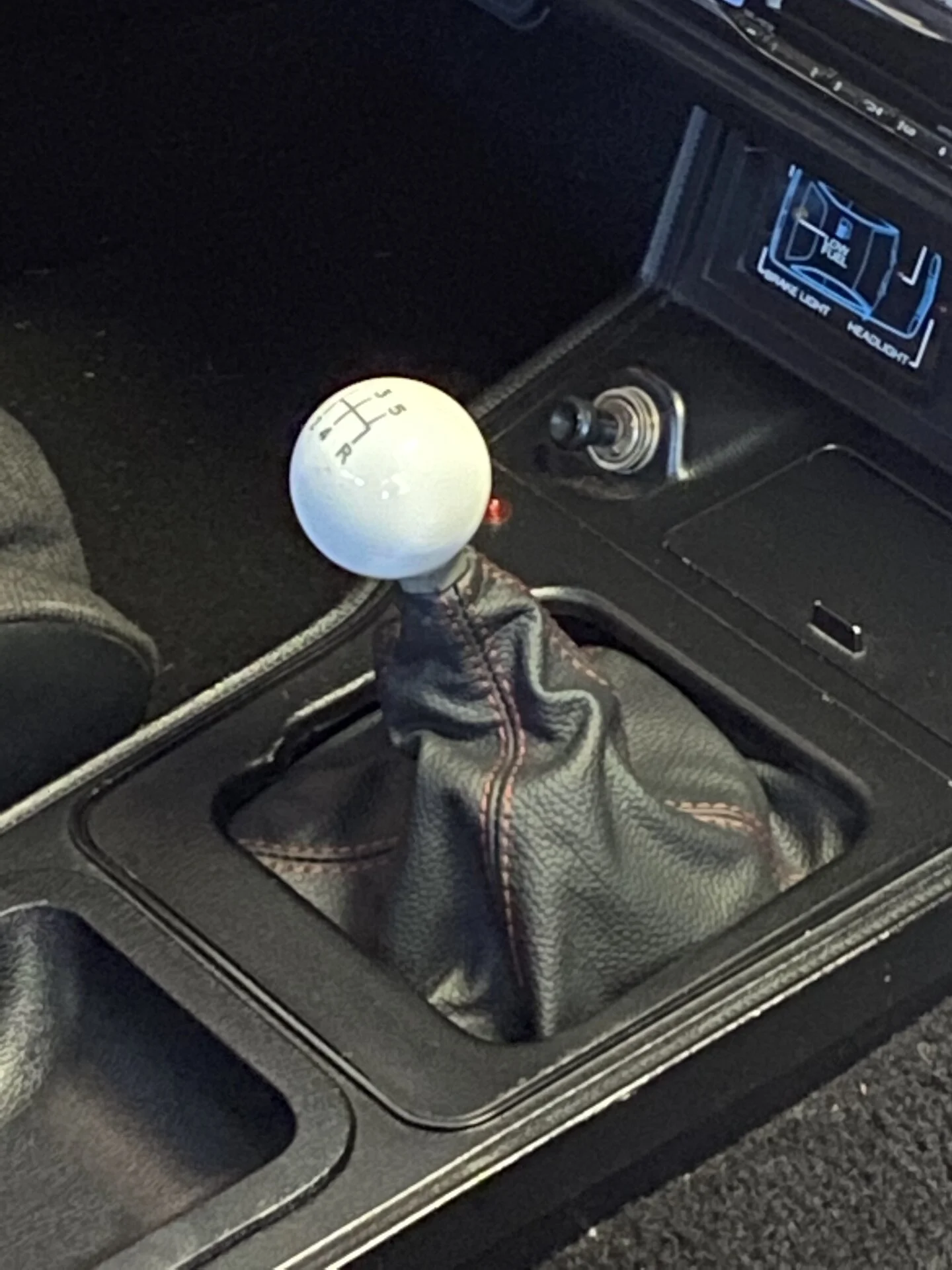

My Redline Goods shift boot showed up early, so I got that put in yesterday.

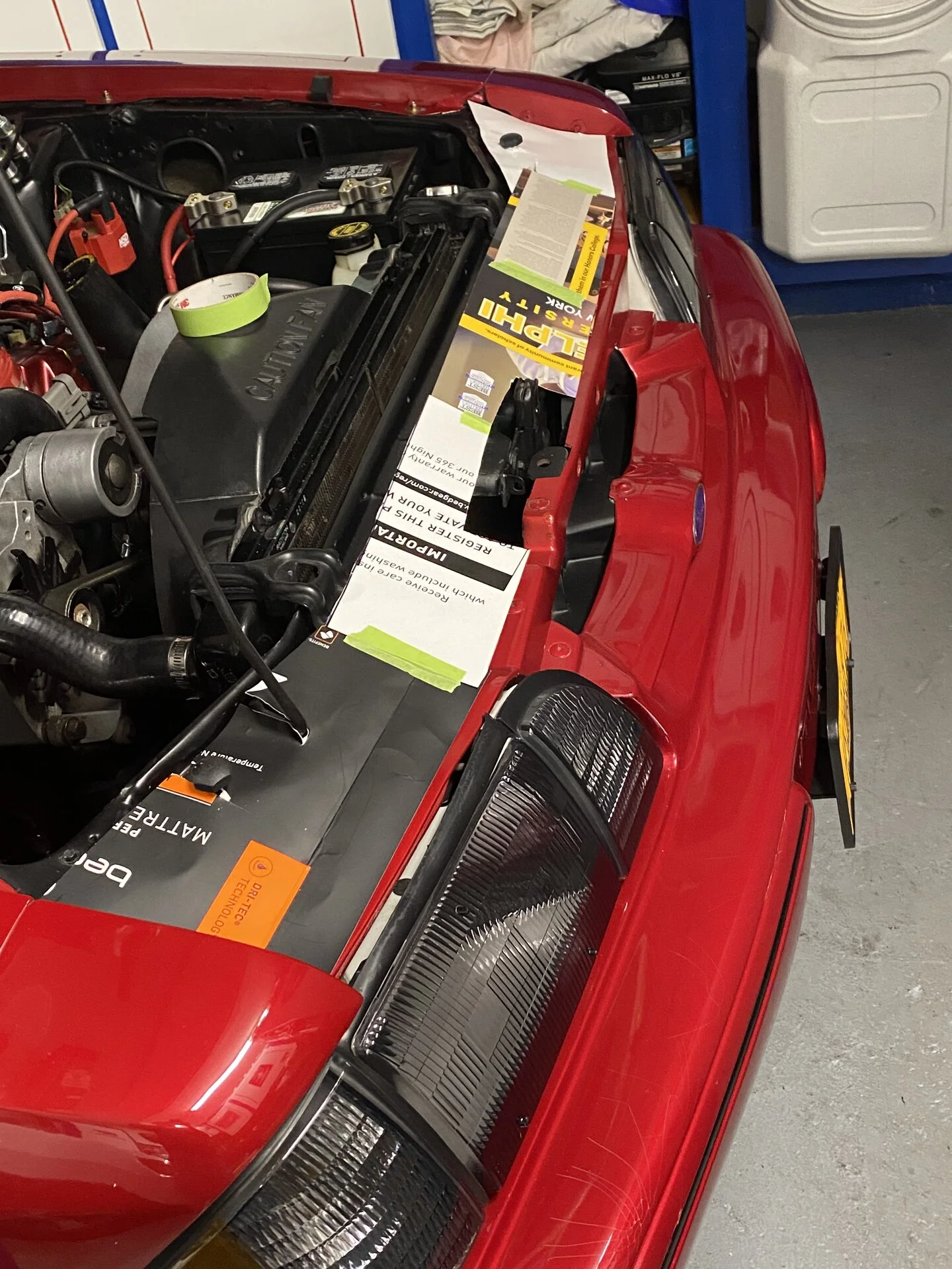

Hangin in the garage tonight...... ordered some sheets of black ABS.

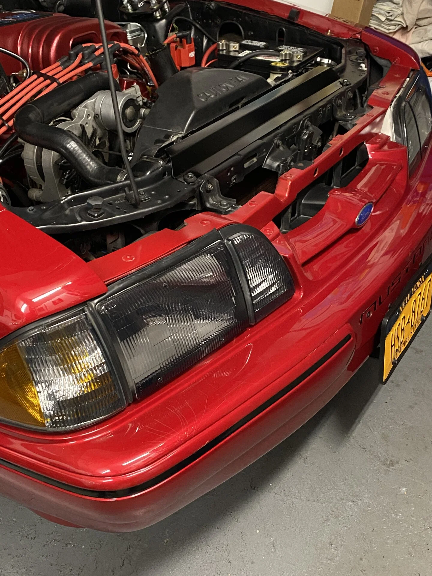

Started my template. I don’t know if it will work out, but I’m going to give it a try to cover the area between the nose and the radiator.
In my quest to get this cover done, I decided to buy the SVE radiator hold down first. That way I know exactly where I need to fill in. This will be a test to get it right and to what I’m happy with, but we’ll see how it goes.
This ABS plastic is proving to be harder than I anticipated to work with. I got my first piece cut out nice, but as I added the heat to make my bends, it started to warp in spots. I may give it another shot, but I’ll have to rethink about how I’m applying the heat.

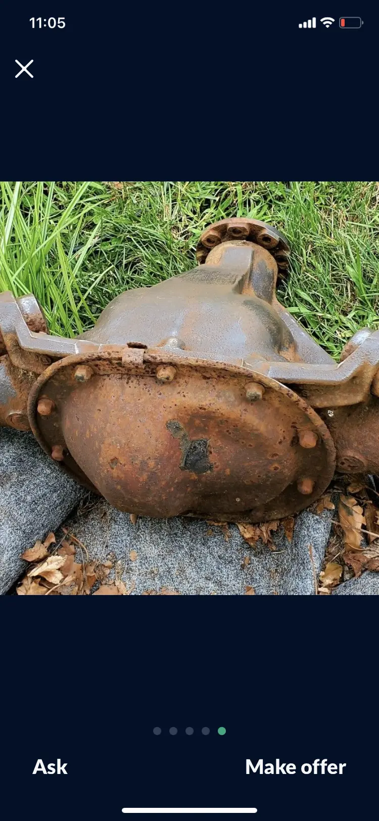

Hey guys........ not going to start a new thread...... just need confirmation on a question.
Guy is advertising this old rear end as an 8.8. It was cheap, so I figure this would be a cool winter project..... tear it down, clean, paint and rebuild, and sell it.
But I’m pretty sure this is a 7.5” by the rounded sides.
Can you guys confirm?
